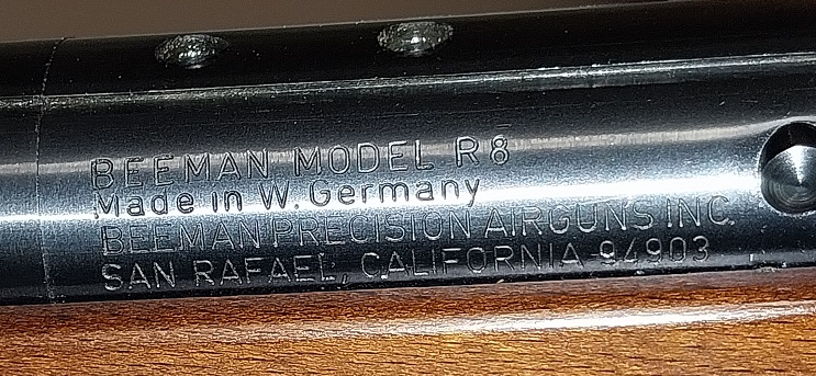

A bit of history on the R8 aka Original HW50. They had 25mm comp tubes and make around 9fps where the newer 50s models have a 26mm comp tube and make around 12fpe.

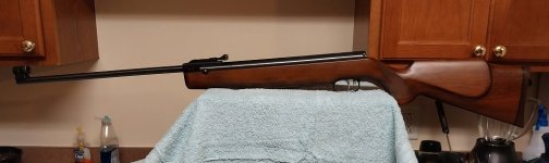

From another post on AGN, the R8 I just got from AOA and fits in very nicely with the 2 R7's (.177 and .20) the R9 (.20) and the R10 (.20) I also have:
