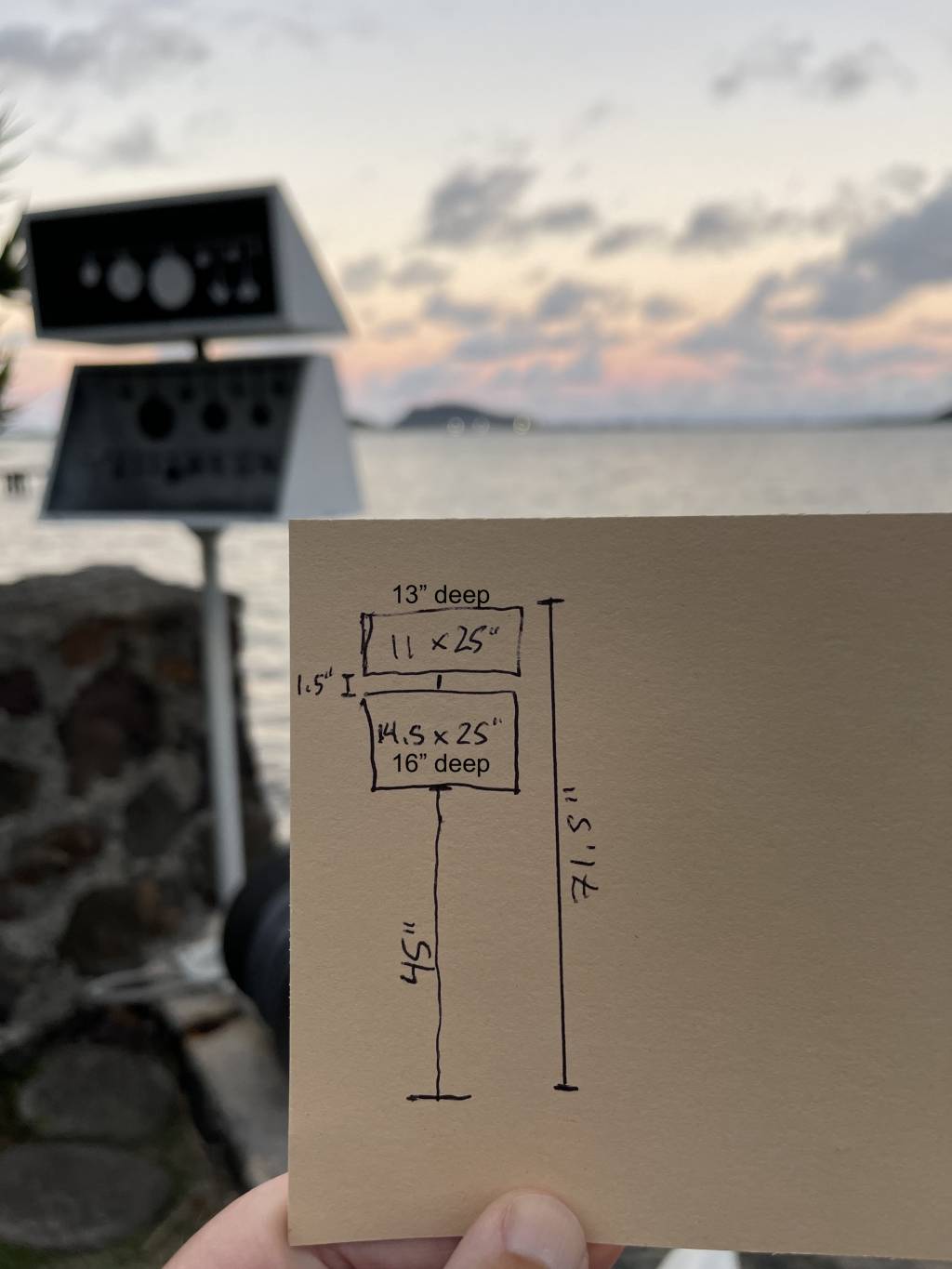

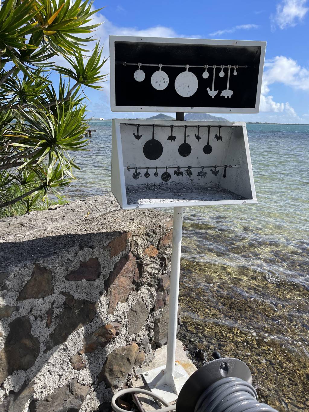

Is this what you are using now? What is the dimensions of the back wall on each box? If you have a local scrap yard is it possible you can get some 1" steel plate? mount it the same angle as the white target backing... 60degrees? it being so heavy I don't think it will make much noise. I have a 1 inch thick by 6 by 12 I shoot at sometimes with the 22 and it barely make much noise. But I guess that is subjective as what is considered noisy

Hi Guys,
Here's the current dimensions.

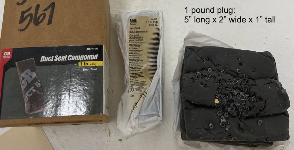

This is what I'm thinking:
A metal trap that's 26x26 lined with 2 layers of duct seal. If I did the math correct I would need 135 plugs / pounds of duct seal. I'm remedial in math so I could be off. Duct seal went up in price since I bought it last. I think it doubled. Home Depot has it for about $17 for only 5 pounds.

The amount of duct seal required has made me want to try to get my current set up less noisy.

The backs stop is angled and that does add an extra layer of noise because the pellet hits the backstop and then hits the bottom of the trap after being deflected. I put a strip of duct seal in the bottom to take care of the secondary noise.

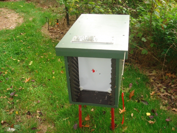

This is a topic I posted some years ago .
I like my guns to be as quiet as possible , so put all kinds of moderators , which helps a lot. But I realize that the main noise was coming of the pellet hitting the paper target. So I decided to build a wooden box ( 3/4 plywood ) with a removable top and a little plexi window to give the target some light.Dimensions are 20 inches long and the front face is the size of a A4 sheet of paper. The inside walls are covered with noise insulation foam , and the target is held on a metal frame with magnets, 4 inches inside the box. Just behind the target I put 3 inches of high density rubber foam, and some bags filled with sand to stop the pellet.
It works well, but I realize that some target paper are "louder" than others ; printing papers gives a kind of "twack" when hit , and drawing paper or soft cardboard seem to be quieter.Here is a pic of the box
I
I keep trying to improve it somewhat
