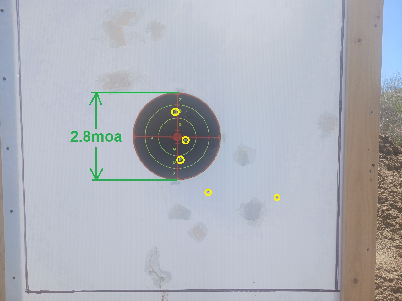

Since it was near impossible (even with my spotting scope) to see our hits/misses on the 360 yard target, we had to trust our dope. The 10pt center was about the same as a 1.5" field target at 50 yards, but getting the dope right is difficult for that distance, and no way to correct for the mostly unseen misses.
After I shot the 360 yard target, I asked the scorer to take a picture of it before they prepped it for the next shooter. I put yellow circles on the picture to indicate my impacts. 10pts for each shot that was inside the 2.8moa center. 5pts if on the white board.
