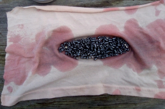

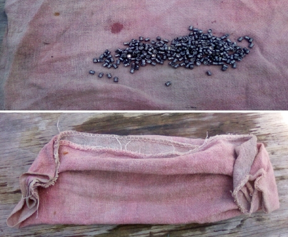

I never used to...recently just took some 3in1 oil and put it in a few select tins for testing. They seem a little easier to load[previously were a slight stuggle], and the ones that get used alot less seem to be more shelf stable too[less 'dirty']is all I can really tell.
I find that shoeshine buffing as said above dors well maybe best. Apply to center of rag and thin and even dunp in pellets fold hold both ends and use back and forth motion/ buff.. if you feel too much just do in dry rag to remove the excess.
I use a microfibre towel, using 'liquid' beeswax furniture polish getting the towel 'damp'. then do the same as you. Store the towel in a plastic ziplock to keep extra dirt off, can't say it helps BUT it most certainly doesn't hurt.
