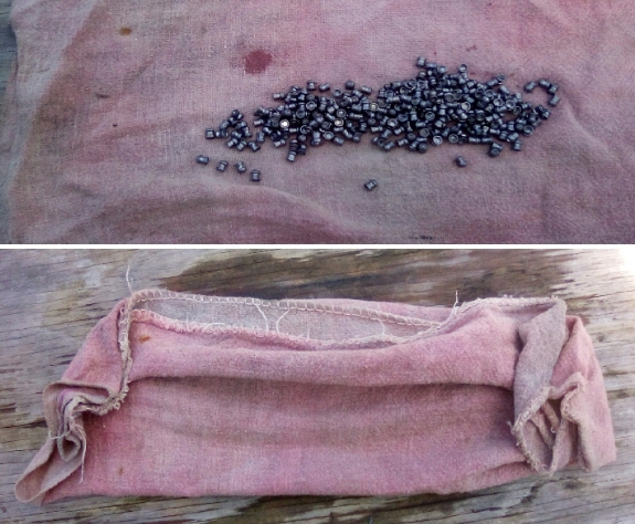

The flash point of beeswax is 400 F degrees. Does anyone know how much heat is generated by a pellet going down a barrel is? Of course its going to depend on how fast that pellet is traveling. So generally speaking, maybe less than 400 degrees at 900 fps?
PTFE, on the other hand, has a melting point of 327 Celsius (621F). I've tried the beeswax furniture spray and found that after about 1/2 tin of pellets, my groups started going to hell. I discovered that the barrel was extremely dirty. My theory is that the lead dust co-mingled with the wax and fouled the rifling. I switched to Finish Line Dry with Teflon bicycle chain lube and now my barrel stay cleaner longer than the beeswax. (Your mileage may vary)
Let me put it very simply, don't sweat it. I've used bees wax furniture polish (LIQUID) on my pellets with zero issues. I have better success with a 'dirty' barrel than one that is sparkly clean, but I'm using the FX soda straws so....YMMV. I recently conducted a limited test of putting Mobil 1 oil on the back of pellets to see if I could get them to Diesel. The answer was no. Caveat use of a lower flash point lubricant may cause it so...beware.
