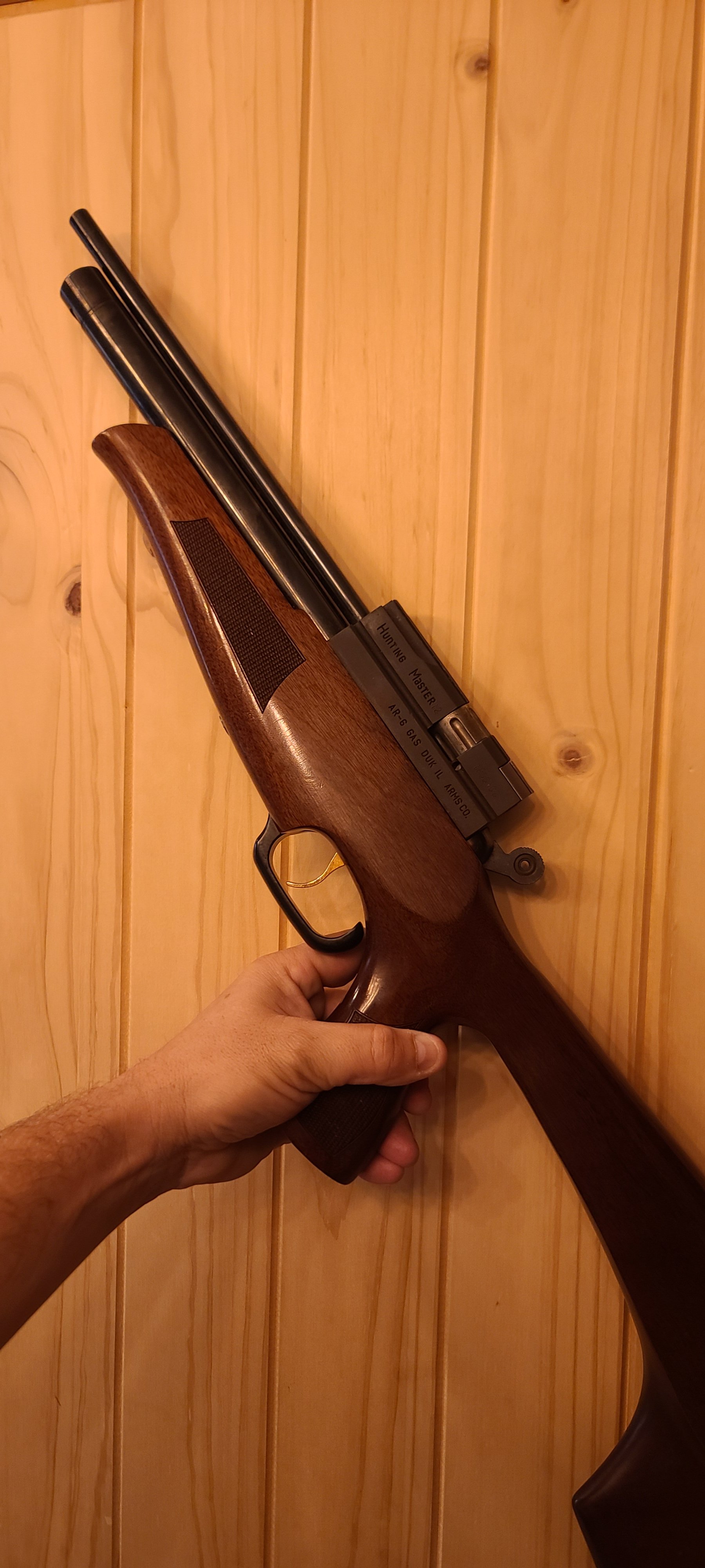

This is one of them, it was turned into a carbine, before i got it.
Mine was supersonic with 14.3, 38fpe, yours is pretty anemic then, the 2 i had both sounded lile a .22lr pistol
There is a small oblongish rubber washer surrounding the firing pin.
Remove that and 970FPS
I'm actually okay with the 550FPS with it in.
That seems like a clever way to tune the pistol.
Don't know if that is a normal part of the pistol or not.
Reactions: markhooper
It is not normal, someone had done thatto a buddie's, i ran into it coming apart and having to completely disassemble the action. It works, but i didnt like the after math and also had to talk him into using it as single action onlyalso, they like to break from too much double action usage. His was showing alot of ware. Excellent triggers on those guns though.
