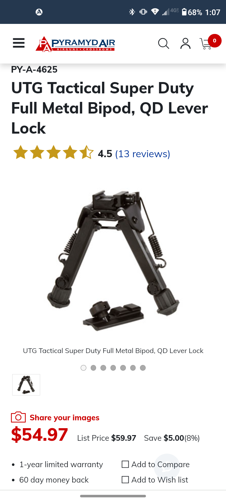

Does anyone know of a good arca rail to picatinny or weaver adapter mounts for bipods for airguns? I have a UTG bipod with a weaver or picatinny mount. I someone can point me to the right direction that would be nice.

I am assuming you want to attach to an Arca plate that is already on your gun. Which model UTG bipod do you have? I swapped out the Picatinny clamping plate that was held on the bipod legs by two screws, with an Arca clamp that cost me $15. With that attached, no adapter needed between the bipod and the gun plus I can switch it back to the original Picatinny clamp as needed.
That looks like the Picatinny clamp is attached from the bottom. Are there one or two screws holding it to the legs, or is it attached some other way? If there are two screws, it shouldn't be too difficult to fit an Arca plate to it. The screw spacing on my bipod was 30mm CTC.

View attachment 316126i believe mine is a one hole attachment.
