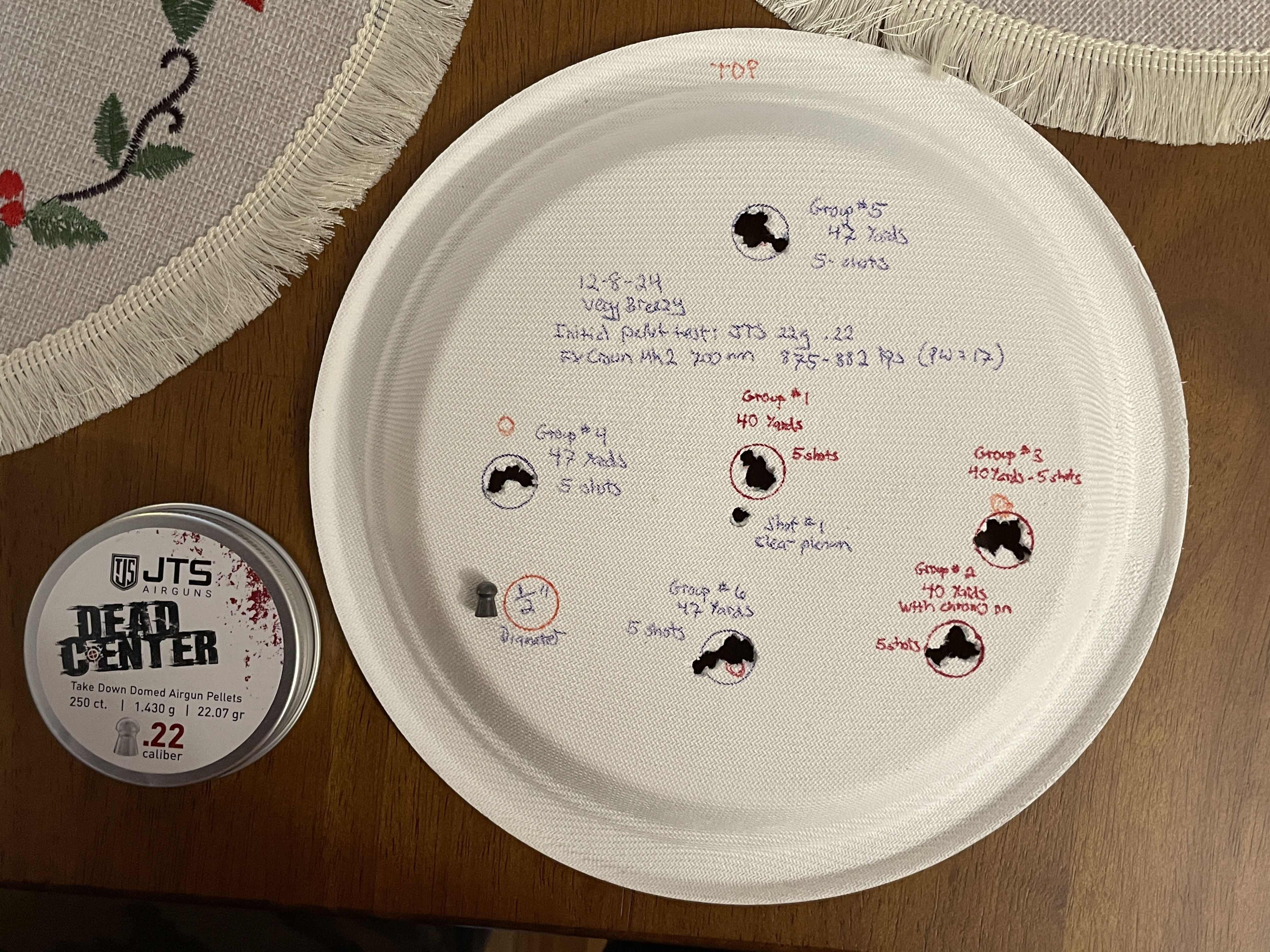

First 31 shots I ever took with the JTS 22.07g. Yesterday - breezy.
40 and 47 yards. 875-885fps with a 700mm Crown barrel.
I’m impressed with JTS so far.
-Ed
