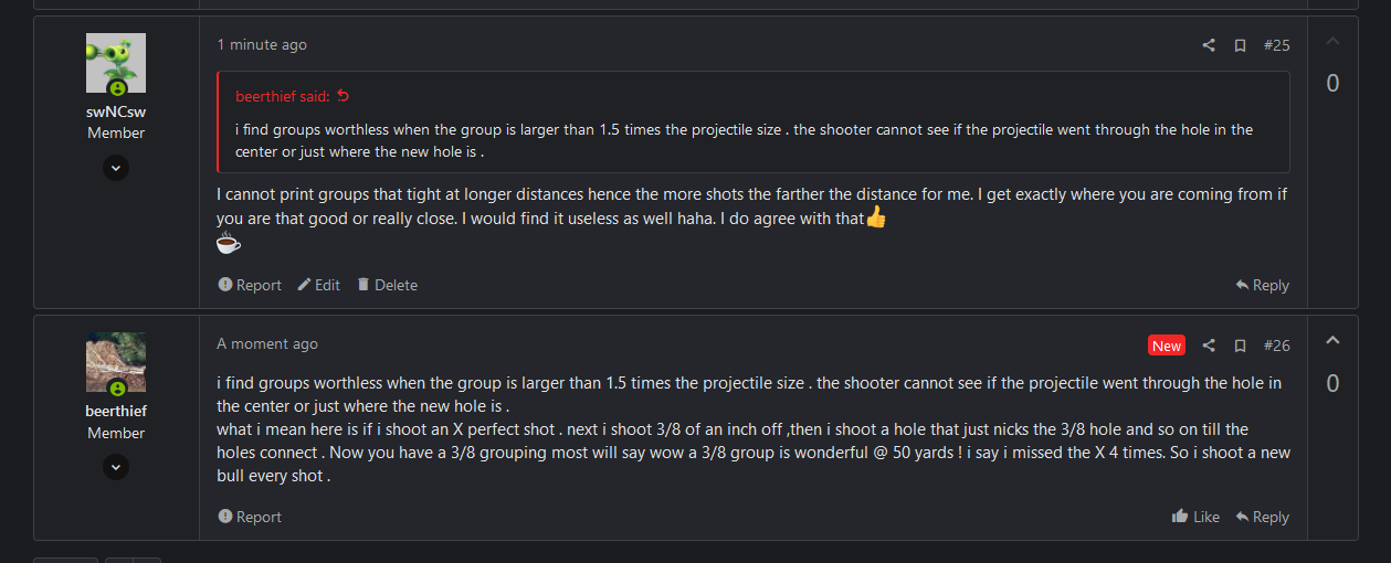

i find groups worthless when the group is larger than 1.5 times the projectile size . the shooter cannot see if the projectile went through the hole in the center or just where the new hole is .
I cannot print groups that tight at longer distances hence the more shots the farther the distance for me. I get exactly where you are coming from if you are that good or really close. I would find it useless as well haha. I do agree with that(y)
:coffee:
what i mean here is if i shoot an X perfect shot . next i shoot 3/8 of an inch off ,then i shoot a hole that just nicks the 3/8 hole and so on till the holes connect . Now you have a 3/8 grouping most will say wow a 3/8 group is wonderful @ 50 yards ! i say i missed the X 4 times. So i shoot a new bull every shot .
