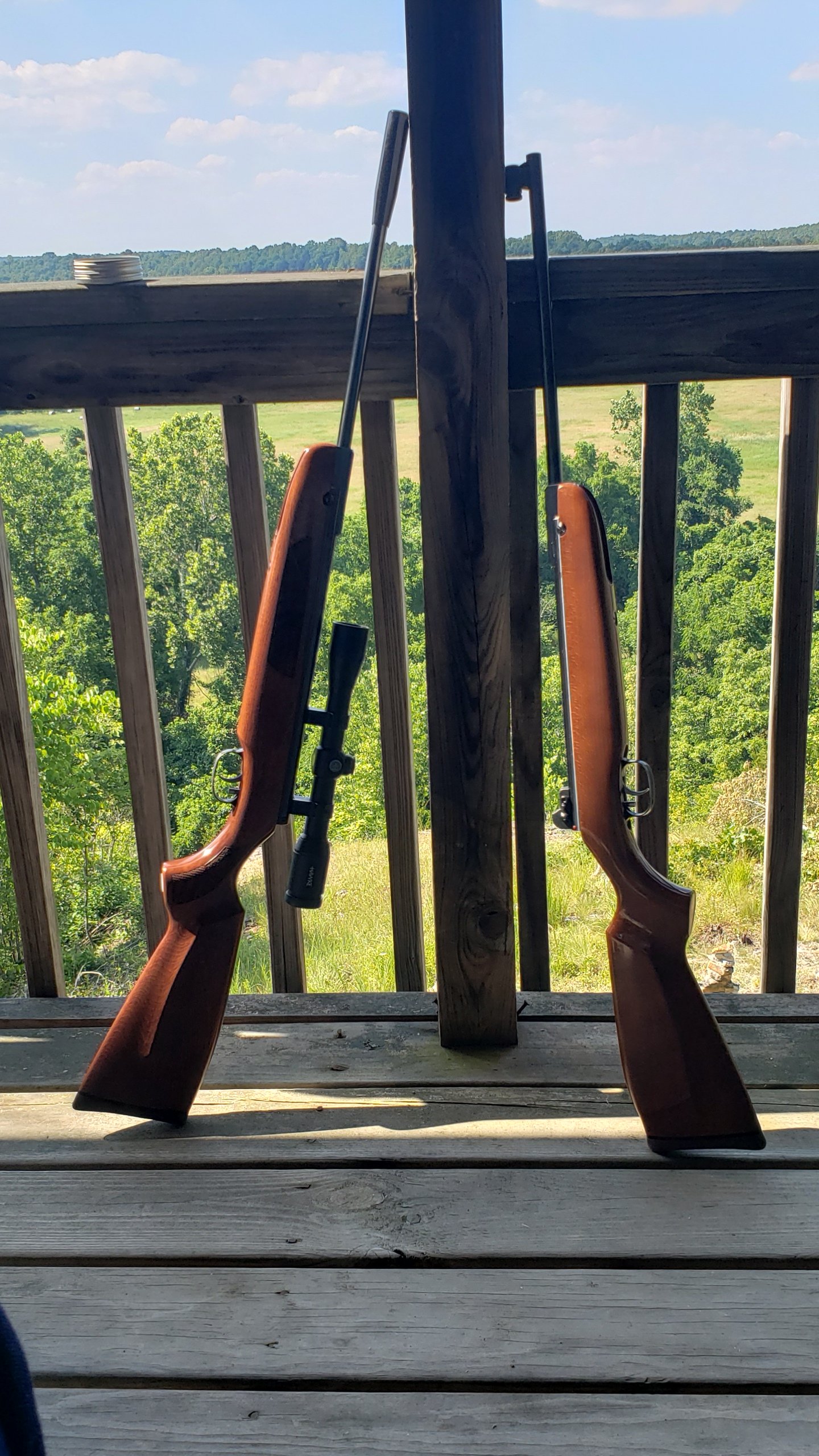

I like the non AO on my Hw50 a lot because I'll carry that gun into the woods and and I can clearly see any squirrel within the range of the gun. Well other than inside ten, eleven yards but how often do you get that close to a wild squirrel? It helps keep the gun light and well balanced. The whole package only weighs 7.2 lbs. Even when plinking at local airgun range I can shoot anything from ten to a hundred yards without making a single adjustment. It works out well for what I use that gun for.
