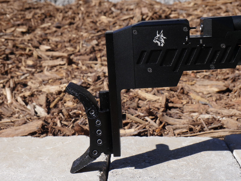

I found an adjustable butt on Thingaverse. Dew up a mounting plate for my Prophet Performance using FeeCad3D. Printed it in PETG at a fairly high infill percentage, ~40%. Works great especially on a short butt plate like the one on the Prophet. Has not broken.
