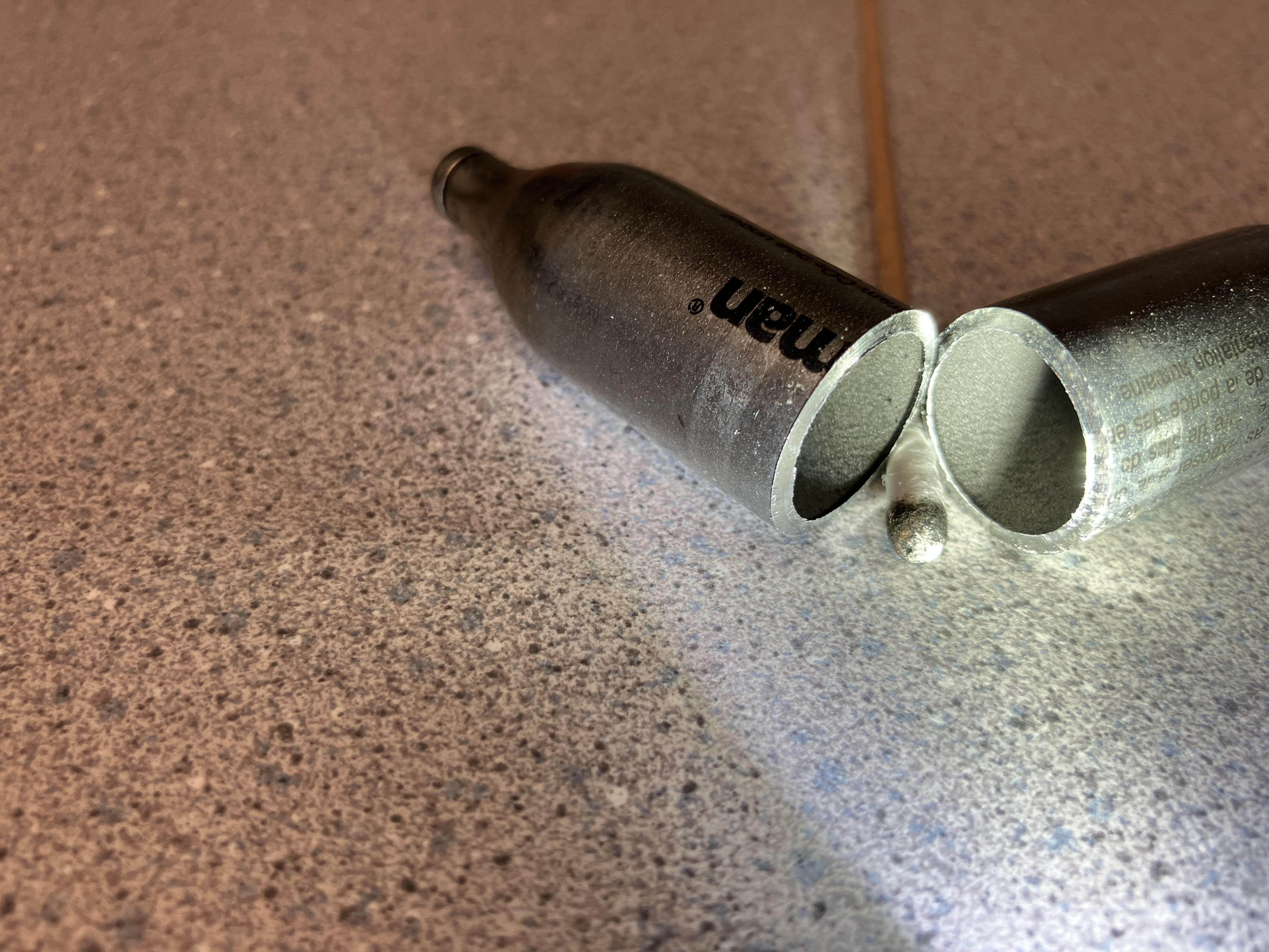

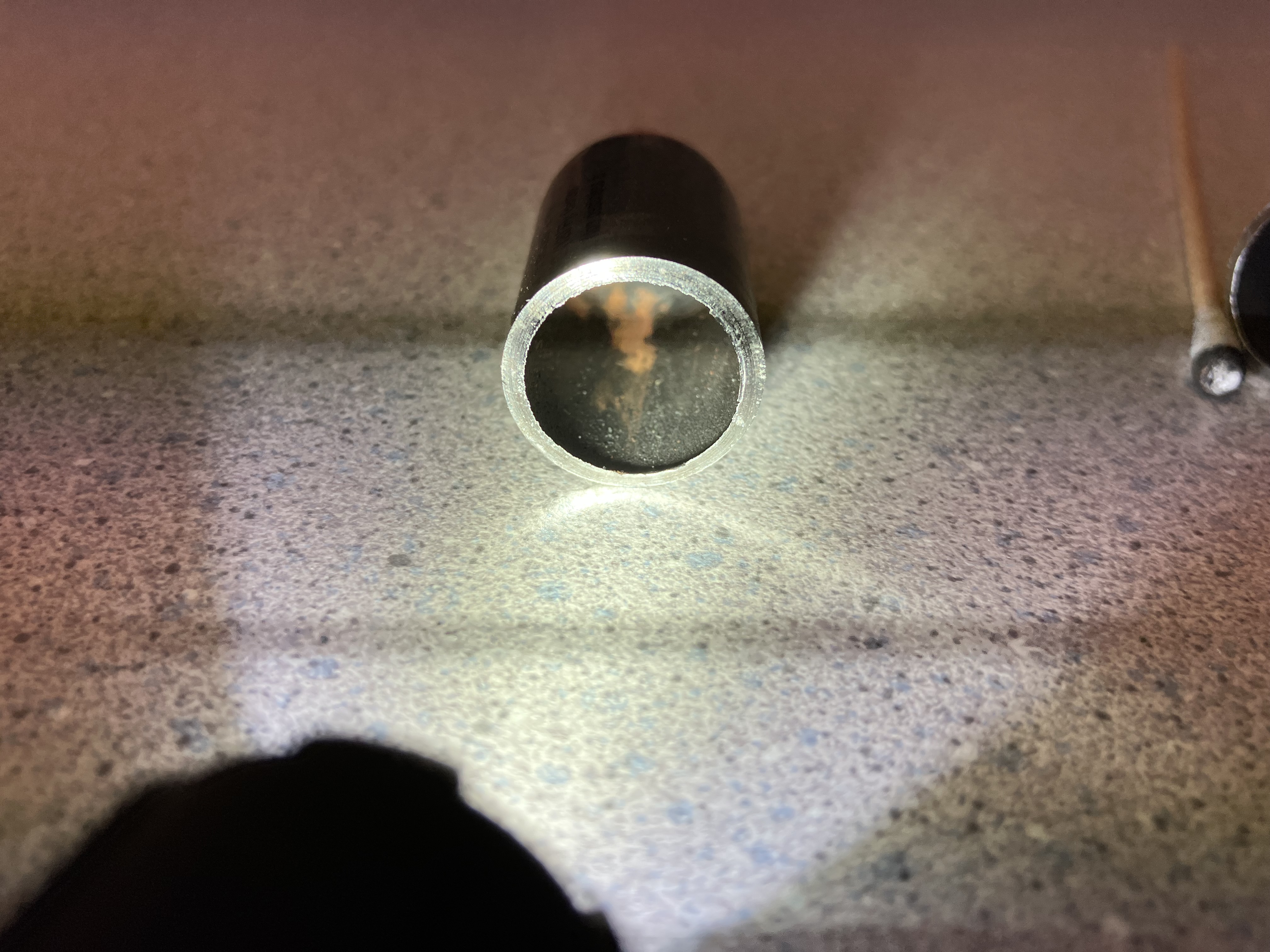

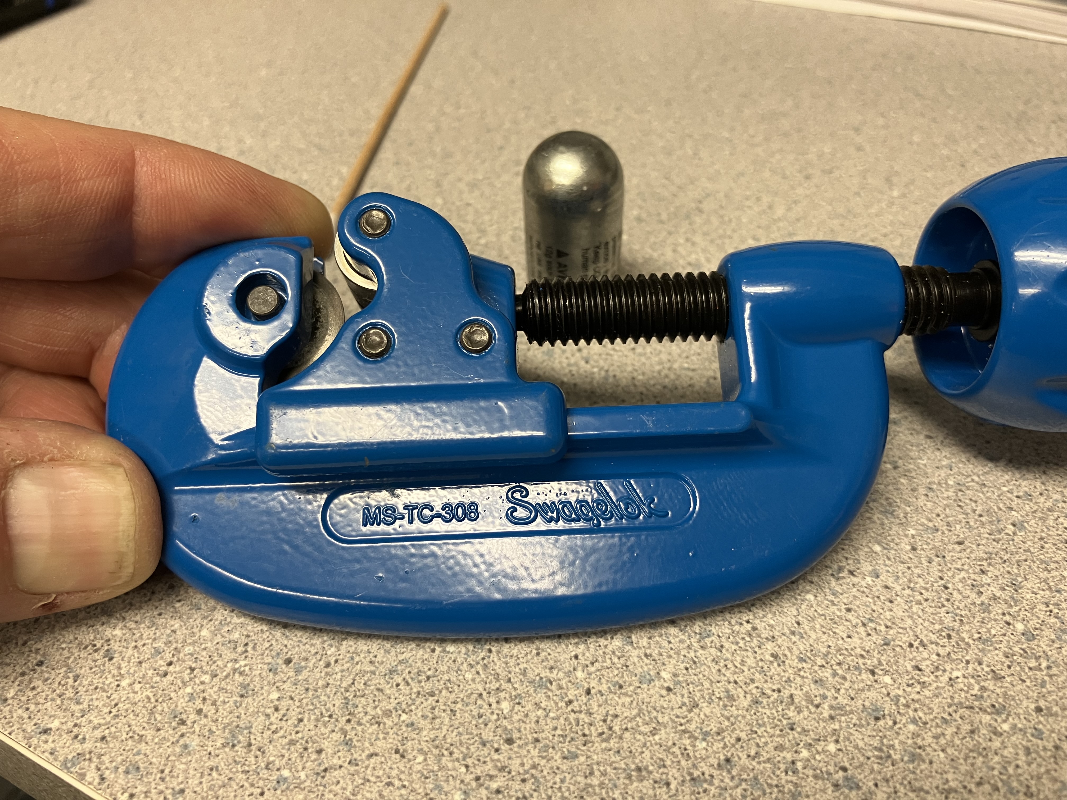

Were the Co2 cartridges already used, for example used and then left empty for a time so the rust could form on the inside? The cartridges I opened were just expended then cut open. I ask because cartridges that are left lying around or used in a container will rust on the inside is a short period of time.Opened up 2 Crosman CO2 cartridges with a plumbing pipe cutter (no chips).
Both were clean inside with zero particulate of any kind. One had a small rust spot most likely process water from manufacturing.
I swabbed both interiors pretty thoroughly with a wooden sticked swab and as shown in photo, the swab was black. It felt like lubricant from the drawing process.
Less than an hour.Were the Co2 cartridges already used, for example used and then left empty for a time so the rust could form on the inside? The cartridges I opened were just expended then cut open. I ask because cartridges that are left lying around or used in a container will rust on the inside is a short period of time.
