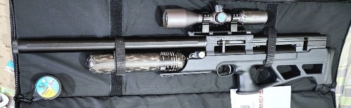

Again advised a user to buy VULCAN 3 in .22 with unchoked 700mm barrel for shooting slugs.
The gun came and we tested it. It's as accurate with .218 slugs as it can be.
But another issue popped up.

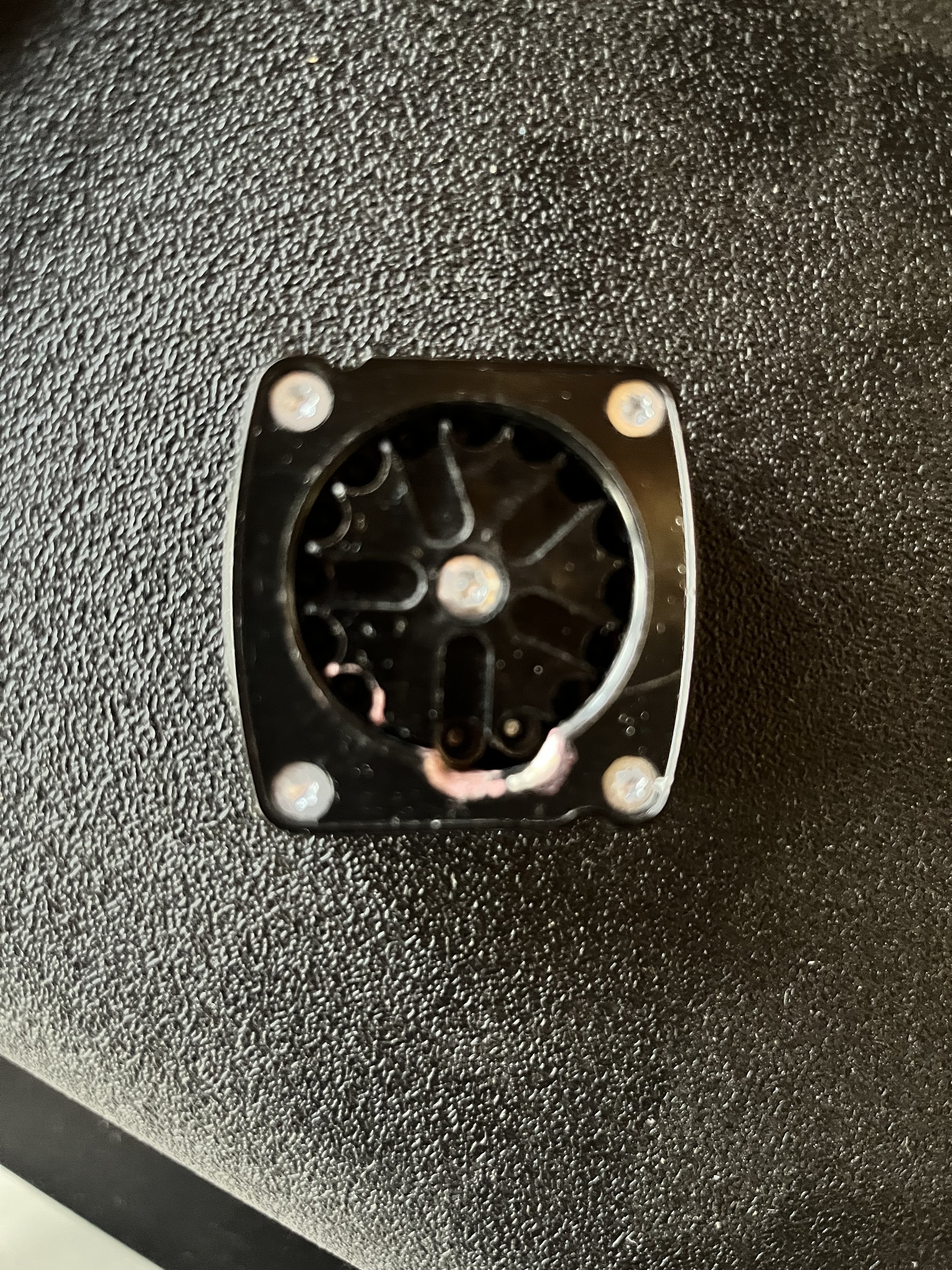

When the user pull the cocking lever back to cock the gun, the next slug that comes inline with the breach, falls down into the cavity where there is the pellet probe. The cocking lever and probe gets jammed.
When we keep the gun completely horizontal while cocking or keep the barrel down words then everything is fine.
This is to the extent that even if the barrel is slightly upwards, the slug drops and get jammed.
I disassembled one of the magazines and increased the spring tension but of no use.
I also wrote to ATG.
The main punch of their reply is as following,
"We recommend keeping the barrel parallel to the ground. Sorry, but we cannot offer any other option. Thanks for understanding".
So now I am trying to understand. Anyone can help please?

The AGT Vulcan magazines have a 2 slot opening, so when you have the one slot engaged / chambered and ready to go, the next shot sit right there in the #2 that have no back stop, so it can potentially just slide right out the back.

My friend Steve from AVS slugs and myself have had the Vulcan 3 in both 22 and 30 cal as well as the epic 2 in 25 cal. Steve always uses slugs in the bigger diameter / longer catagory that the gun and barrel can accomodate. In doing so, we never experienced this issue. We did have this problem with another brand , not sure which, so I don't wish to guess. The issue involved space between the mag and the breech where it allowed the slug to "tumble" while being seated, and jamming potentially if one did not completely cock and cycle the gun in a complete and smooth manner.

Try one thing please. Keep the magazine upside down and then push the slug upwards with allenkey.
When I did it holding the magazine in my hands, two slugs dropped down as I pulled down the allenkey.
There may be some factor of length of slug or dia involved.
When complete magazine filled and held downwards without pushing the slugs as you have done, no slug dropped in my case too.
