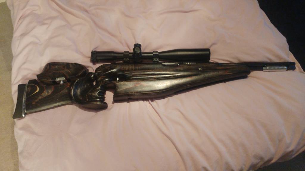

My tx200 is in a custom stock and it is reasonably heavy. I have tuned it as well and get minimal sight picture movement. Still get some though.
Here in the UK, unless you have a firearms certificate, you have to stick with a sub 12 ft lbs rifle which also cuts down recoil. I have tried various combinations of tuning and currently have it short stroked to a mk2 cocking stroke with a few other bits done. Shoots at 11.3 ft lbs

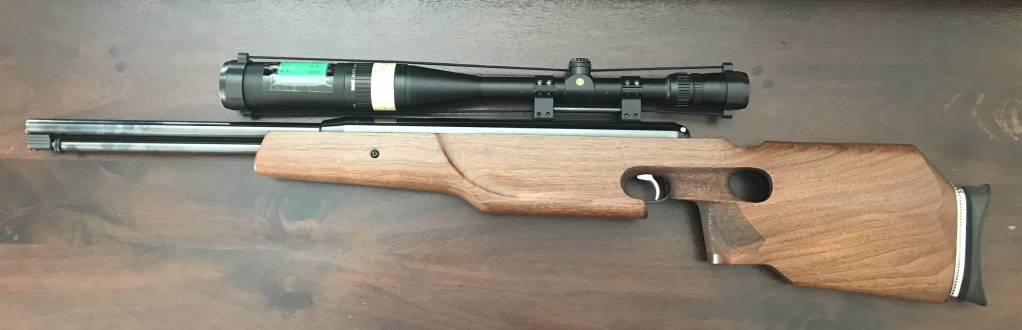

Ill go back to bedding here... I’ve looked into it a bit online and have some experience. I’m going to say a firm pillar bedding with a solid stock is optimal. Many people swear by “soft bedding” springers but I’m not one. I recently prepped a stock to be glass bedded with devcon 10110 but had to shoot it before I was done. With minimal stock to tube contact I was actually getting better accuracy then before. Im probably not going to go through with the glass bedding now. Or at least not how I originally intended on doing it.
