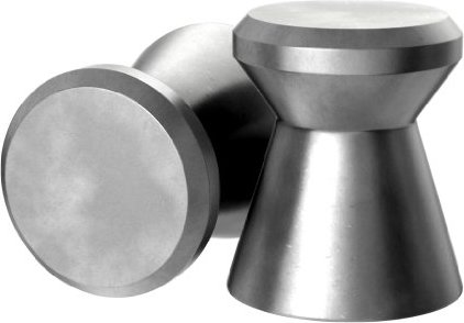

I will say though that wadcutters are devastating out to a limited range say... 20 yards or so.
If you're in a barn shooting pigeons or rats at close ranges give wadcutters a try 👍

Words of wisdom,right Here! If I'm pesting or hunting at an average distance of sub-25 yds, the lowly wadcutter is going to be a Top choice followed closely by an Extremely effective dome pellet.

Another vote for wadcutters for pest control. Squirrels, collared doves, chipmunks, rabbits, etc. Just not larger critters like a raccoon where penetration is needed to punch through the skull.
Wadcutters deliver a noticeably more devastating impact than a dome launched at the same speed, despite the fact the wadcutter is moving slower by the time it reaches the target.
Of course as Matt and Mike have stated, the “sufficiently accurate at a distance” is a caveat they share with hollow points. The advantage, however, is that they don’t need to expand. Their geometry is already favorable to maximize tissue damage. The fact they don’t penetrate well is proof positive of it. A wadcutter that does not pass through has dissipated all its energy into the animal. Where does all the energy go? That’s right, tissue damage.

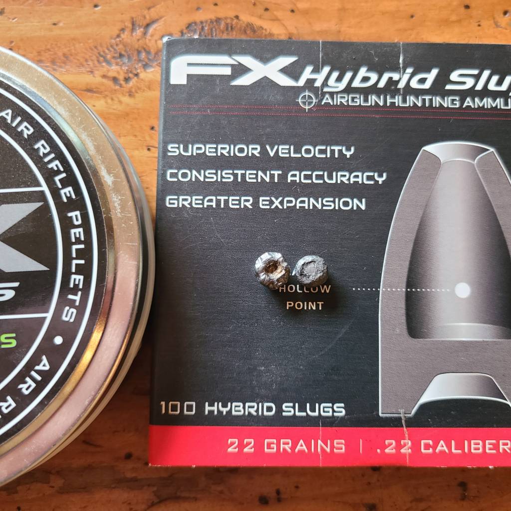

I thought it was clear that more powerful airguns will have great expansion while using slugs. Heres
 a picture of two different projectiles. On the left is a 22gr. .22 fx hybrid slugs, or the right is a fx 18.1 gr pellet. Both shot out of a Hw100/STB, regulator set 140 bar. Both hit a conveyor belt backstop, target was at 78 yards. Now a conveyor belt is alot tougher than the skin of a ground squirrel or ground hog. It is plain to see the slug expansion is larger than the expansion of the pellet, probably due to the better BC of the slug allowing for more retained energy. The slug expanded to 7.47 mm, the pellet expanded to 6.86 mm., not much difference, .61 mm.. IMO that's not expansion difference however the retained energy of the slug would transfer the energy where it would create more hydrostatic shock ie killing energy.
But is it needed for small game shot at a reasonable range. I like the wadcutters for out to 20 yards on mice, rats . All the energy is being transfer. Hollow point won't even start to expand, diabolo would do the same as HP.
