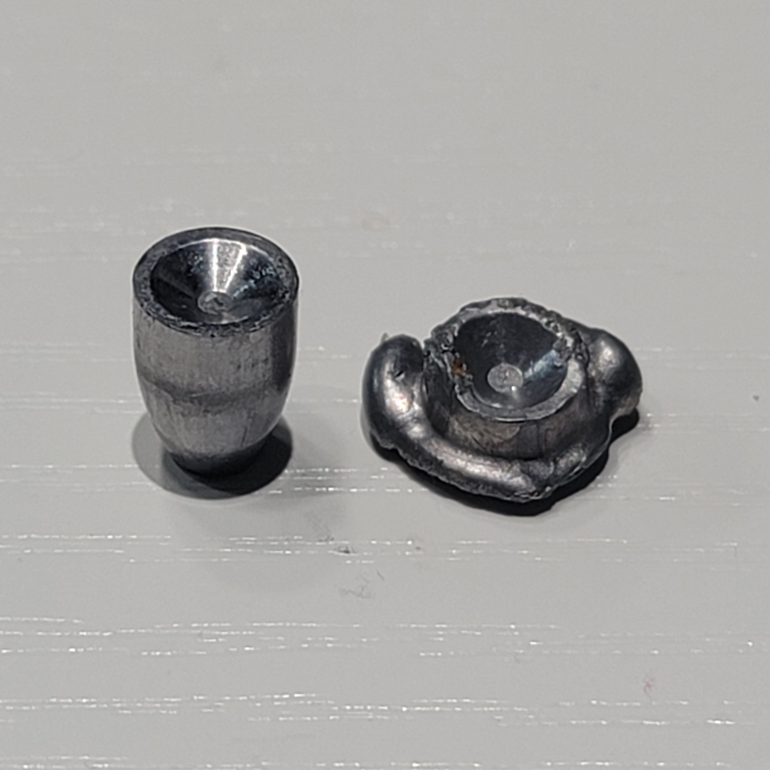

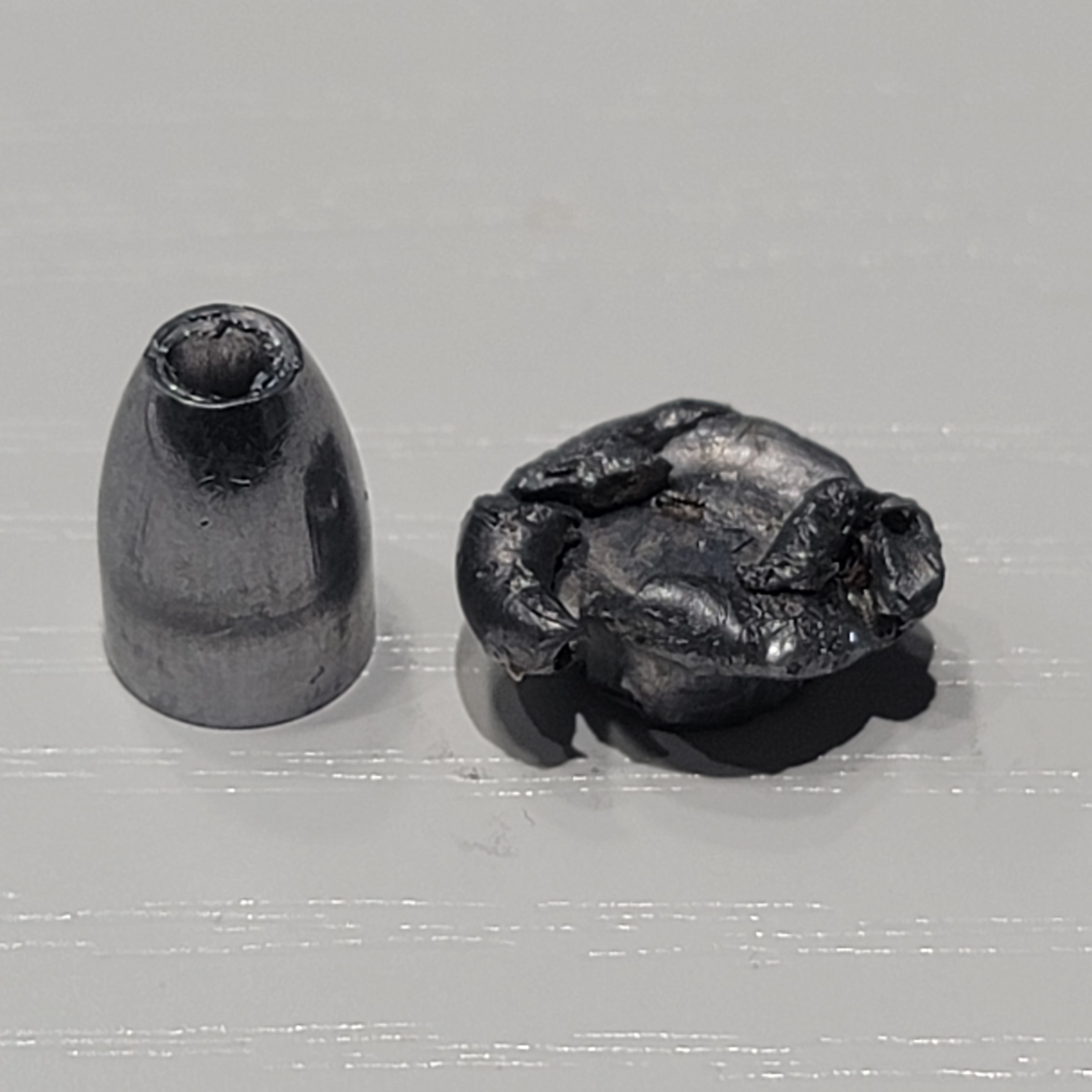

I've posted this photo plenty, but it's always worth posting whenever the .30 cal FX Hybrid Slugs expansion question comes up. Here is the expansion after a full passthrough on a groundhog bodyshot at 60 yards from an FX Maverick VP shooting them at 930fps. You can see a video of the shot here. She was dead before she hit the dirt.

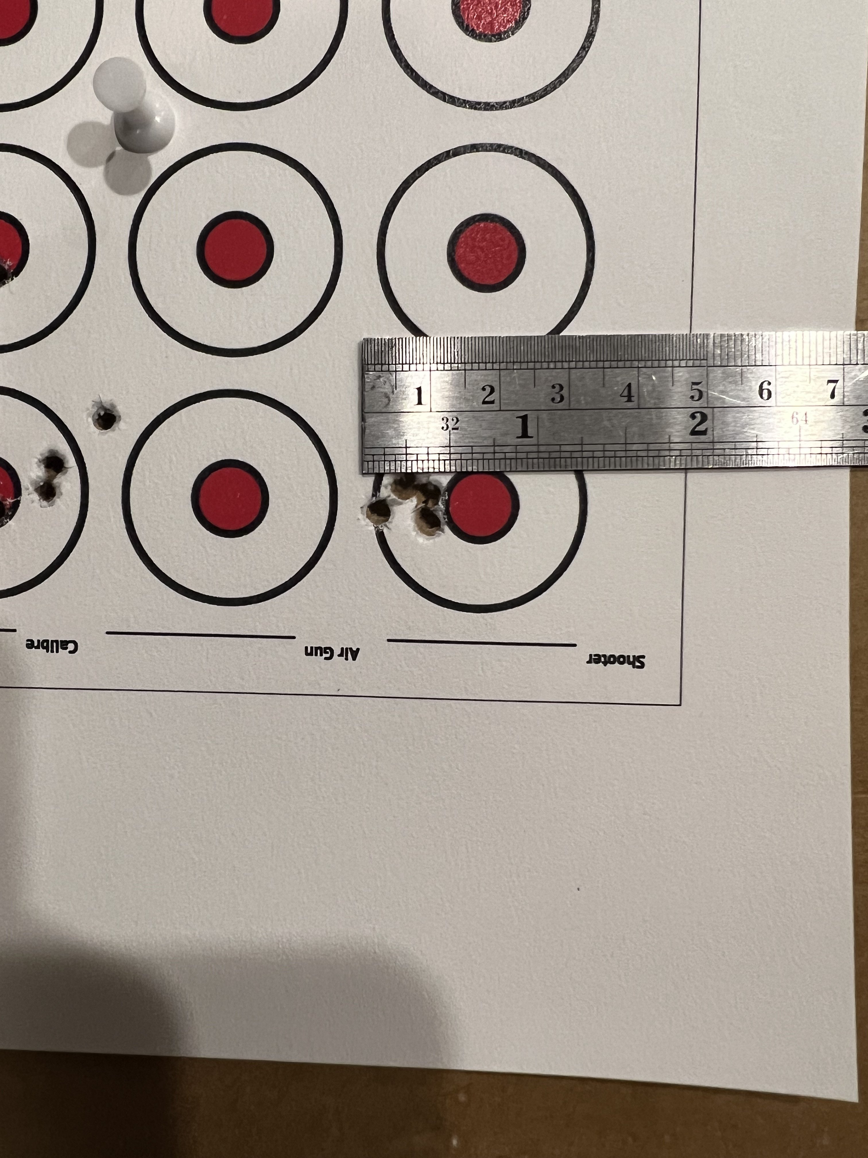

I can tell you that the RMR slugs (.2170) are slightly different from the FX, they are a touch longer, ok, more than a touch about .070", sizes are insanely close .00005", weights are within a small fraction of a grain, it's an either or, they were one weight or the other, nothing in between after 25 pcs. They do cost less than FX and I believe they shoot better. Now why I say that. I can't get them to work in my Maverick. BUT...I've got a Sapsan and somewhere along the line the barrel got messed up, 18.13gr pellet are like shooting 00 buck, all over the place, put these 22gr RMR's in, crank up the speed to 955 (maxed out) and.....the pic shows what I got at 30 yards, 10 rounds. YMMV They aren't something that I'm going to be shooting 100/day, not at that price. Note, I have zero idea what the twist rate on my barrel is, that's my next project to figure out.

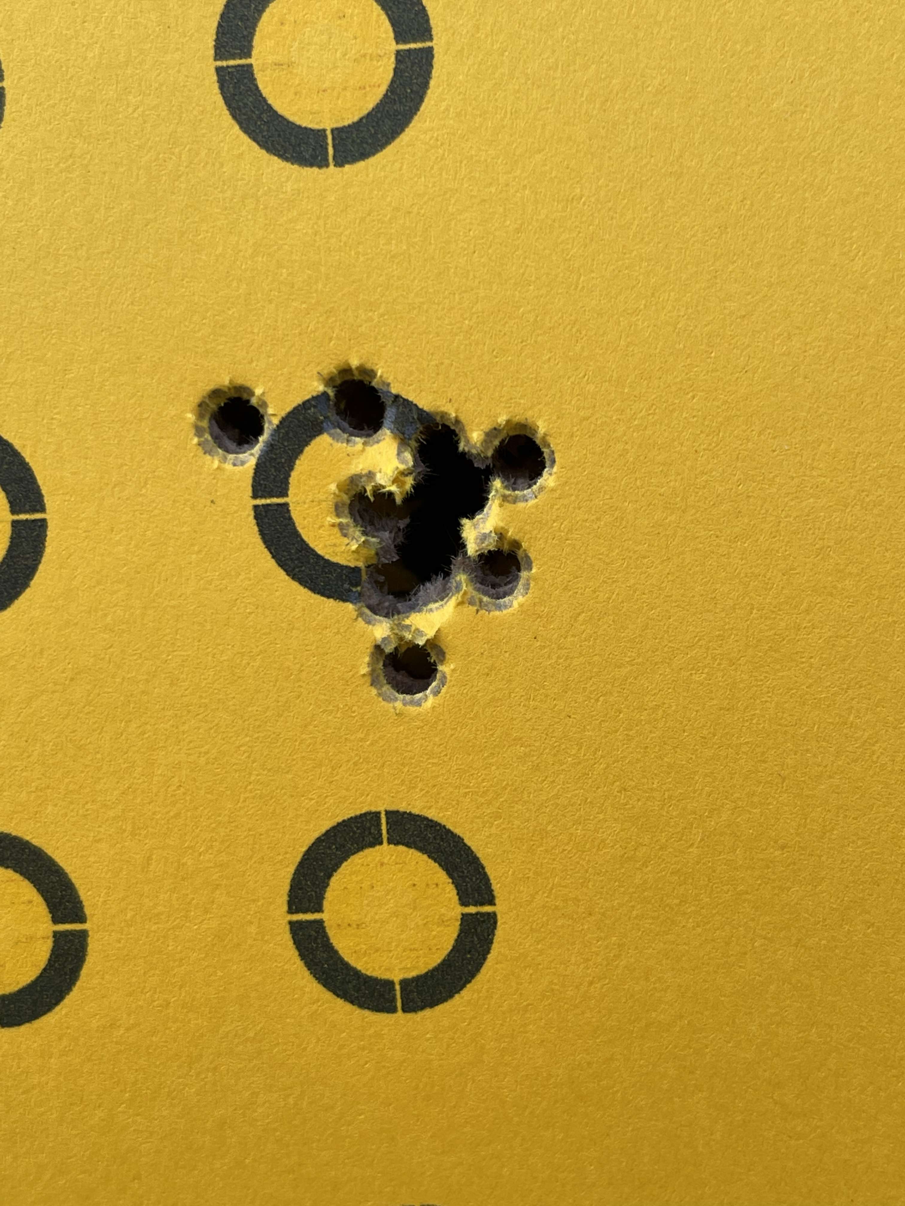

I'm going to have to bite my tongue just a bit. Earlier in this thread I bashed the Hybrids because I felt they didn't outperform other slugs in accuracy at a much higher price point. Fast forward to now and they are now officially my most accurate slug.
With my 700mm CZ barrel on my .22 Taipan Long pushing them to 955 fps...1/2" groups at 50 meters are common with some coming in under 3/8". It took me a while to find the speed they liked...tried a variety of speeds from 885-1,000 fps and nothing was terrible but 955 seems to be the magic speed for my barrel. I took out a pigeon at 118 meters this morning...have to see how they do in the wind.
My next most accurate slug has been the NSA 24.8's at 950 fps...at 50 meters they would give me occasional 1/2" groups with 5/8" being more common...this was with all of the .216-.2175" sizes...

Holy smokes, nice shooting! I was curious about wind drift as well: I figured they wouldn't have a spectacular BC and would suffer more drift than traditional slugs. I would love to see some more formal testing

Groups like that only happen when everything comes together...I was previously shooting the NSA 24.8 at 49 fpe and the lighter Hybrid's are at 44 fpe. These two slugs are very comparable...they have the same estimated BC at .080, the NSA is slightly shorter despite being almost 3 grains heavier.
My hypothesis is that the reason the Hybrid's do so well from my barrel is that my 700mm CZ barrel has a noticeable choke. The hollow cavity design of the Hybrid just might allow the projectile to conform more easily with the choke than a solid slug. I don't want to discount the NSA's...I need to experiment with velocities some more. One thing for sure is that .216" and .2165" slug diameters were definitely more accurate from my barrel.

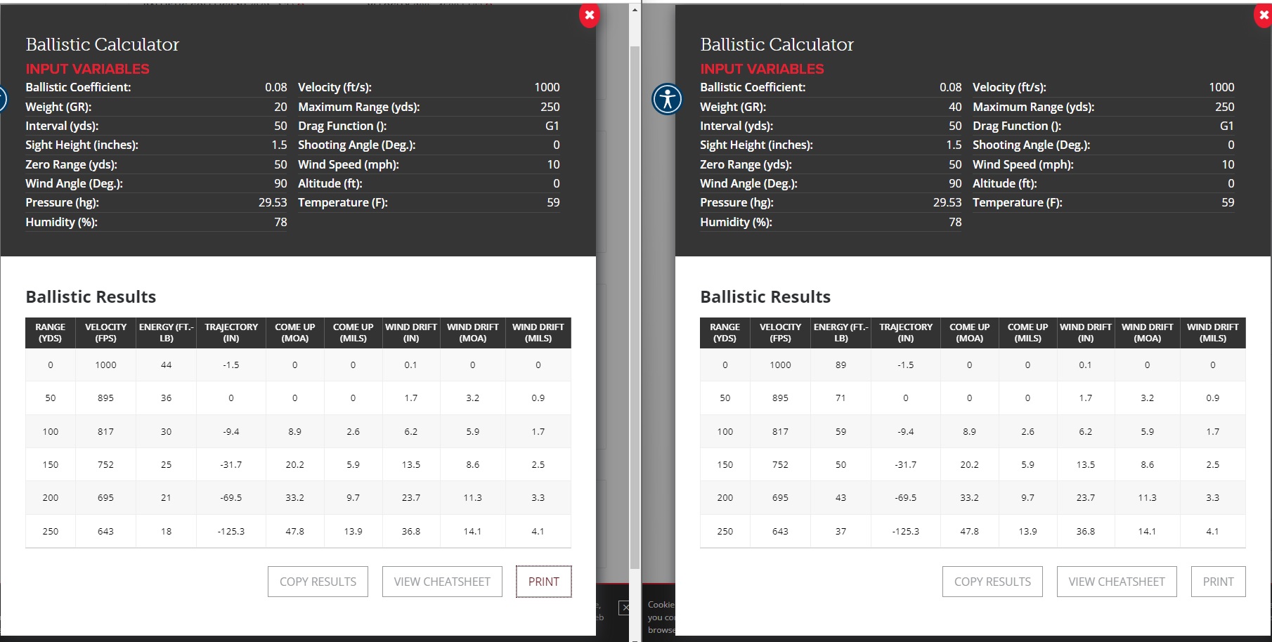

Physics tells me that the 22 grain Hybrid will not do as well in the wind as the 24.8 grain NSA; especially further downrange... Mass, inertia, and momentum...
BC plays the most prominent role in wind drift. Weight, mass, inertia and momentum don't have much effect, although they do help with energy. This bent my mind initially but I have come to accept it. See attached ballistic calculator chart for evidence:
