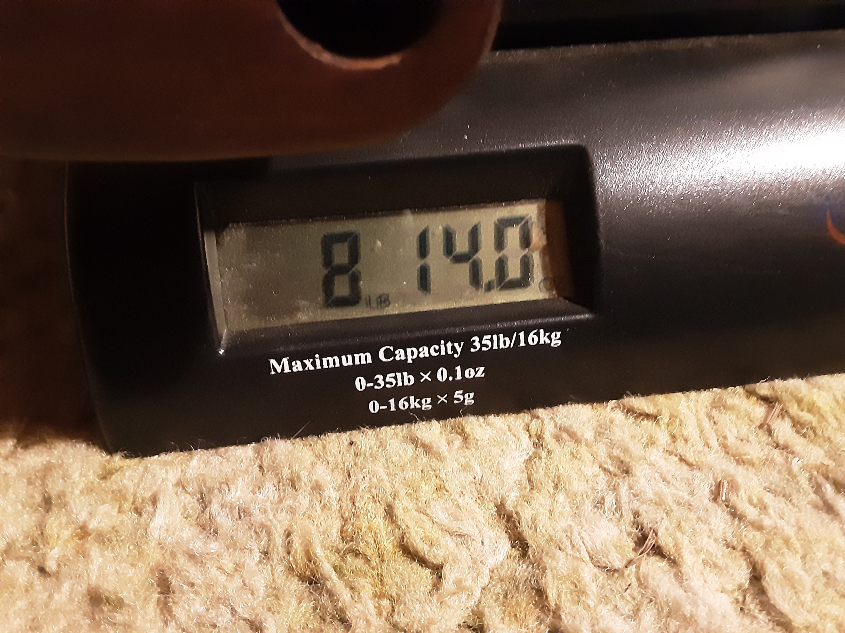

I have found out that my Vet likes most JSB pellets. Its no surprise since their both from the Czech Republic. It shoots the 18-25g jsb excellent. I tried Some H&N like the 14.6 ftt did ok but not much luck with the 21g baracudas. It didn't like the airboss 18g , my Maverick does great with them. Tried some FX hybrids and they were too tight when loading . It shoots Hades well after I turned down the velocity. Does well with CHPs inside 30 yards.

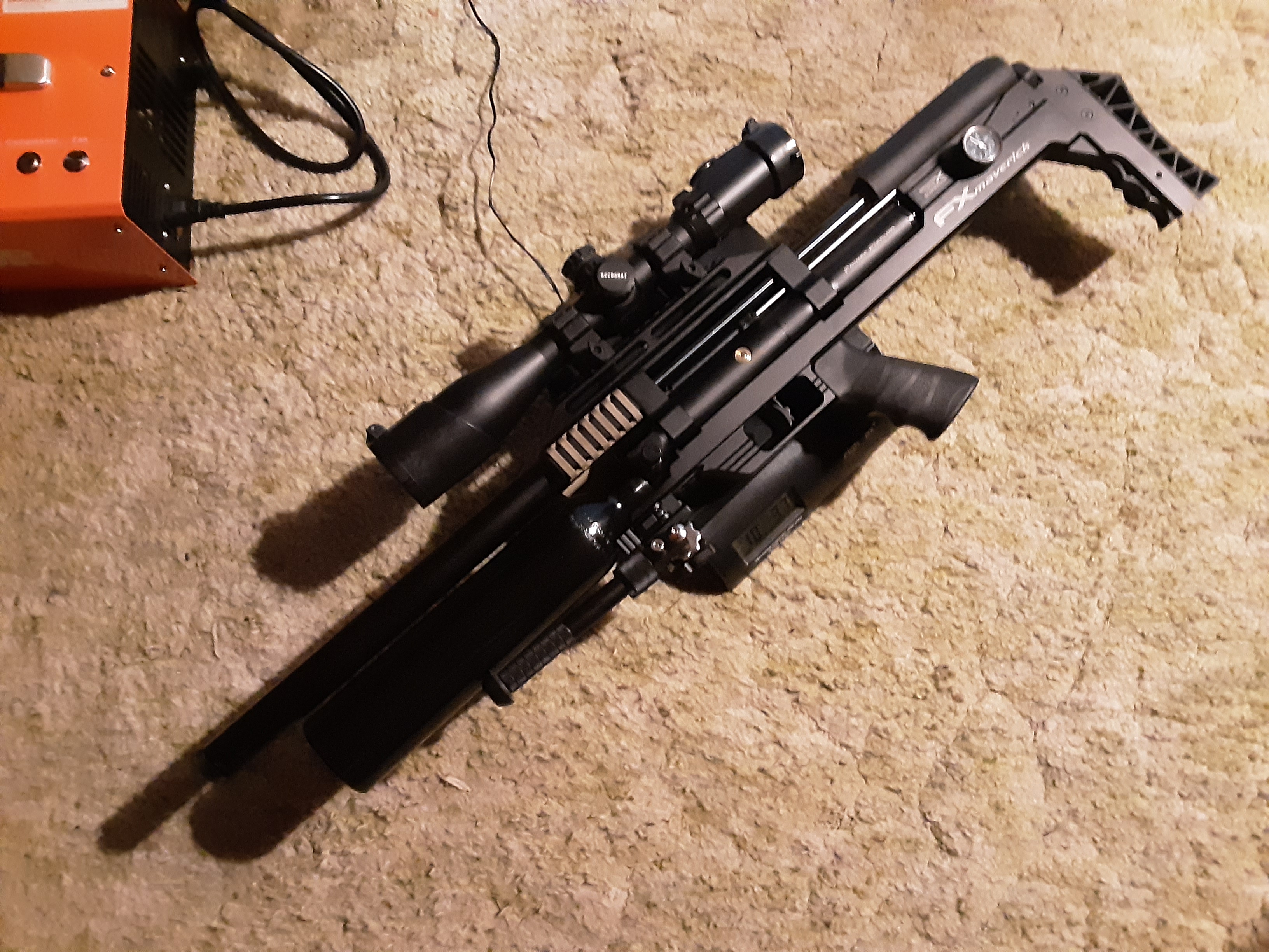

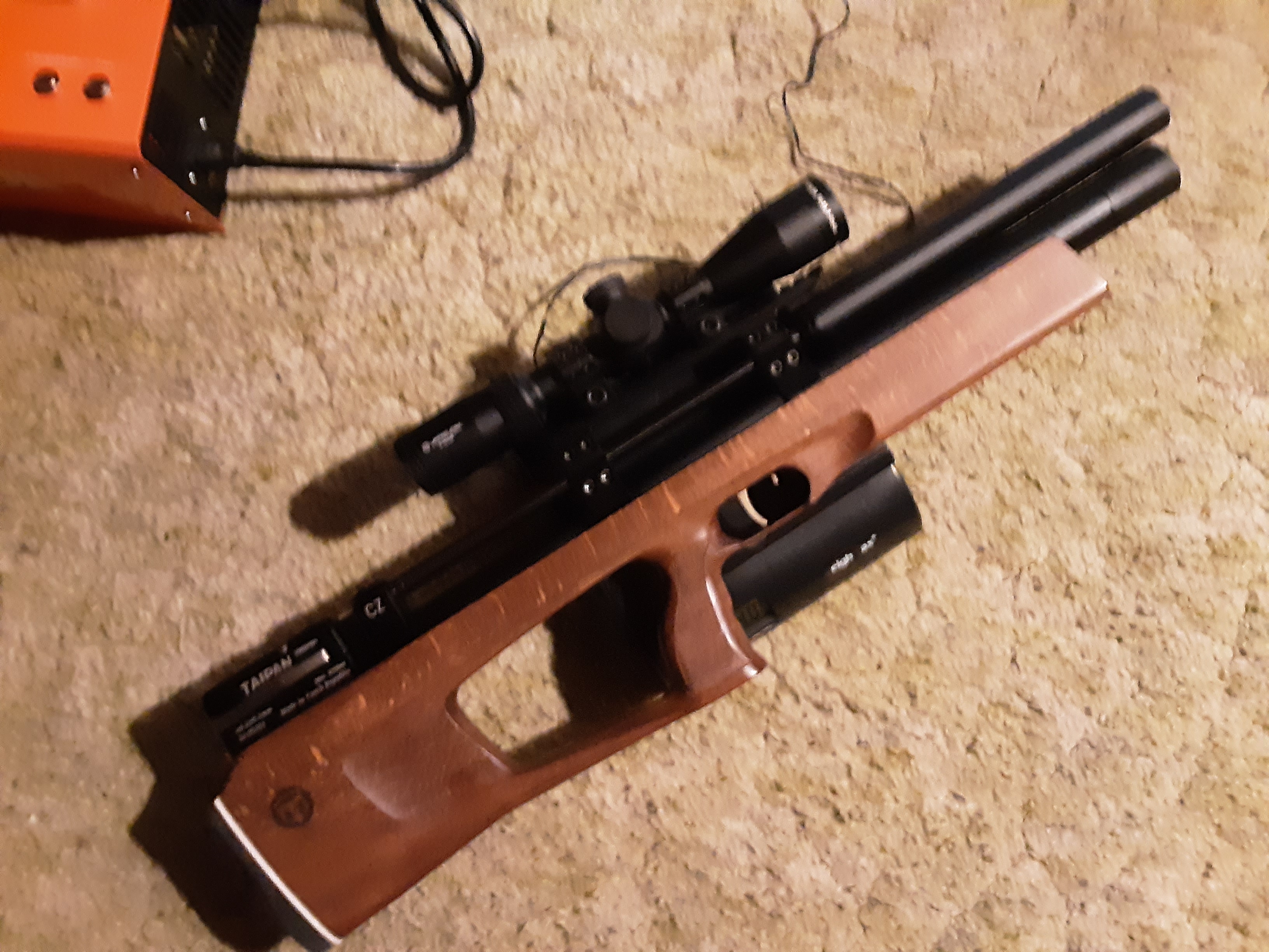

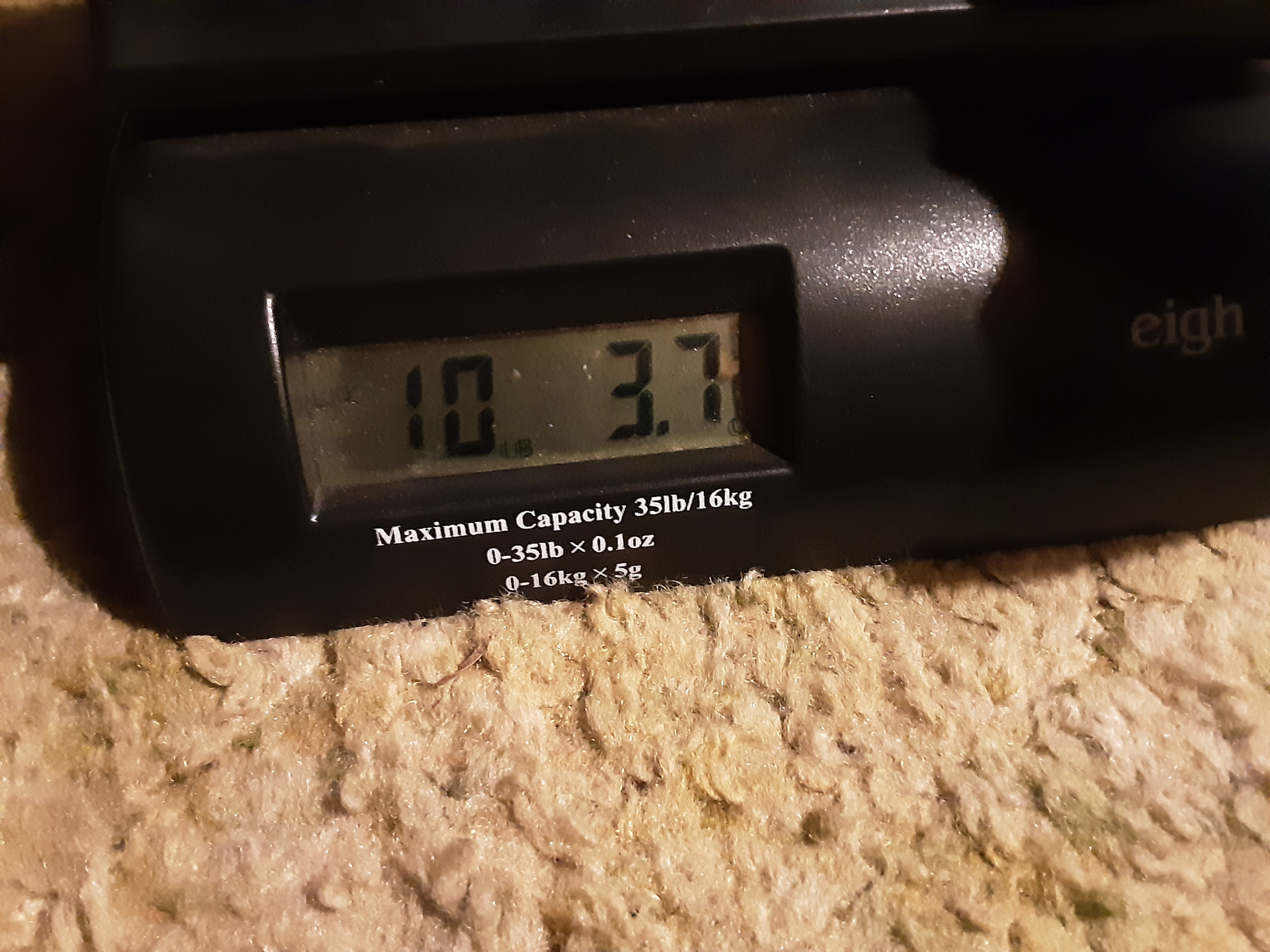

If anyone was wondering the weight of the TV standard is I put it on my postal scale. And the Maverick. They weigh less than some of the springers out there.

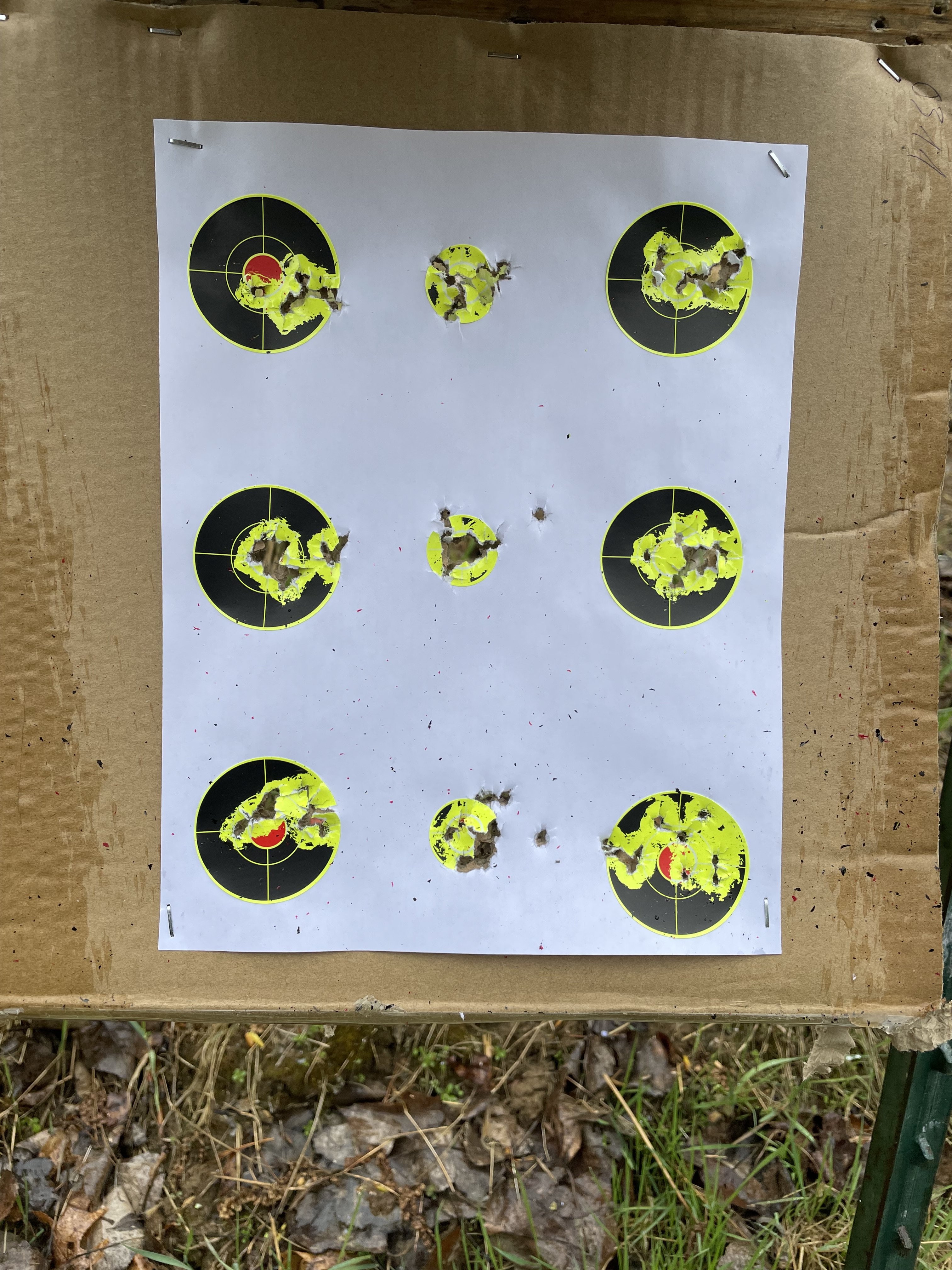

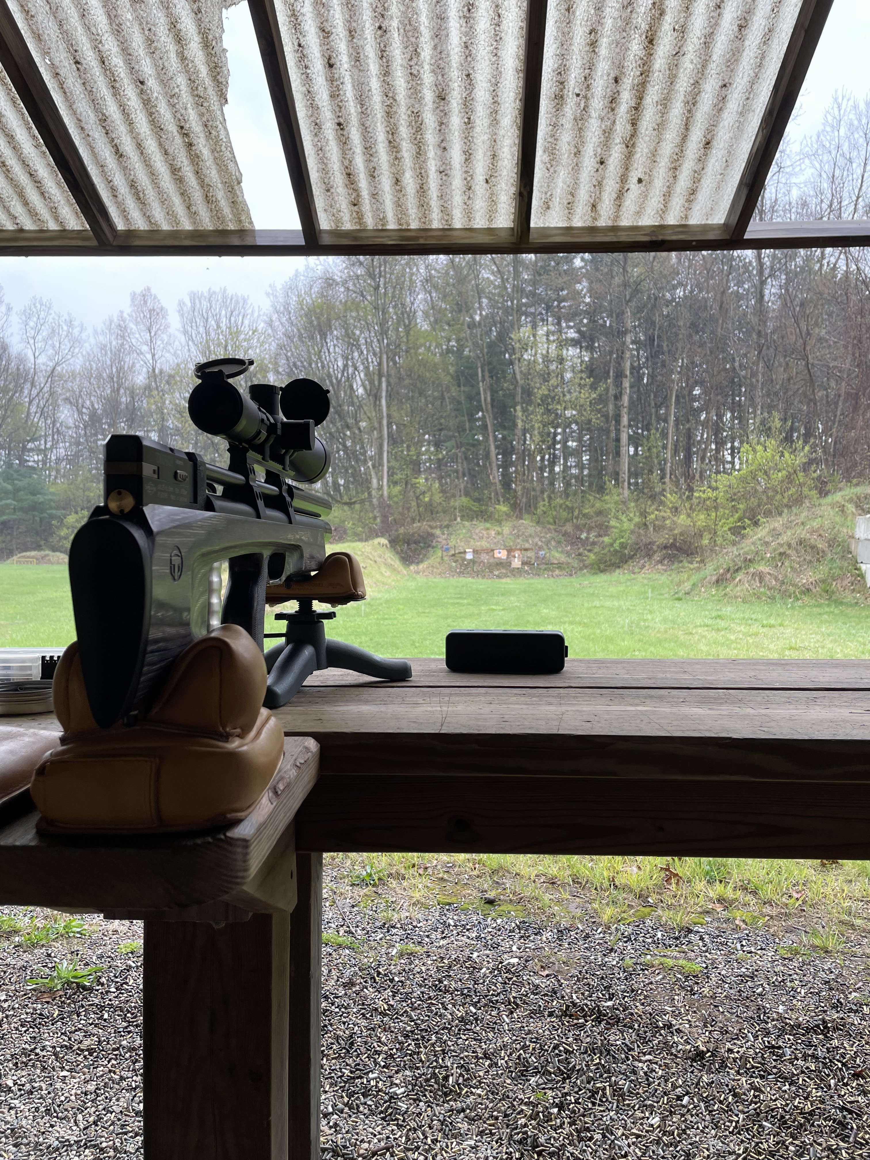

Here are some groups from my stock .25 Veteran. Shoots JSB Kings and MKII's pellets. Really likes the JSB Knock Out 34 gr slugs. These groups are with the Kings 25.39's in some pretty decent wind conditions. Built like a tank.
Super nice shooting backstop. It's the best I've seen on any forum. I could never understand how some people don't use a proper backstop. Especially these days of high powered airguns and .30 plus caliber slugs.
Nice groups . I might need to order some knockouts. Have you tried the fx slugs? Not that I need slugs. 16-25g pellets pellets will flat layout coon size critters on down .
