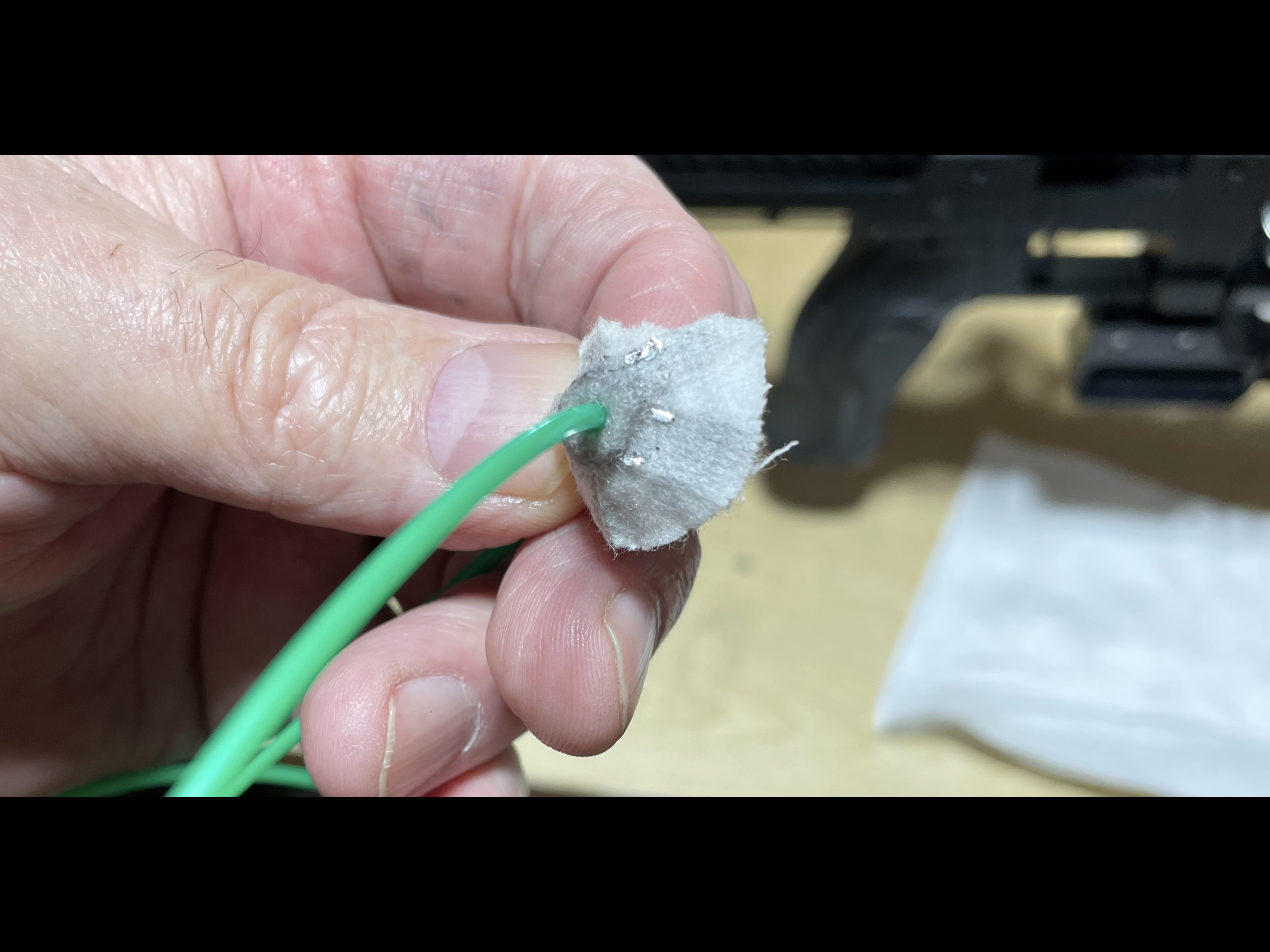

I’ve found that for me it takes a very, very tight patch to pull the JTS lead out of my barrels, and it seems there is more of it than with JSB. I agree with Franklink that they are as hard as Crosman pellets. I have a couple sleeves of JTS pellets, so I’ll be using them for a bit.

I’ve found that for me it takes a very, very tight patch to pull the JTS lead out of my barrels, and it seems there is more of it than with JSB. I agree with Franklink that they are as hard as Crosman pellets. I have a couple sleeves of JTS pellets, so I’ll be using them for a bit.View attachment 479056
That looks like a serious leading issue. I don't think I've ever had leading quite that size.
