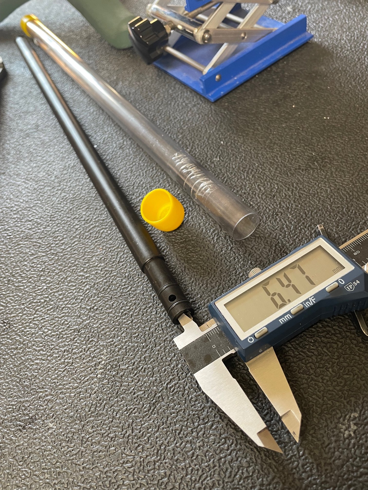

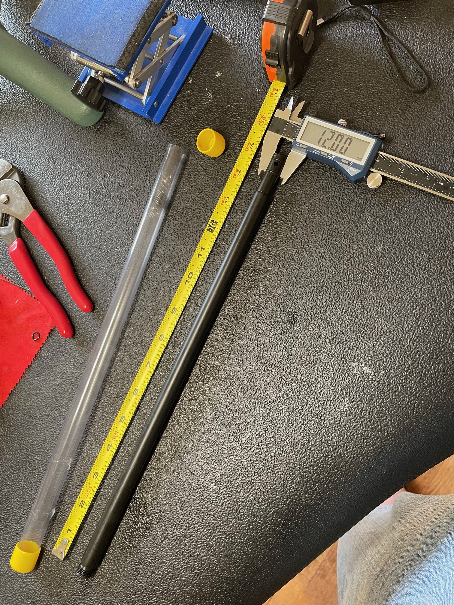

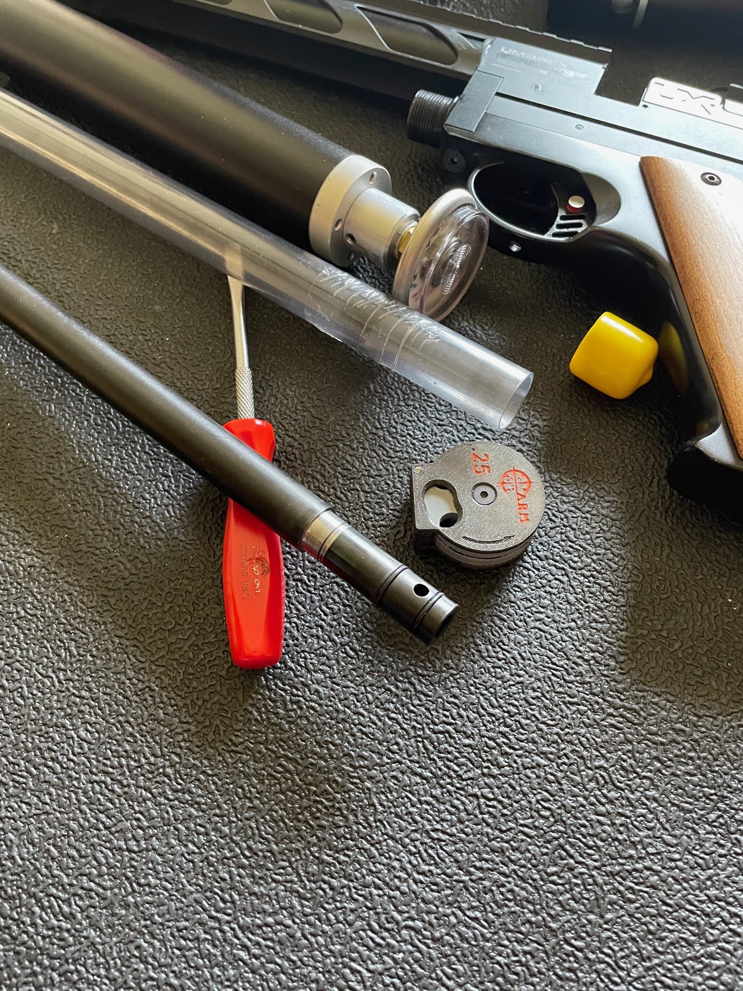

If any of you gentlemen are still looking for barrel, the one that requires the least work are Krall puncher NP3 and the Reximex Turmenta barrels. Both are 15" long, OD is 14 mm but the breech end is turned down to 12 mm OD. Then 12 mm section need to be lengthened to 40 mm. An alternate is to drill the breech block 14 mm by 5 mm deep if you don't have lathe access. Just got a Turmenta 25 cal. yesterday for my next pistol-micro carbine Notos project. Last pic 12 mm OD extended to 40 mm. For .177 conversion, you can use pp750 .177 pellet prob.
Reactions: PumaCarl and R0B

Thank you very much for all the information. Can I ask you does the Tormenta barrel port (hole) align with the Notos breach port ? Is there any way that you can measure the Tormenta barrel how many millimeters is from the center of the port (hole) to the beginning of the barrel. The Notos barrel measures almost 8.8 to 8.9 mm. Are you satisfied from the tormenta barrel and is it as accurate as the Notos barrel.
The port is off about .5 mm, you can drimel it to be egg shape or if you have a Bridgeport mill you can use a 5/32 end mill angle 10 degrees for a more laminar flow. This is what I do on all my barrel mods. I have been very luck with accuracy with all the Turkish barrel I have used. This company makes all the barrel for Kral, Reximex, Aselkon and Hatsan.
Reactions: PumaCarl
