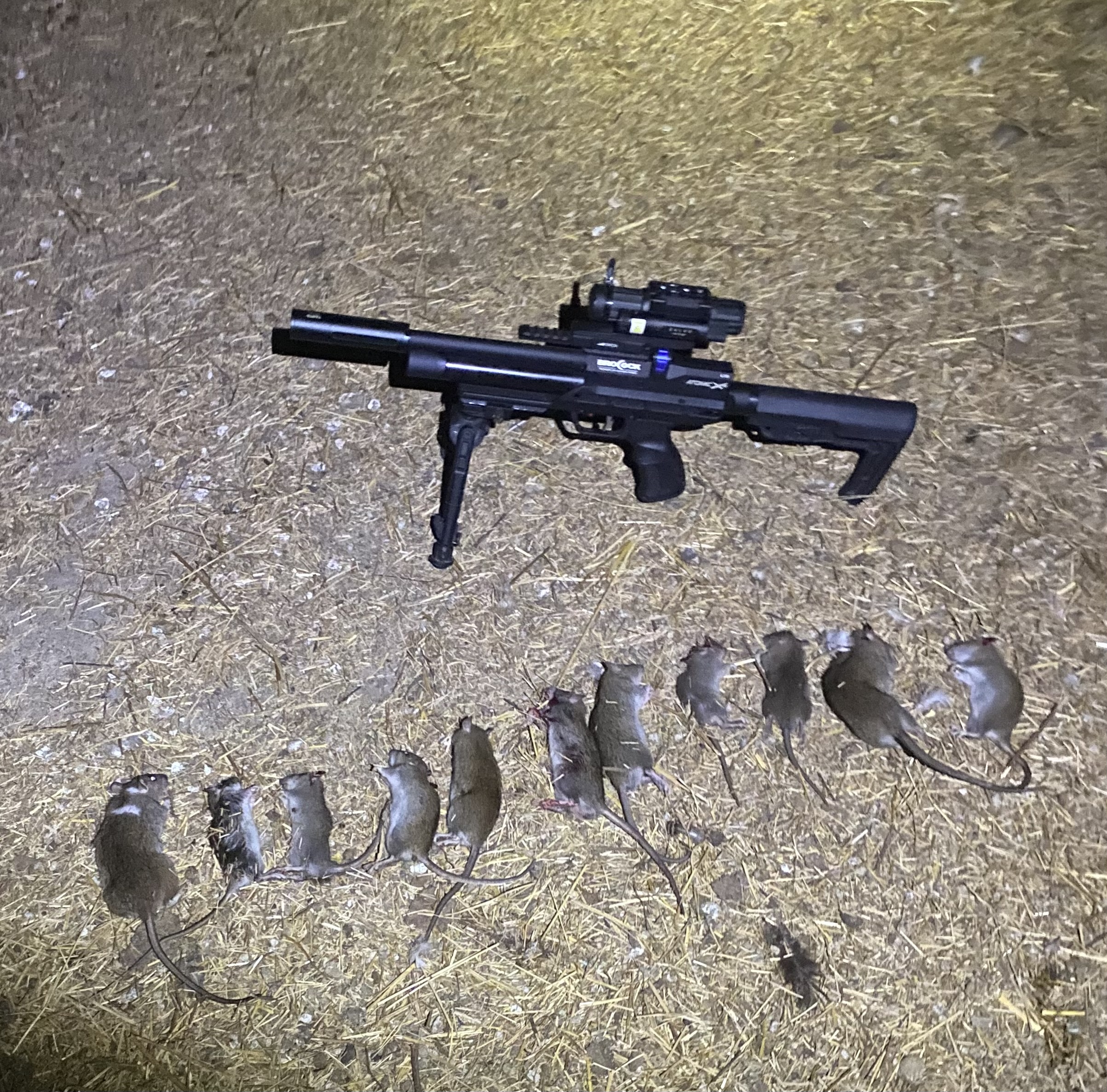

Yes, the Zulus form factor and features are game changers for me. I own the basic 5-20x non LRF model… It has been simply murder on the rats I go after. I almost, almost feel bad for them as the Zulus has proven quite effective out to 40 yards atop my Atomic XR… Can’t resist showing it off.🤓🙈🫣😈🙏

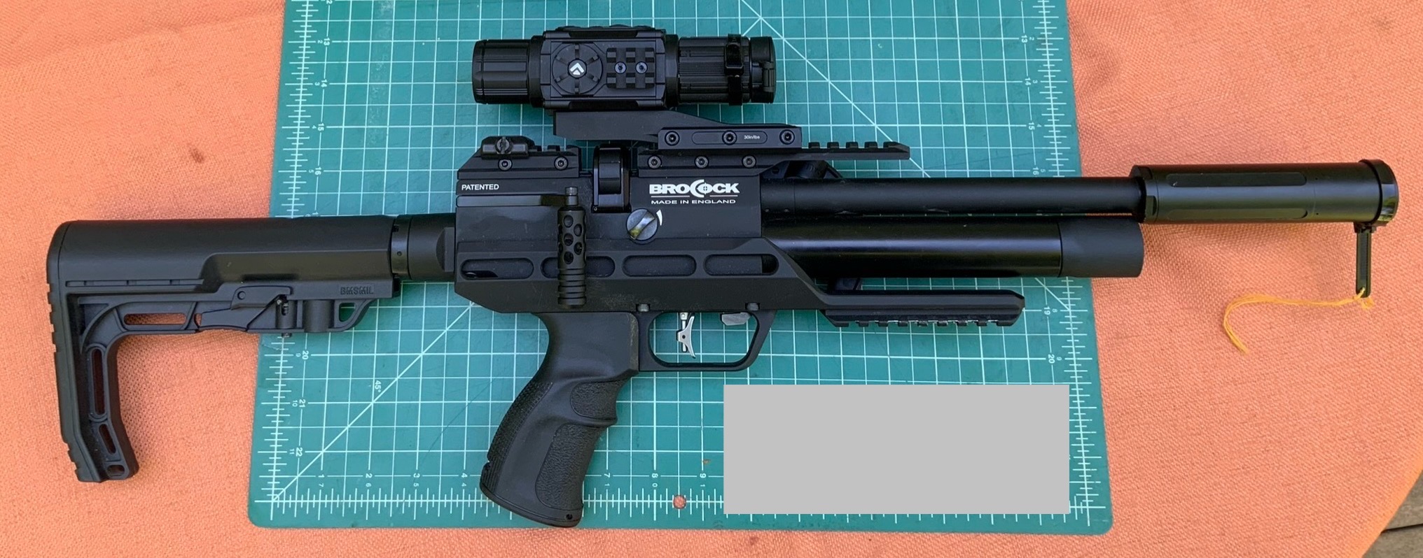

I'm glad you enjoy it so much. 😃 It's amazingly small, great for ultra compact guns.
I see your Zulus is mounted quite high.

Using it in the dark, plinking or killing rats is where it really shines for me. It is a specialized tool for me.,,
