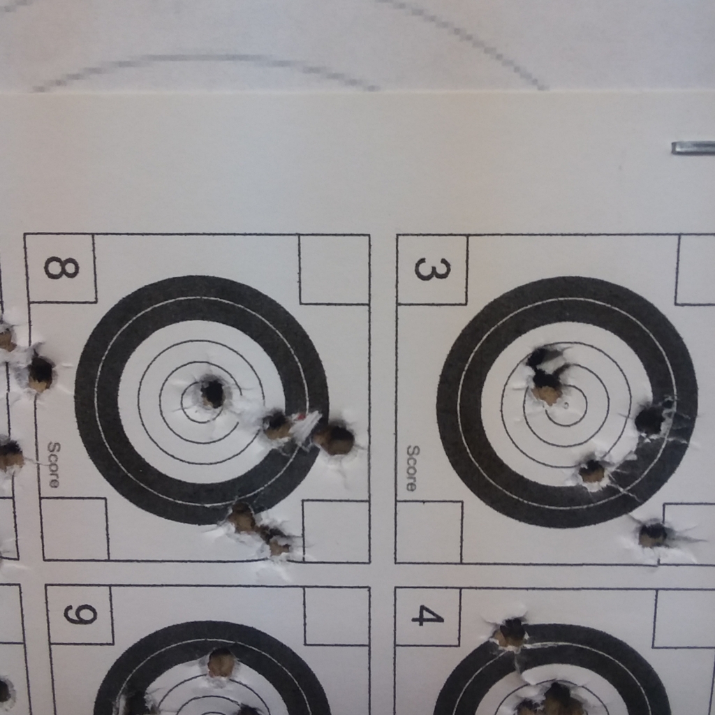

Here are the groups at 32 yds that caused this discussion. The first shot was the one closest to the bull. Second shot was always the low right one.

Here are today's results.
Just a recap on basic's first. R5M shooting JSB King 25 cal. at 890fps. Reg set at 120bar. (Huma).
Swapped out scope and rings. I took the scope and rings off my Leshiy. Verified accurate and reliable.
Barrel nut loosened and set to 12 foot/pounds with torque wrench.
Okay, start at top left. Base group. second to left no moderator (Damn that's loud). Third reinstalled moderator. Forth hand loaded.
Line two Switched to new lot number of pellets. As I finished this line I remember I only brought kings. I should of brought some heavys and MKIIs. Almost texted the ole lady to bring me some. But then again I thought better.
Last row. original lot of kings.
My take away from this. One, I do believe there might be something wrong with my scope. It seemed a lot more consistent today. With the smaller overall group size. At one point I felt everything came together, Then it would open up and throw some weird shots.
Oh same yardage 32.
In conclusion: I believe there is still some work for me to do, but it's not the guns fault.
I think there is a problem with the scope that was on it. I believe now it's pellet sensitive at least the barrel I have. (I might not have correct velocity as of yet).
As always thanks to all that replied and added their thoughts. I did not post this thread to discourage anyone from these fine rifle's. I was just discouraged mine didn't preform up to everyone else's.
