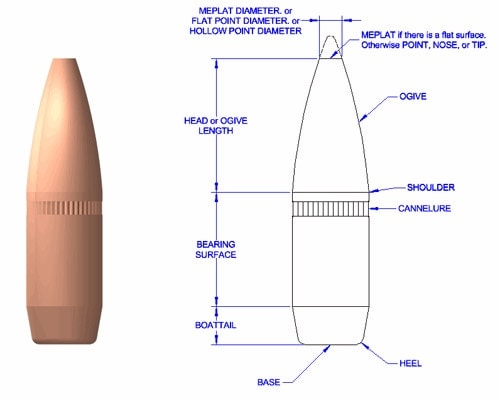

Oh man this thread is on one. Bullets and slugs are essentially the same thing = a projectile. Some airguns can shoot both airgun designed slugs and bullets (Bushbuck 45 for example).
A more precise definition of an airgun slug is one designed with less bearing surface engaging the lands of the rifling, having a shoulder to the ogive closer to the boat tail. Usually slugs are smaller dimensionally for the pressures used in an airgun.
Otherwise it's the same. That said, I would never say slug in reloading unless you are referring to a Shotgun, so in that sense it is more of a borrowed word.
Most airgun slugs have far less bearing surface than their PB equivalent. It isn't a black and white distinction but it is nevertheless present on most small bore slugs .35 cal and below.

Sorry it was late last night when I was trying to type. Here is some helpful pictures to illustrate the point. With an airgun operating on lower pressures, if you could arguably distinguish slugs from bullets, it would be as I said above. These two images show howa projectile edges the rifling. A longer bearing surface = more friction and thus more pressure in traditional PB. With airguns operating in say 1/50th the pressure, the edging of the rifling must be done on a smaller section of the bearing surface. If you used a traditional bullet in most airguns it would either be too little power to shoot it or the projectile would get stuck in the barrel, which we have seen from time to time with experiments done by airgunners.
-Atlas
