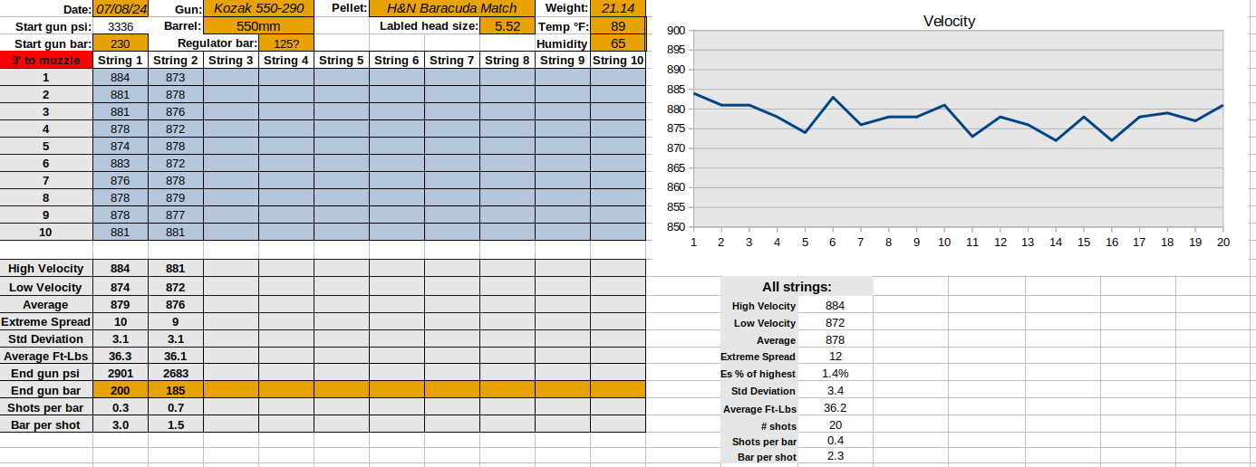

H&N Baracuda Match 21.14gr - great numbers, but not so great grouping at 50 yards (1 to 1-1/4" for 10 shots).

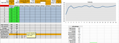

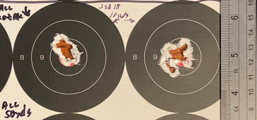

JSB 18gr - great at 50 yards (below; unsure about the 1st shot - not a common occurrence), as are 15.9gr.
