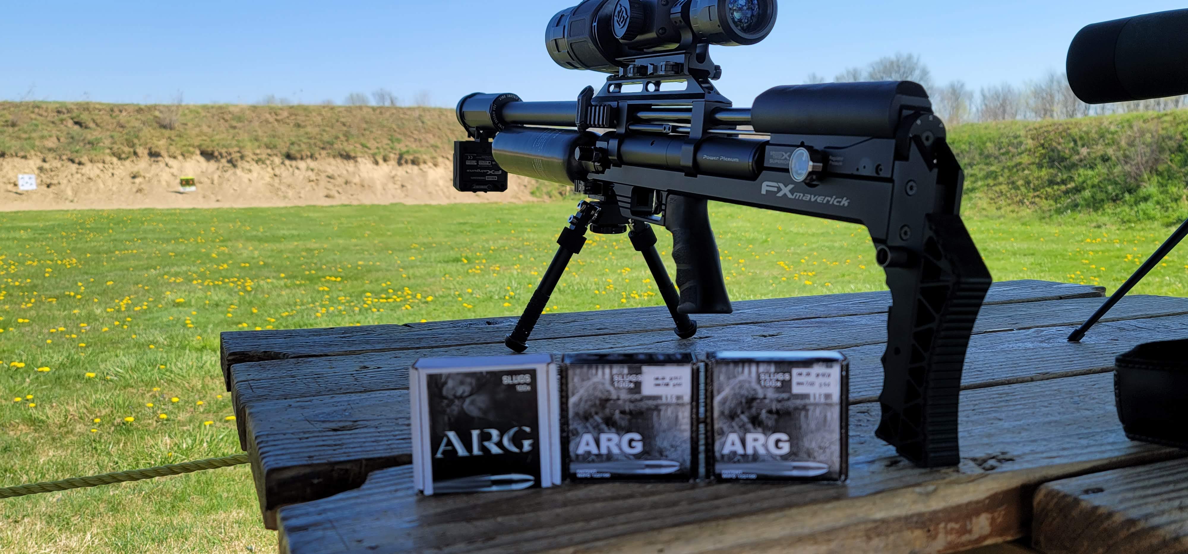

So, I finally was able to complete some initial testing with the ARG Slugs provided to me by . My Maverick VP .30cal is mostly a stock model with a 600mm barrel and Superior X Liner, but I added a carbon fiber liner stiffener and an aftermarket 580cc carbon fiber bottle. My 1st regulator is set at 170 bar while my 2nd reg is set at 150 bar.

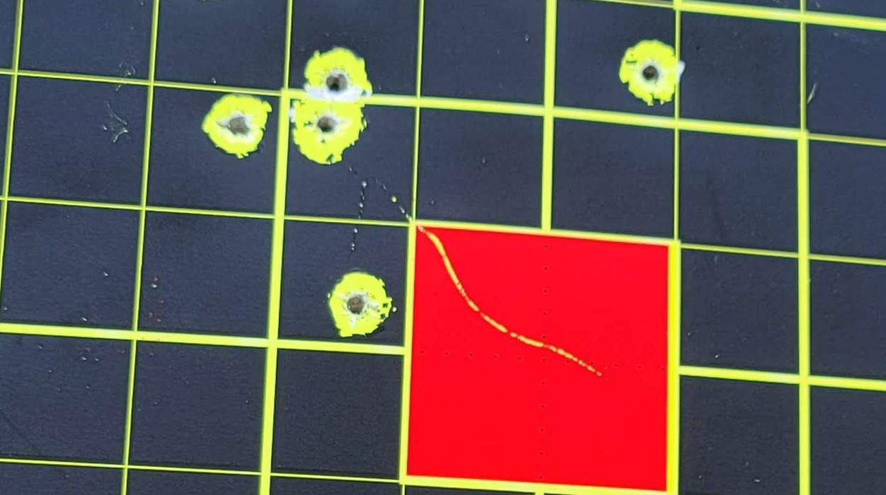

I got two flyers with the ARG Slugs, but we can see in the video above, the wind was very strong and unpredictable.
