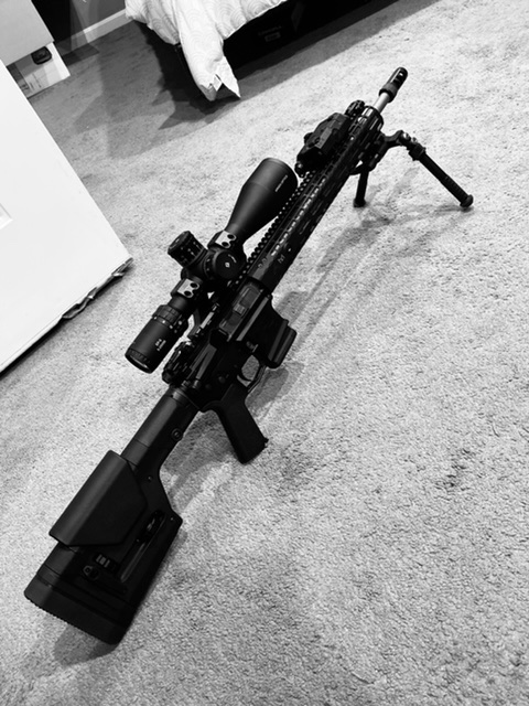

Mine has been flawless.. great little scope. My Athlon ETR is better… but for the price, you can’t go wrong with the EP5.
