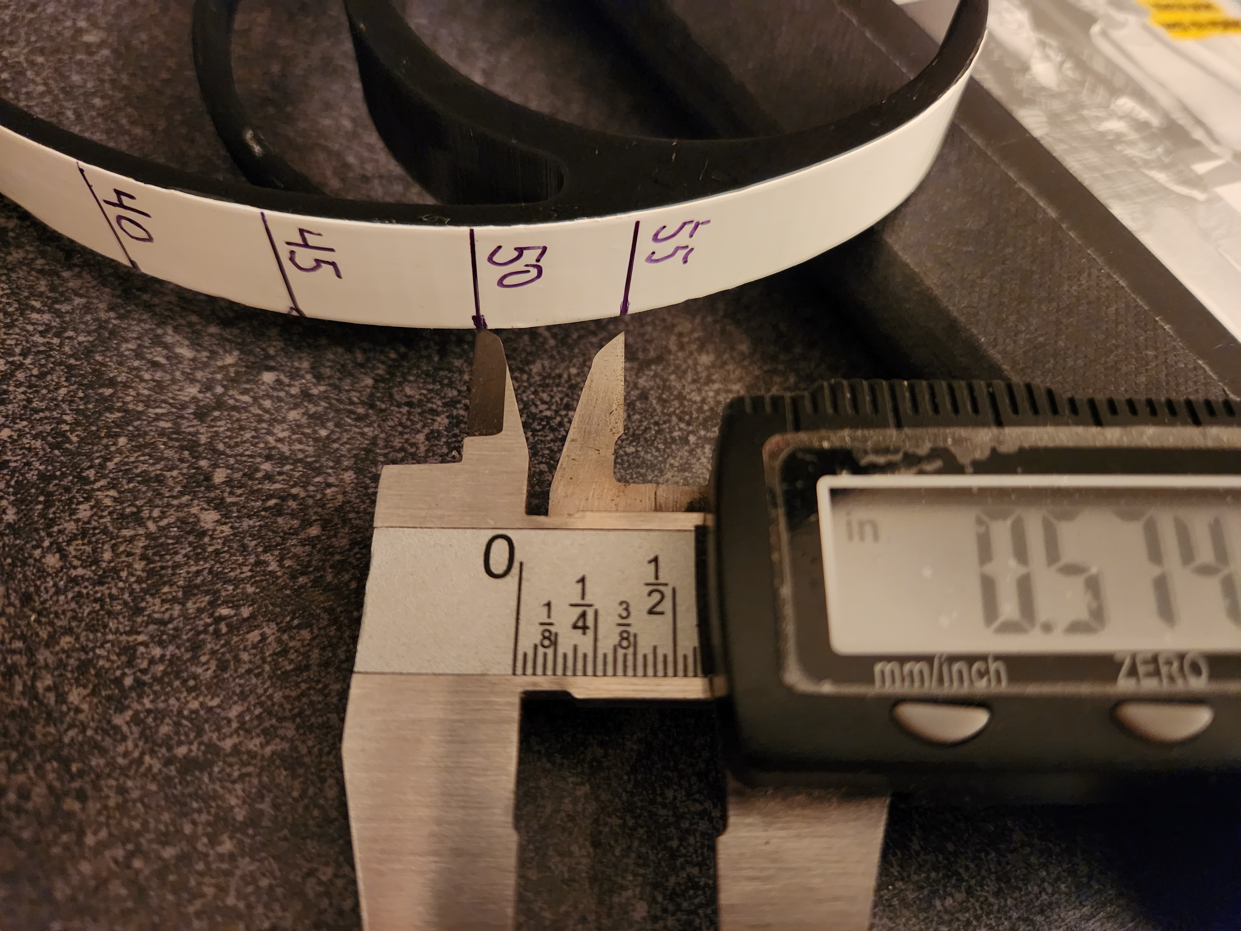

I was super excited to try it, as the side parallax knob rotates about 240 degrees! I thought that it would be the bees knees so to speak for ranging. I got a new JD Sidewheel setup and was getting the yardages setup (never figuring to double check check the near yardage). Anyway, I started at the far yardages and worked my way in. The 50 to 55 was over 1/2" - holly cow, I thought this is

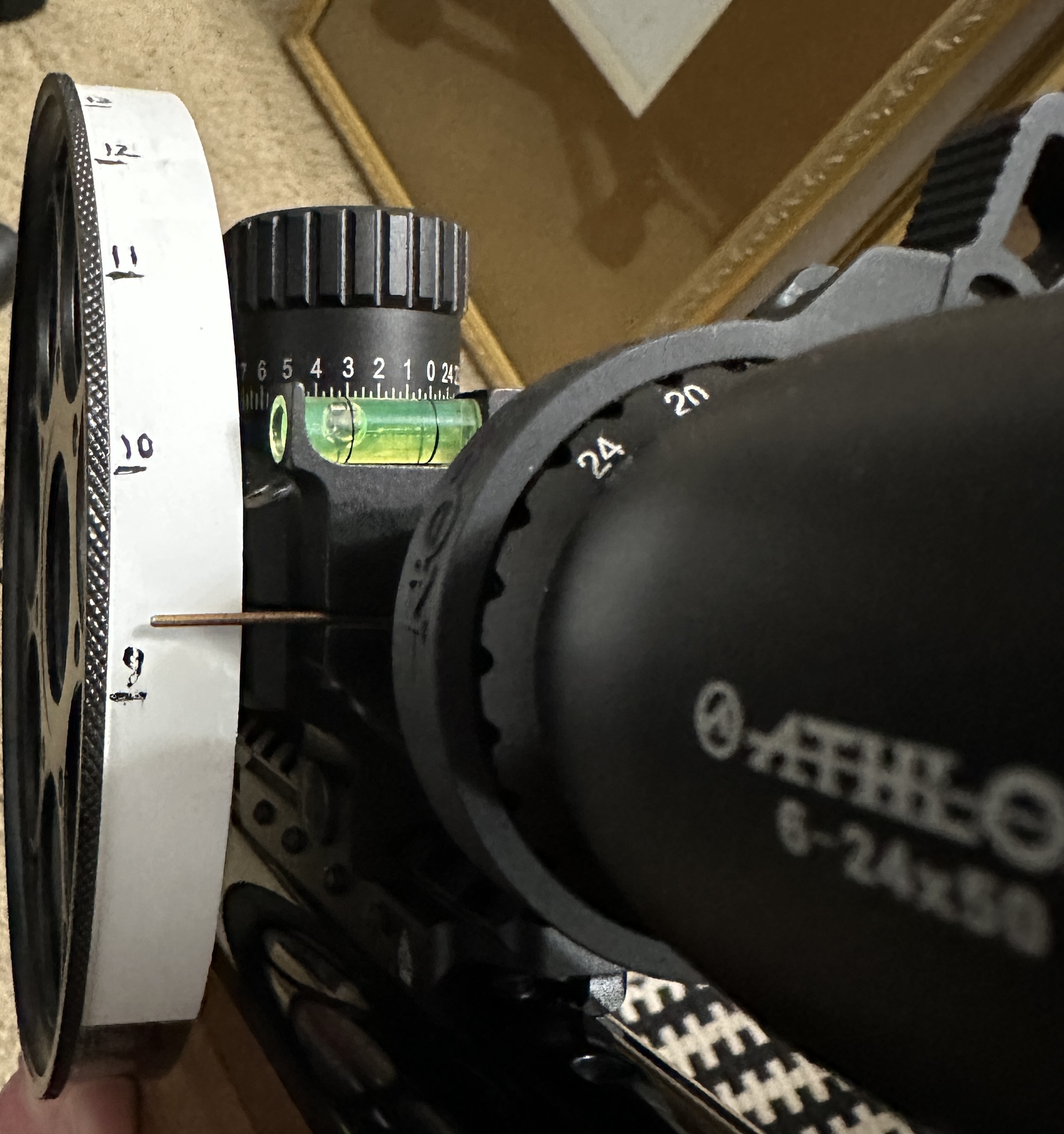

great. When I started moving in at around 15 yards, I started to run out of room. Sure enough, I could only get to about 12.5 yards. That just won't do for Field Target.
I shot off a note to Arken. They responded very quickly on a Sunday night even, but they said that it's up to my eyes, diopter, and magnification to get to 10 yards and wished me luck. I don't think that is how parallax adjustment works. I have a lot of scopes and they all do 10 yards without a problem, with my eyes, diopter setting and 16x magnification. My Athlon Midas Tac 6-24x50 have no problems with 10yards or even a little under.
