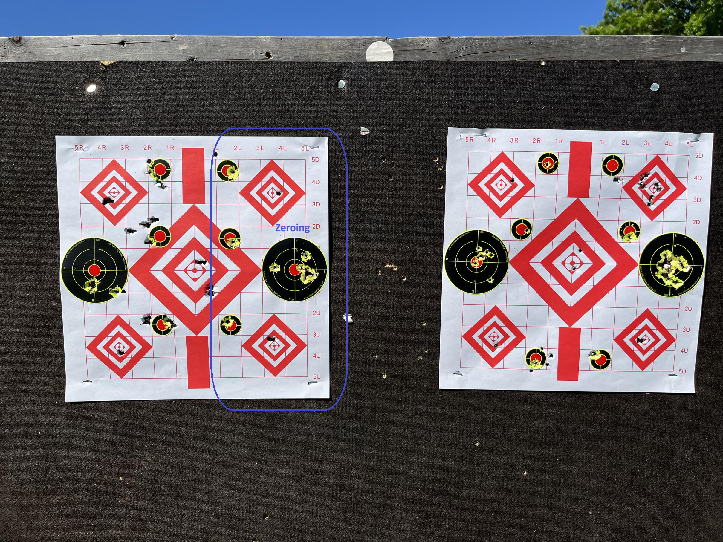

I went to the range today to shoot. Nice day under 90 degrees! I have the Arken Zulus 5x20 Non-LRF on my Uragan .25 (tuned by @zx10wall). It has been tuned for JSB 33.95 MKIIs and that is what I am shooting. I zeroed the gun at 30 yards first. These photos are at 50 yards with a hold over at the first reticle below the dot. I had the zoom at 20. The grouping on the large target was 10 shots. I didn't film the shots because I forgot the d!!n micro-sd card! As you can see, the shot group is decent - realizing that an old codger is shooting the gun! I did some shooting at 100 yards and the groups were at 2.5 inches... not my best but adequate and impressive for a digital scope using hold overs.

@LONESTAR .25 I did it the old fashioned way... After I have my zero set for the pellet/slug profile, I set my targets at determined ranges and shoot them to figure out the hold - trial and error! With the Arken, you can set many profiles and then just adjust for the next 10 - 15 yards until you hit your next profile and then start again. That way you have the same incremental holdover for the base profile zero'd yardage. Once I have them I write them down for each pellet/slug setting. Pretty much a dope sheet for each of the profiles.
