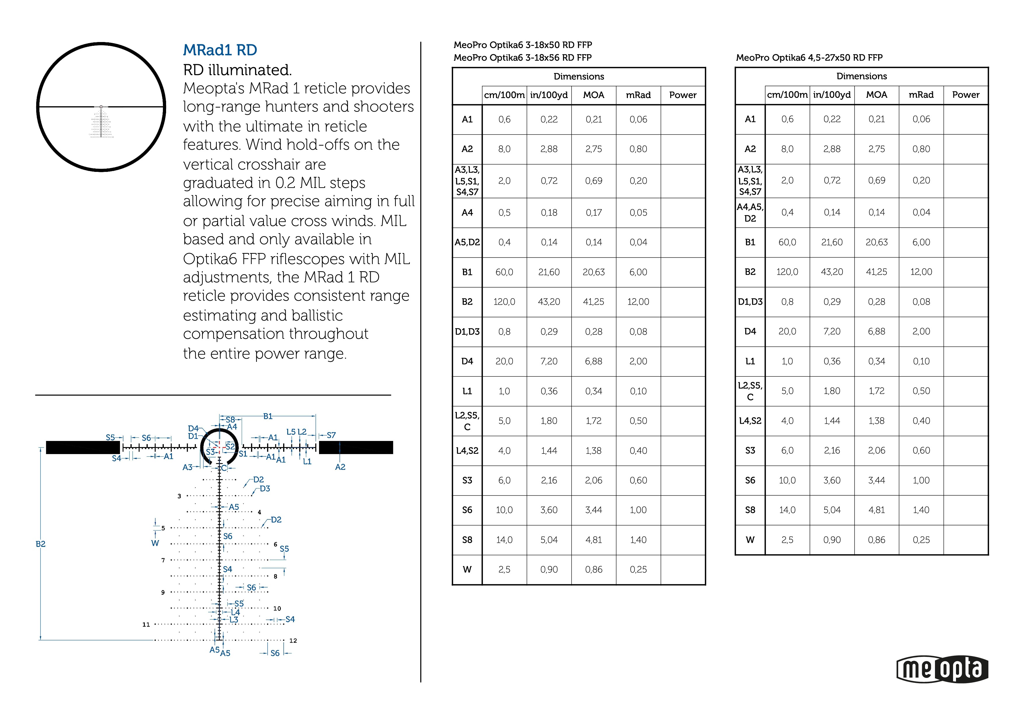

This problem of FFP reticles is augmented when it is in a high zoom ratio scope; for example, my Meopta Optika6 3-18x50 FFP MRAD1 which as a 6X zoom ratio. I use this scope as an example, because the reticle is actually very usable at all magnifications due to a 2 mil donut in the center. It is one of the few FFP scopes that I consider an effective hunting scope. While it looks quite large at 18X, at 3X the donut is just large enough to be effective in most hunting situations. Another FFP scope with a very similar reticle is the Athlon Helos BTR Gen2 2-12 and I think there is a reason that it is such a popular hunting scope.
When it gets dim or dark the Optika6 w/ MRAD1 reticle also has illumination but only the very center hashes inside the donut are illuminated. At 3X power with illumination on it is basically like using a red dot; very nice for dim/dark situations.

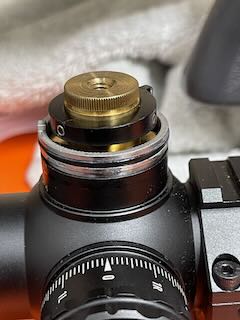

I'm putting my money where my mouth is, on a new EPL4 6-24x50 FFP MO 30 mil tube. I LOVE the turrets. I DID have an issue with the turrets on two of my Titians, being almost impossible to turn. I contacted Element and the cure was easy, silicon grease on an o-ring. Now my question is....WHY does this have to be done? The Chinese factory didn't lube the o-rings? I did both elevation and windage on both of my Titans, now smooth and easy to move. Strangely enough, the Nexus was fine but...I'll lube it also. But I'll probably be selling a couple of them. Too many scopes not enough guns that I'd want to put them on.

Now that you mention it, about five months ago I bought a Helix and could not get the elevation cap off. I ended up having to use a pliers, and despite my taping and caution, marred the cap. However, Element was very helpful and quick, and they sent me a new cap and turret shipping free and no questions asked. Their service was excellent. But in the neighborhood of your question, I wondered why the cap came so tightly screwed on. I have decent hand strength, for the record.

Wow, that's interesting, the question is, how in the heck did they get it on so tight? I just thought of this, those rubber jar grips would/should work to grab the caps, making it a touch easier to grip. Of course it doesn't matter now.

I did not mention it, but I did resort to using the rubber jar grips, but to no avail. S7

Probably the cap was put on not overly tightened but in a very warm place, or possibly the cap was warm/hot as well. Aluminum will shrink and it will be very tight cold. Just my best guess....
