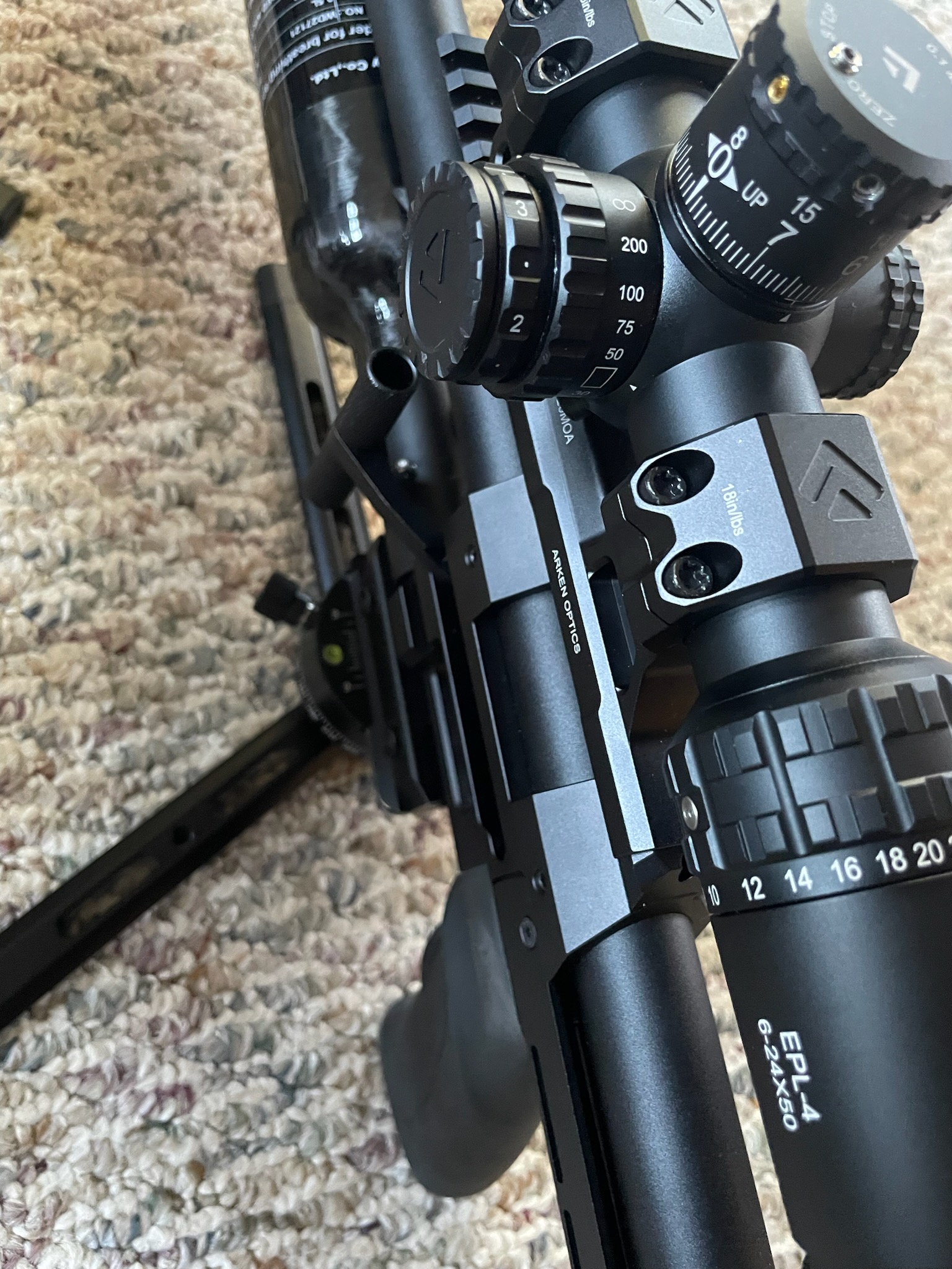

One cool thing about the illumination on the Arken EPL-4 is that it only requires one click to turn off illumination - no matter which illumination setting you choose. As you can see in the picture, there is an “off” detent between each illumination setting.
On the downside of this, I find myself constantly trying to turn the illumination, rather than the parallax, as they are on the same “knob” - it will take some time to get used to this.

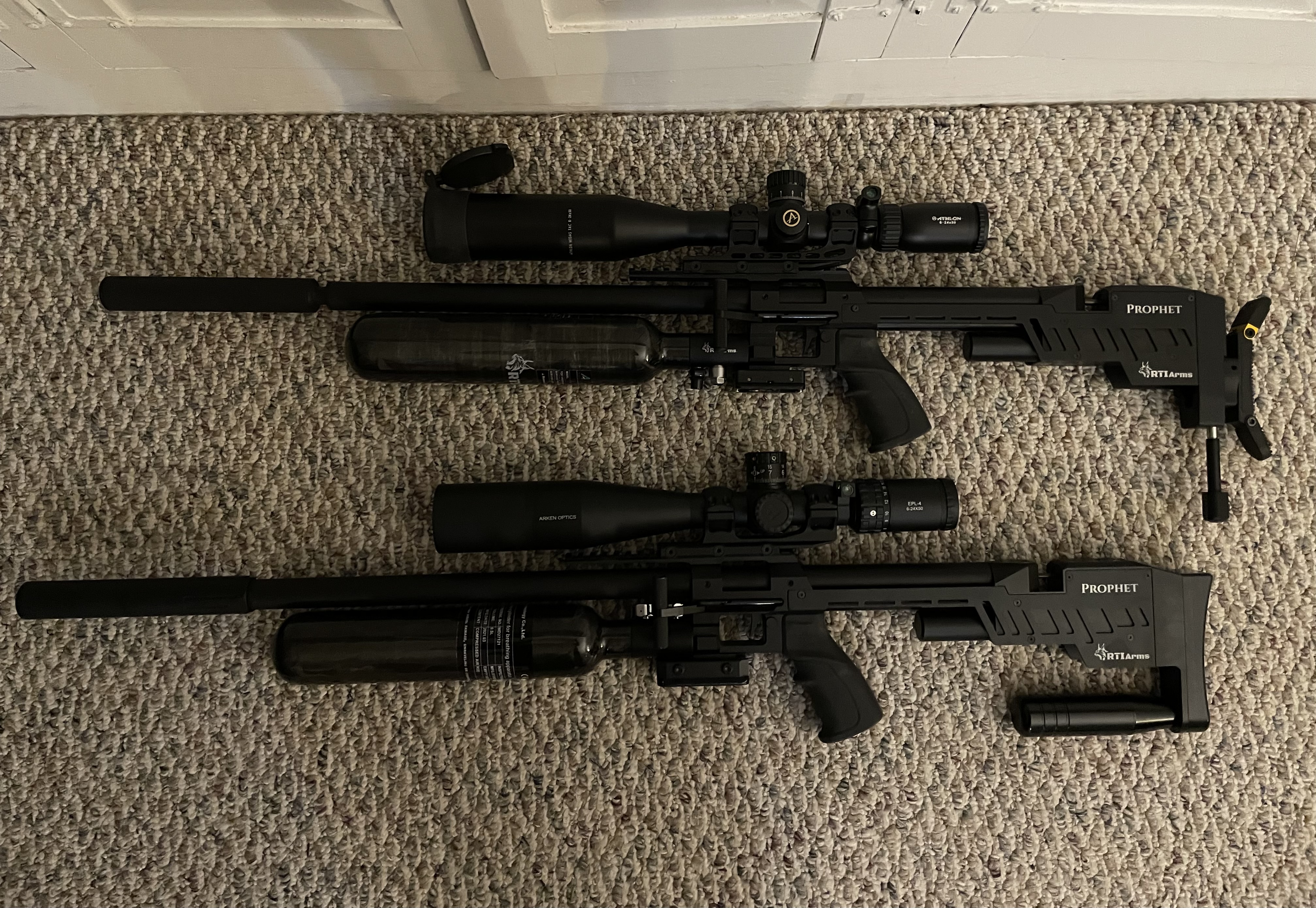

Now a thought on the scope body - I prefer the Arken over the Athlon (and I love Athlon scopes and own at least 7). The reason is weight - I have the two scopes mounted on identical RTI Prophets and the difference is immediately noticeable. The Arken is much lighter- making the rifle handle nicer and feel better balanced.
