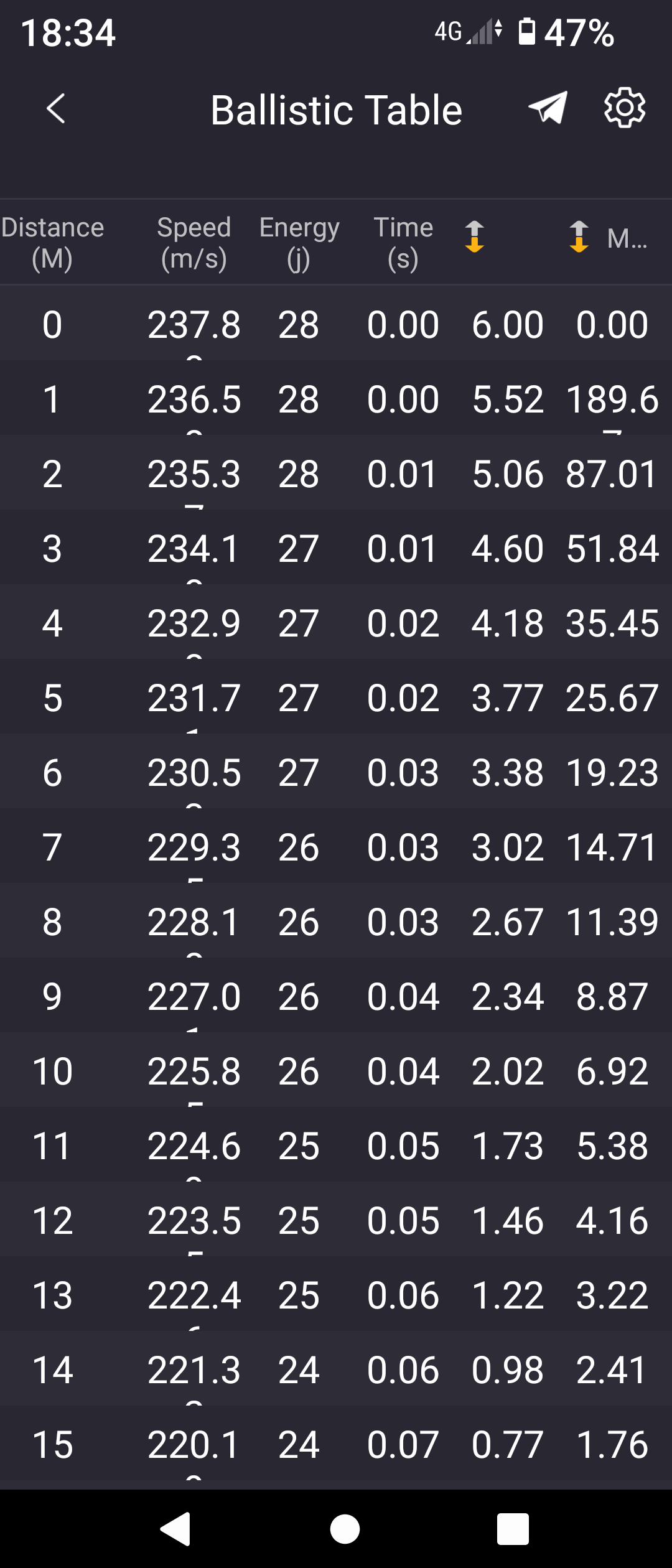

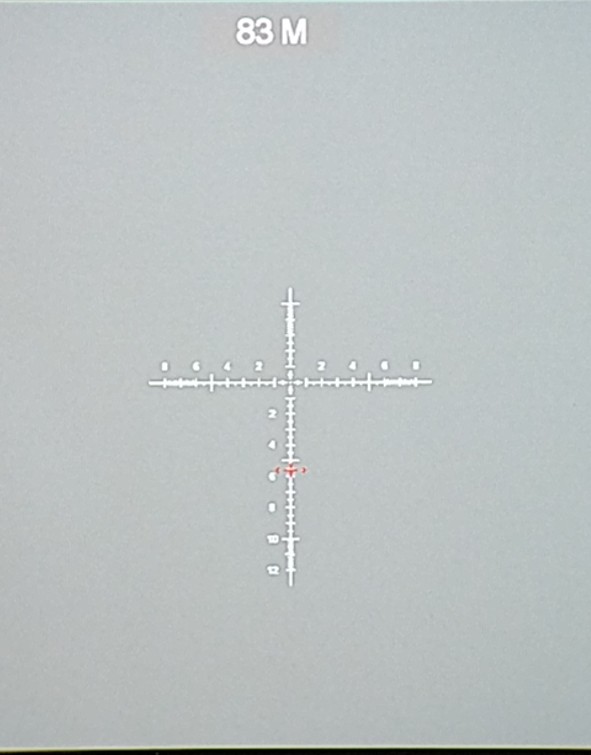

I might be doing something wrong, but I can not get my ballistics table and holdover marks to match.
The blue line is where it should be
I have made sure
- I have the correct table uploaded
- I have the latest updates
- the gyro has been calibrated
- the range was taken from level
- all of my input data is correct.

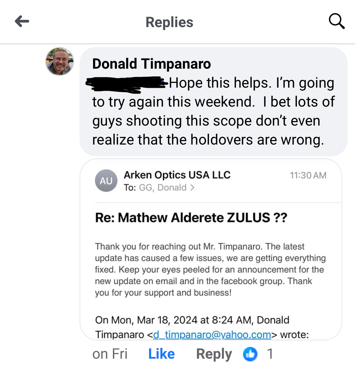

I have gotten a response from the Facebook Zulus group that seems to indicate that Arken knows of a problem.

The BC is good. I have measured it many different ways. The table is correct when it comes to the drop. I have measured this by putting on a regular scope and dialing out to 100 yards. It’s the Zulus calculation that is giving me the wrong holdover point. You can see this from my zero when I put in the correct scope measurements. The holdover it gives me is the wrong point of impact. I have to put my scope height at .5in to get my point of aim dead center at 20 yards.

Because this is what I noticed: I have set a 12m zero range in my scope. The ballistics is spot on. When I range 12m. horizontal, the holdover aiming mark is centered. (like you'd expect...) But when I range from the same position to a 20 degree up, (using a flagpole) the shown range increases to 15m. (remember: the horizontal distance is still 12m!) now the aiming mark changes slightly to hold over. (like your situation) So it must correct for angle as well, as in my case with a horizontal distance of 15m the aimingmark should indicate a holdunder! (and again: the ballistics when shot horizontal is spot on)

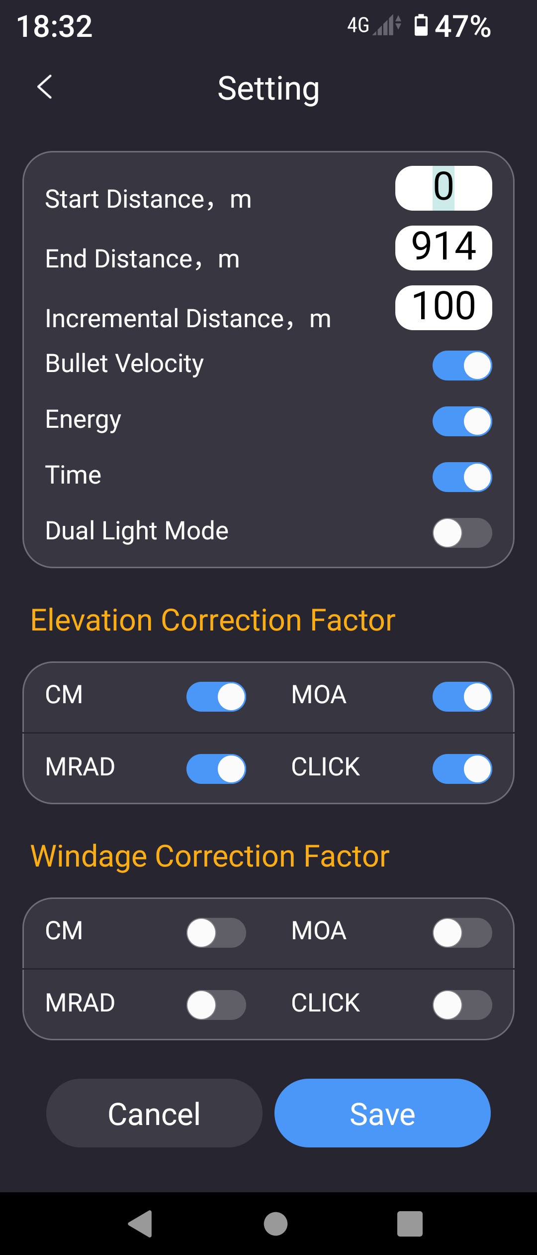

A Hold over solve.
I could not get hold over to show. I'd range then press again and it would say out of range.
I set zero distance at 20mtrs then do your ballistics.. after that save it.
Then All I did was go to ballistic table and press setting in the top right of screen
Top 3 boxes should be..
Start distance =0
End distance=100
More than 100 if you shoot further. Air guns 100 is
plenty.
Incremental distance =1
My app installed with settings of
0-914-100 which is wrong.
Save it and it returns to ballistic table with all the ballistics from 0-100
Now send that to the scope..it should now show your hold over.
It works.. you've just then got to range 20myr somewhere and zero your reticle.. you're all set up..👍

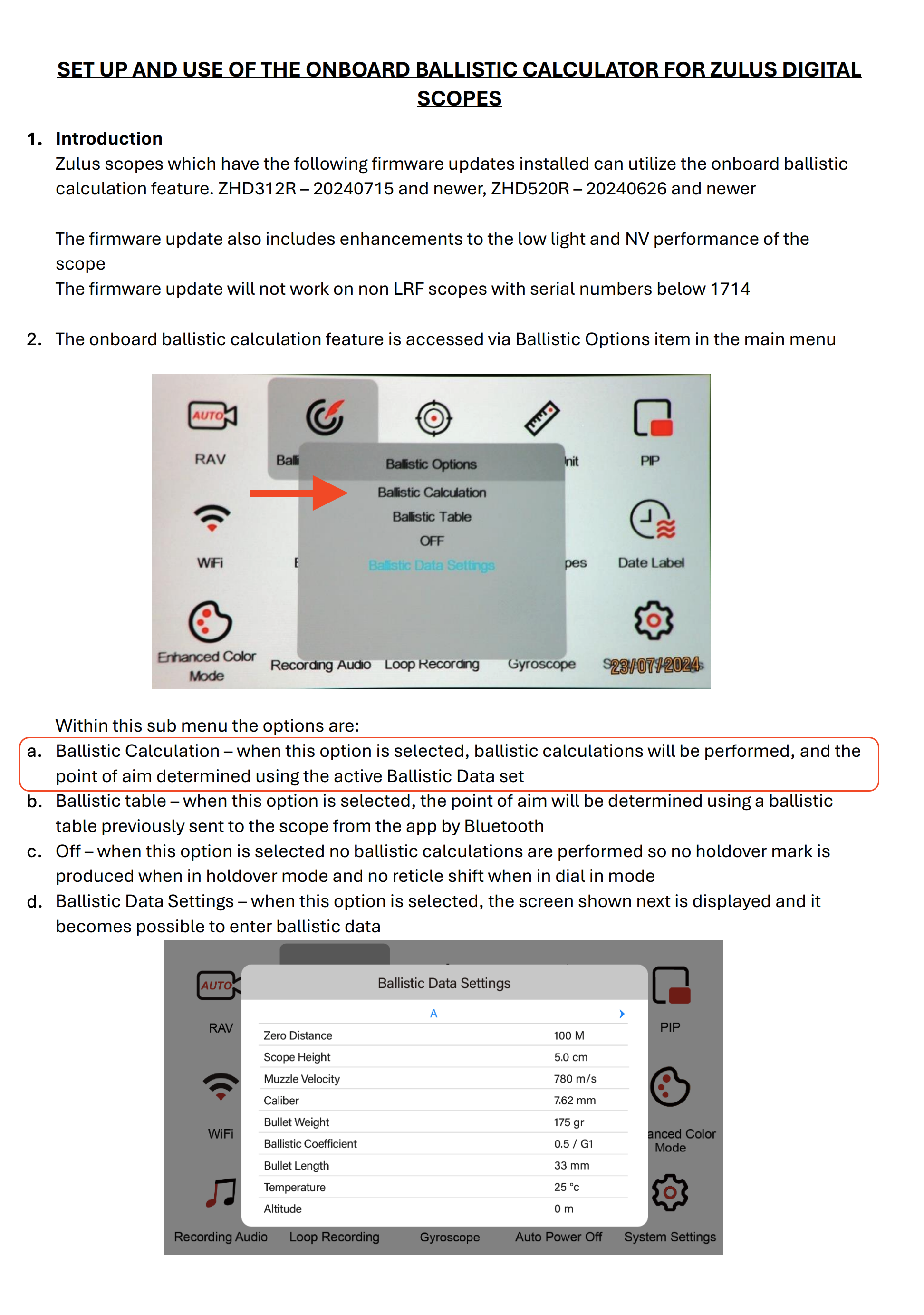

I hear there's a poi correction function potentially. In the new firmware update there's now an alphabet in my zero menu in the scope firmware that I suspect may be related. If it doesnt have that function it would be neat to be able to paper the gun and input the data manually per range if the ballistic calculation was off. Previously I had simply toyed with velocity, bc, and initial zero range to get as close as possible (usually by using strelok to help me achieve the variable mods).
