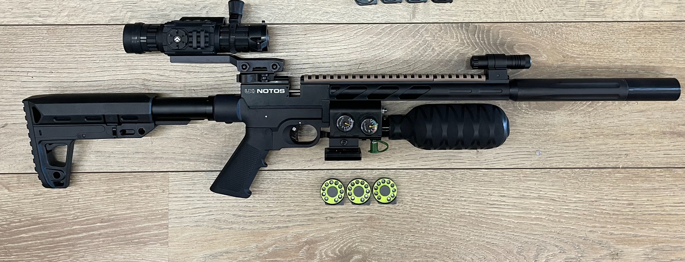

I tinkered to use a rubber microscope eyecup to put my eyebrow against when using the scope. The supplied eyecup is really just made for lowlight situations where one does not want the light to bleed OUT of the scope (so as to not alert any prey)
For the front I used a flip cover with a 6mm hole drilled through, so when it is sunny outside the cover remains closed, and you have a real long depth of field. (Did not want to ruin the original flipcover)
To manipulate the focusring, I used to use a so called coaster, but I have since remixed a 3D design so I use that now As ot looks a little more refined (the coasterknob is really big, as you can see on the pic below)
The mags are remixed by me as well, as I find the Daystate/BRK type magazines the most convenient to load. Because after you put the first pellet in to lock the rotor, the rest of the pellets can simply be springled on (cup the rotor with your thumb and index finger) and with a little smooth swaying mostly all of them fall nicely head down into their respective places. So I just did away with the covering plate altogether as the pellets on the used type of magazine (Carm, Bigair, Maple etc.) are retained by the oring around the rotor.
BTW I moved the scope forward so it to attaches just in front of the magazine breech now…
