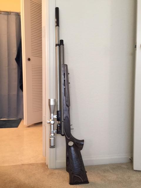

I’ve had my armada.25 a while now. Painted, side lever Breech, war valve bored to .201, mds hammer and dual wound spring. But I really hated taking the armada apart for servicing and tuning...so I got a grey laminate Boyd’s pro varmint in today. The stock is lite and fits me well. Time for a repaint and one final addition. I have a speed dial adjuster I’ve been wanting to use but couldn’t because of the armada configuration. Probably my most versatile gun, 40 to 90 ft lbs on the fly once the adjuster goes in. Not with the same Ammo of coarse. I have it set at 65 ft lbs with varmint knockers 33 grain at the moment. I’ve got to get a piece of aluminum or stainless and make a custom trigger guard.
Sharp looking gun. They are great, I have 3 marauders and 2 armadas one being a 30 caliber bottle carbine. Are you still using the factory barrel or did you upgrade to something different?
