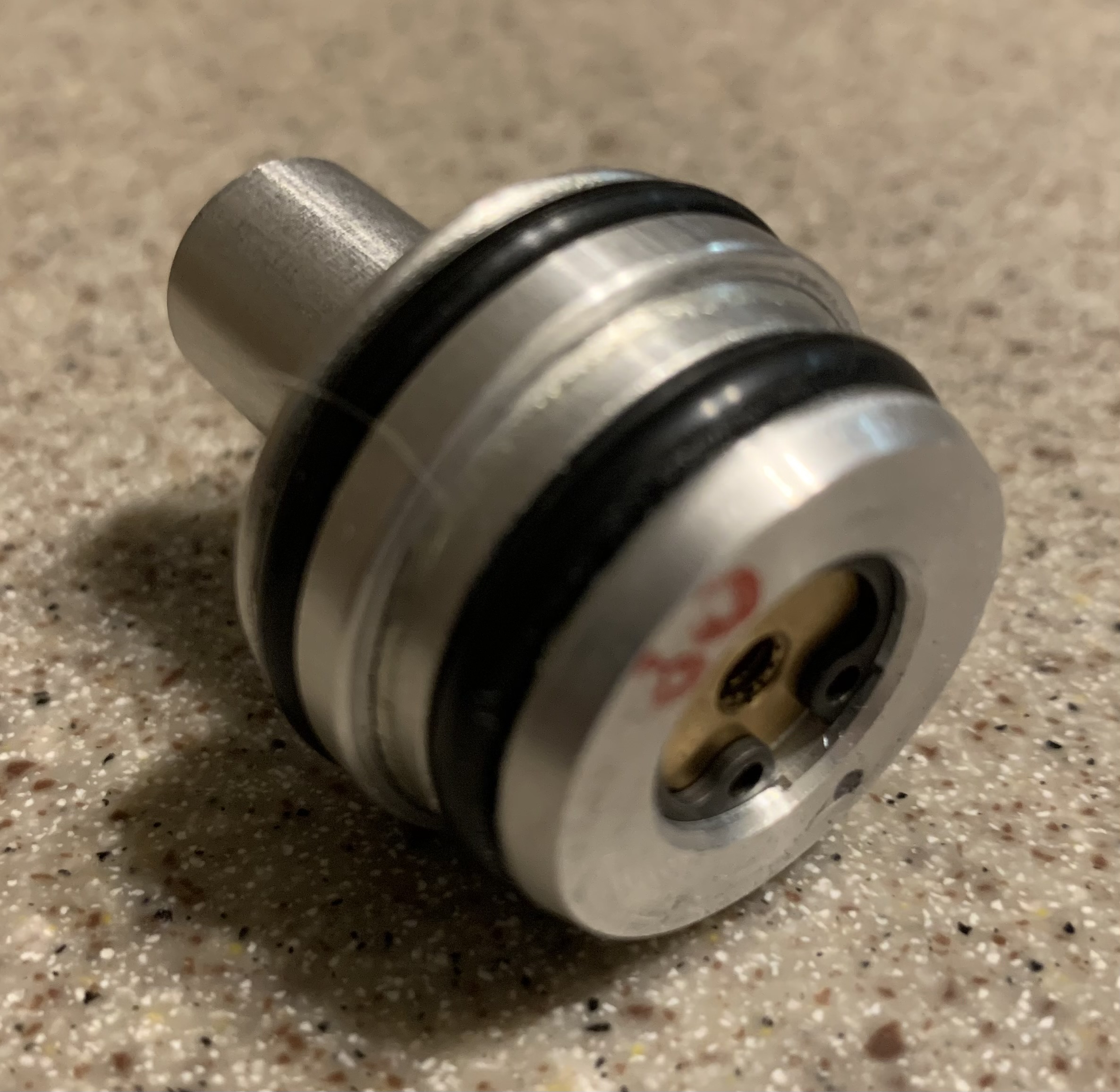

I’ve had issues with the regulator on the katran for a long time. The v2 back plug is what you need to run the huma. Getting it work was a bit of a pain as the air would leak out the barrel. I Was able to get this to work though.

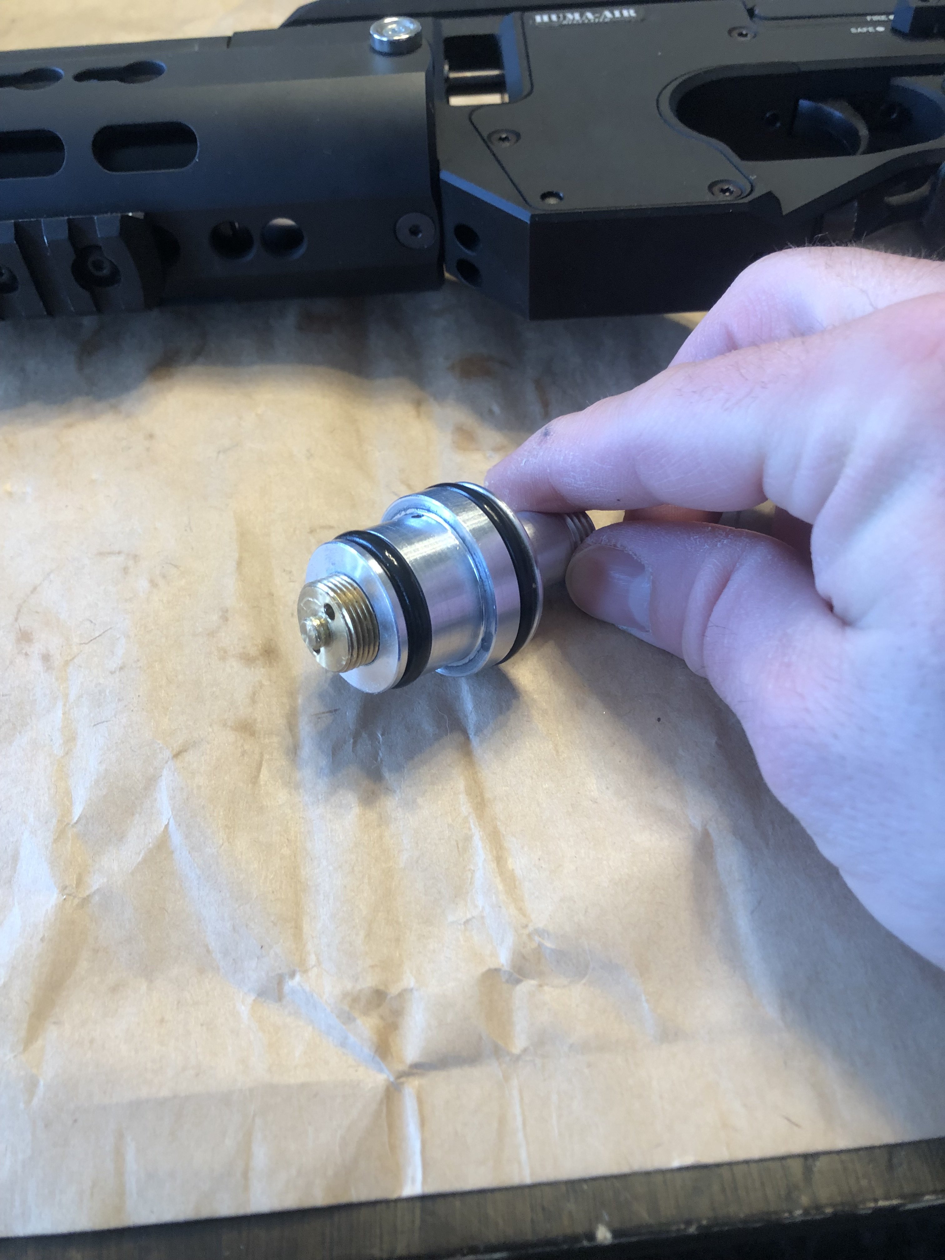

Here is what I mean. Also the v1 has no bleeder valve. You had to use a de gassing tool. I bent my hammer spring guide rod doing the original way.

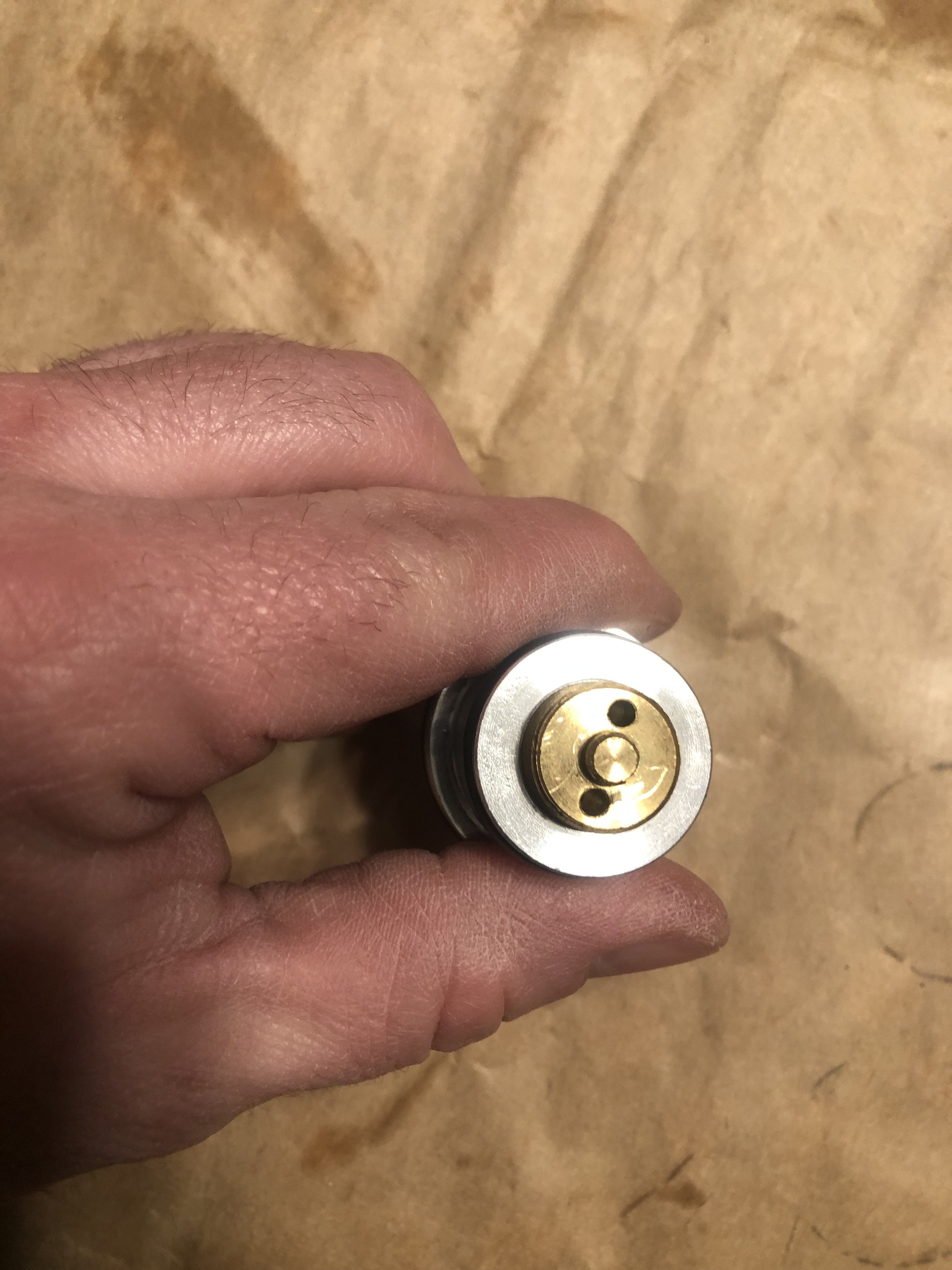

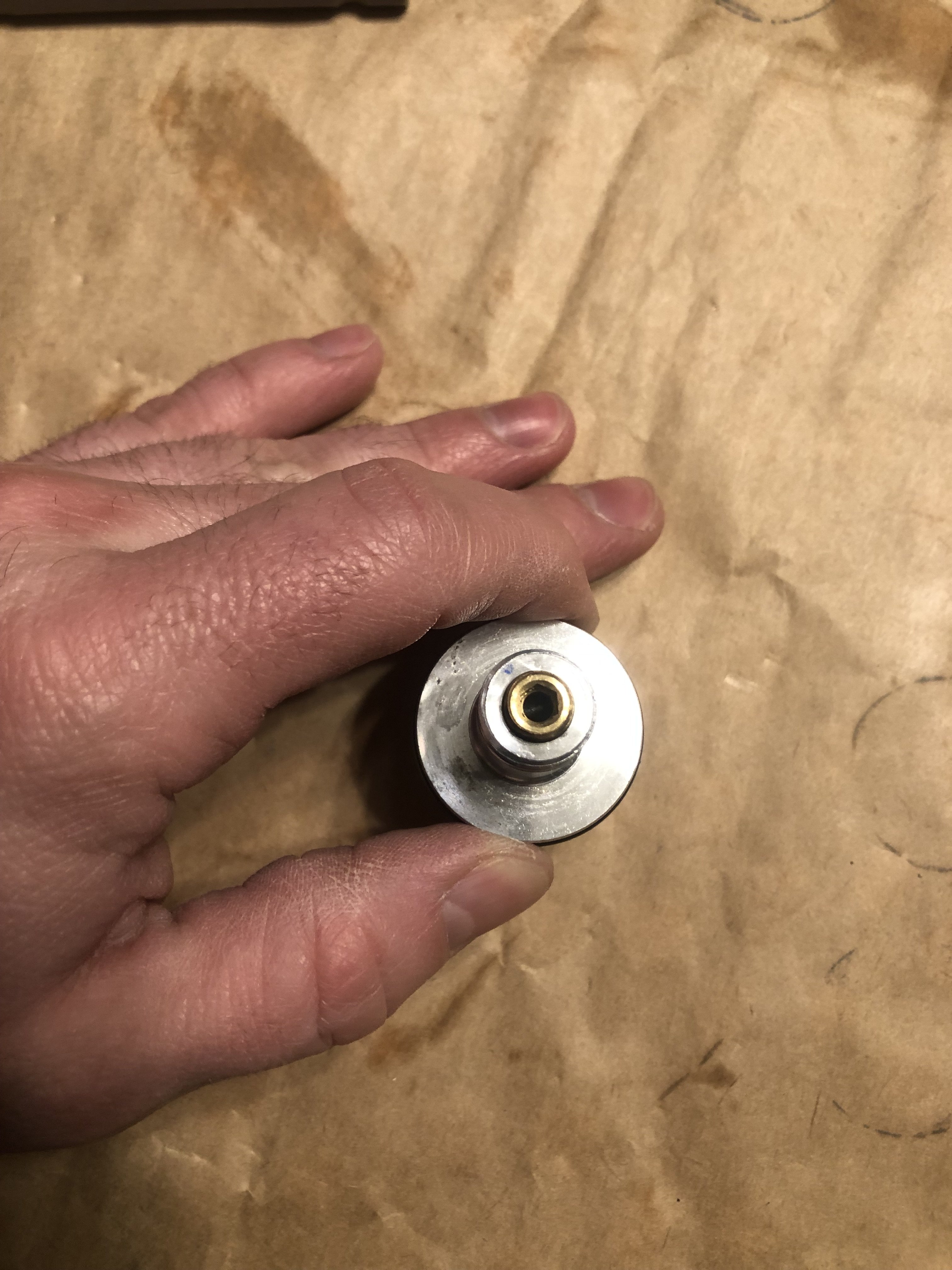

Show both ends if you can. And is that a super small brass screw in the middle of the large brass "screw" If there is a small allen head screw on the opposite end that would probably be the adjustment screw I believe, but I can't find a pic of this "V1" generation reg on the net so far.

Mine still requires manual degassing. There is then a new one which they call a V2 that has a degassing screw and some other changes.
Some vendors refer to it as a V2+, but I just call mine a V2-
Shout out to Utah Airguns for getting me the V2.
Happy with the huma.

So you can use the huma reg in the cb v2 back plug? I have the the v2 back plug already and have been getting reg issues recently. On the huma website it says it for the tube version only.
I had to do a ton of digging around and looking a lots of vids but yes I have the v2 back plug with the huma reg. On the installation manual on humas site it shows the bottle portion. You have to have the v2 and it’s a drop in for huma.
