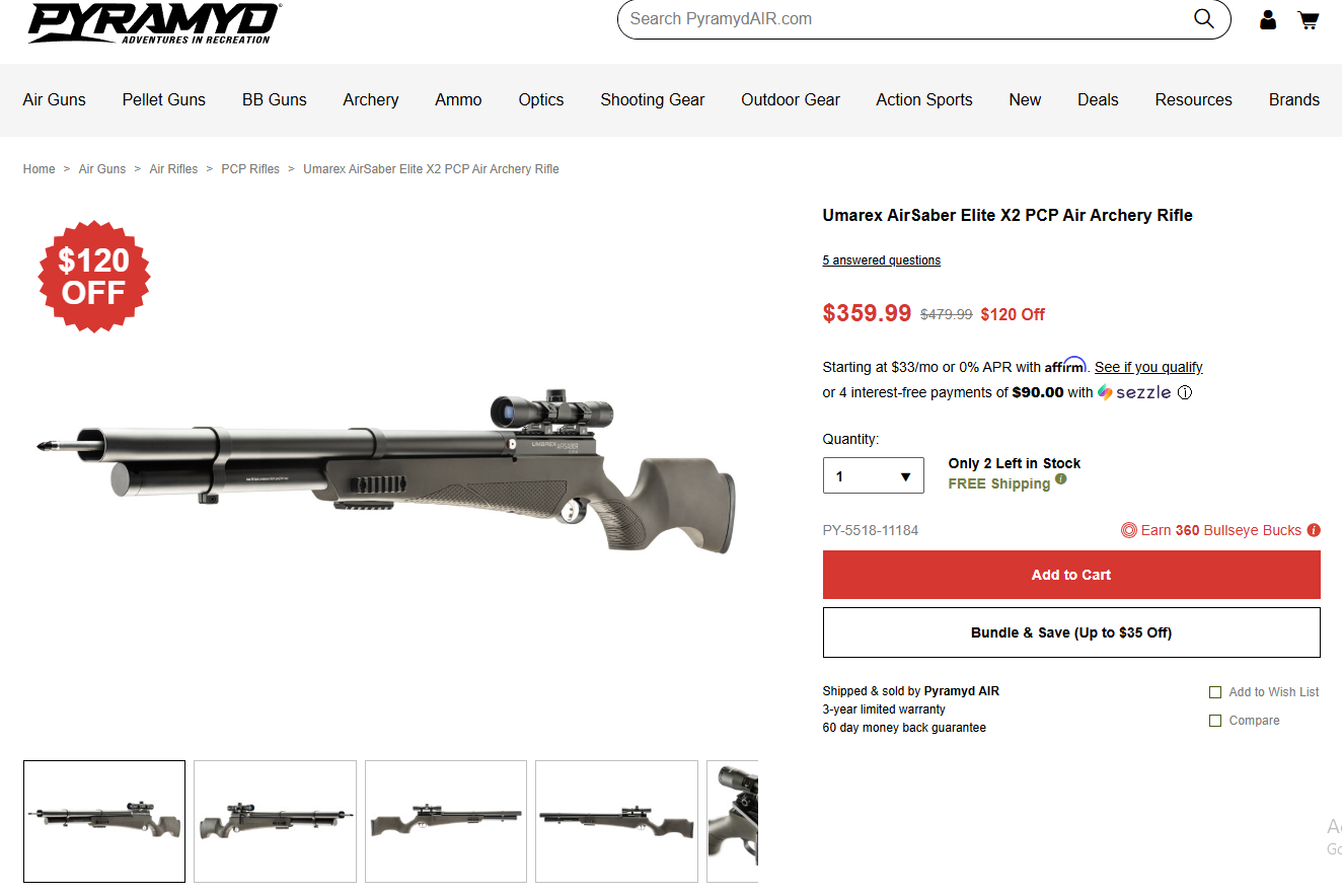

I had an Airjavelin (C02) and an Airjavelin Pro (HPA) for a couple of years. Those were light carbines in the 35fpe power range and fun to shoot. Then had an Airsaber for a while it's a lot of power for the price. The Airsaber was very easy to shoot but (as was mentioned in detail in an earlier post in this thread) arrows going that fast still broke frequently and tore vanes or were difficult to remove even with the (necessary) high-velocity easy-release targets. And arrows were impossible to remove without breaking if they hit a tree, and they were easily lost by burying themselves into the ground at a shallow angle. OK, if I could have actually hit what I was aiming at more frequently, or been able to practice at longer distances where the velocity at impact had dropped off, then arrow attrition might not have been such a big $$$ deal.
Arrows with razor broadheads for hunting don't need nearly as much energy as a lead slug. There's a nice FPE for hunting different animals chart at the Airsaber product page. An arrow is just a flying dagger designed to cut and cause blood loss as they pass through and it doesn't take much power to cut through muscle and hide with a razor. Especially if the arrow is still going at over 400f/s (275mph or 440kph) when it hits the target.
So a 150fpe hunting arrow is a formidable weapon indeed. At least the FX can also be tuned down to much slower velocities for practice.
