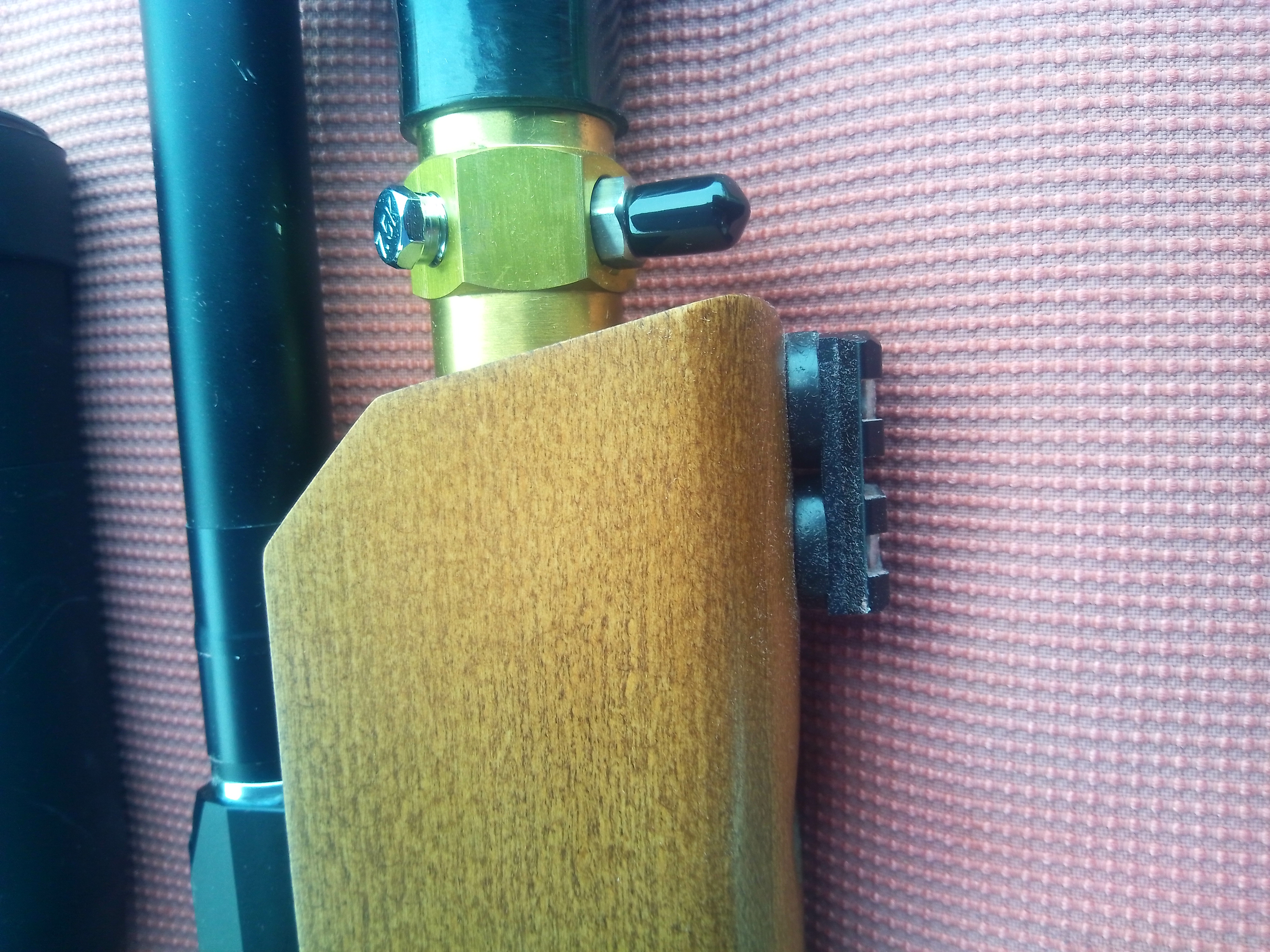

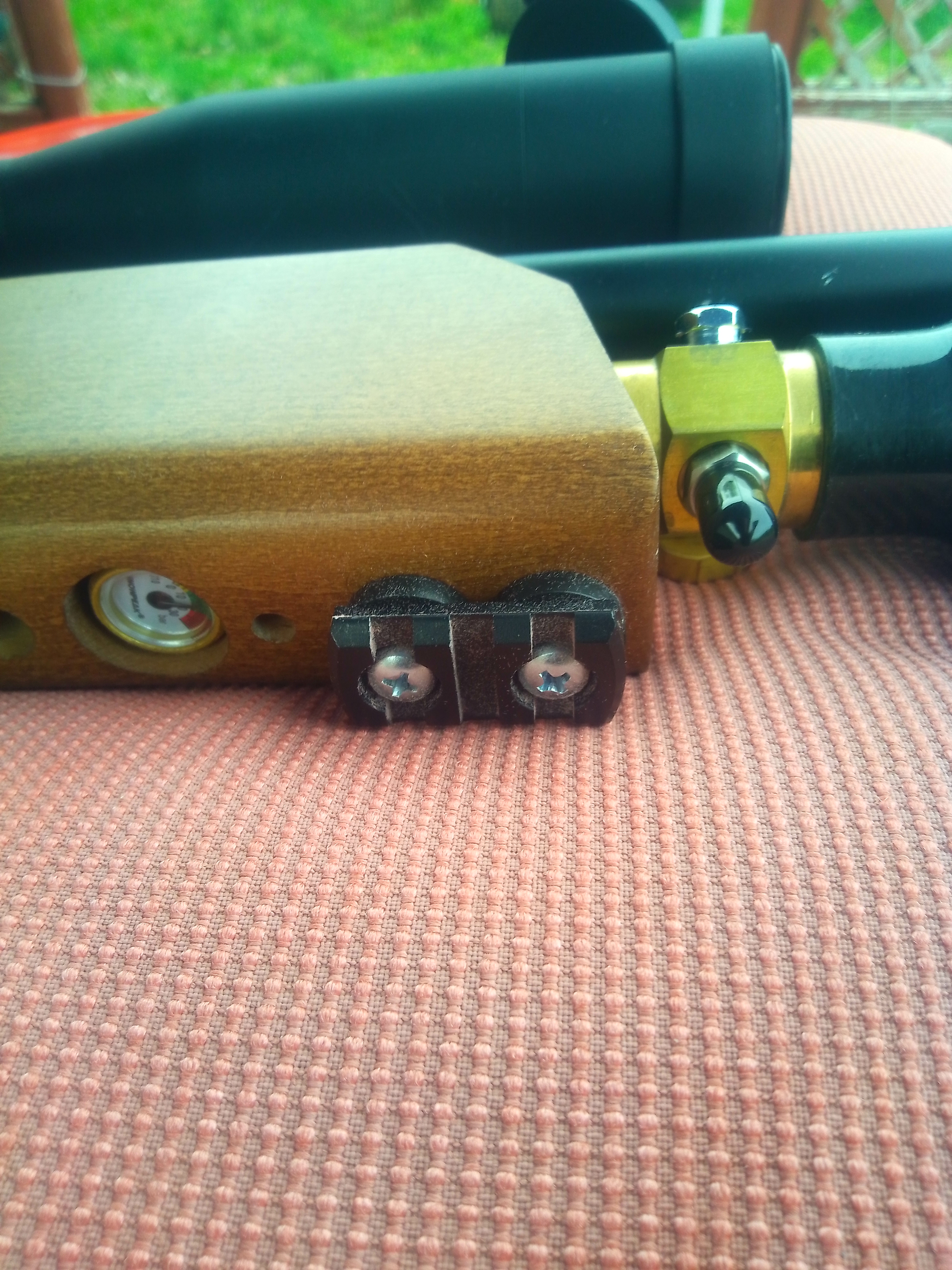

I used the smallest picatinny mount I could find in the package from Amazon. I set the rifle upside down with it propped up on both sides so it would stay in place. There are nubs sticking up on the bottom side of the picatinny mount piece. I mounted it in my vise next and used a Dremel tool to get the nubs off to make smooth so it will mount flat against the rifle stock. Then placed on the front of the rifle and centered. Marked the holes and then drilled both to depth and mounted using two plastic spacers as to not have the mount flat against the wood. Mounted with two screws I had in a kit box to the rifle. Came out ok!

^^^Well that is super, super nice! Laser beam! Looks like dime size accuracy. Like the scope & the high quality rings! With these guns, the scopes sometimes cost more than the gun LOL. I run a Vortex DB 4-16 x 44. Question. Curious how you mounted the bipod base? May consider doing the same
Cheers, Joe

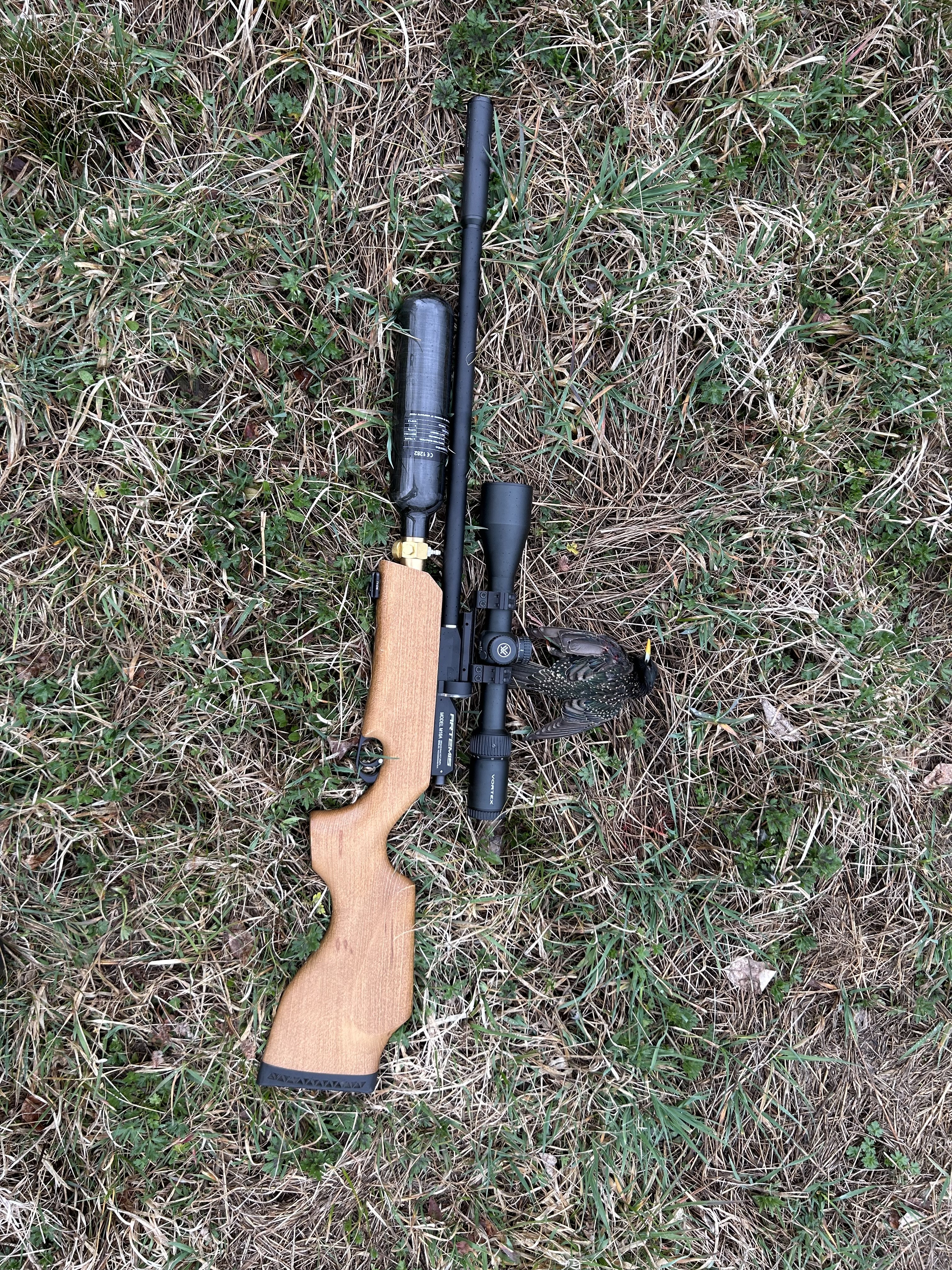

Guess i went a tad overboard on my 25cal one. She´s handing the numbers though and rather accurate at that, still on the stock barrel.
But has she ever had the full 9 thrown at her..
Big things.. little things.
Like that i sawed off like an inch on the bottom of the stock, made it come out looking way more like a "normal" rifle. The god awful plastic goo they´re draped in - off. Nowadays linseed only.
Had about forgotten about this piece until i saw this thread, time to get her out of the vault again me thinks.
Anyways. Yes. As you can see an add on plenum. On 140cc´s if memory serves and tossing 34´s and up she easily surpass 125J and then some.
But there´s many many "flaws" to the M-16 that is to be corrected.
For instance.
Lacks seal between barrel and breech piece on the barrel. There´s simply nothing there, apart from the threads in case.
Lacks any and all seals as far as the shroud, and the stock diffusor in turn.. don´t even get me started. IMO the entire shroud setup needs to be redesigned.
In turn the trigger group, as mentioned above...
Needs a fresh set of springs to balance the thing off way better. Adjuster screw in turn, a drop of superglue. No, not Loctite. Superglue, as that stuff will let you work the screw and still keep it in where it´s supposed to be. See, one major malfunction here is that the adjuster screw works itself lose... Hence the superglue.
But yes. Albeit not a "match trigger" exactly it can be greatly improved upon no doubt.
Porting then. For a regulated 25cal this of course entails opening the transfers, exhaust port and so on up. However.. there´s an issue inherent...
As you go much past 6mm the transfer port will break into the ridge that supports the larger sealing o-ring on the block. This is of course an issue as it´ll let the o-ring collapse and rupture.
So i did the only reasonable thing to remedy and that was to turn a thin shim out of really tough steel.. which i in essence got away with by just compressing the valve assembly harder against said o-ring on assembly.
Might be worth of note though for those so inclined.
The stock reg however has handed me rather specific zero issues. Sure. Took it apart and polished the seat n piston for it and in turn the belleville washers but that being done... works a million bux in my case.
To be noted here though is that that job.. it´s been a while. Point being that where i´m at i could really use a longer barrel for it and in doing so i´d really love a longer Snowpeak one. But.. as we´re all aware they´re about as scarce as hens teeth so..
But yeah. All said with a little effort n elbow grease put in they´re lovely rifles. Will most certainly reposition the plenum tho. Yes, i make my own such and yes i know what i´m doing.
Run an entire machine shop, make them out of seamless high pressure steel tubing..

Used the stock reg pressure gauge hole for inlet. I´ll be looking into this though as i feel getting the add on plenum to reside on the left side of the unit, between the barrel n bottle, would be a way better fit.
Hammer spring, used one for an Impact. These are readily available.
Copper tubing is brazed in place at both ends. To keep in mind is that copper "work hardens" and thus an eye should be kept as far as this. On 9 outer, and seeing the limited diameter that works well.
As power goes up so does need for suppression i guess, why that whole shroud thingy becomes essential at some point. That and a well designed moderator.
No matter what anyone will "claim" moderator efficiency is very very much about baffle and end cap through holes (as is the through hole on the diffusor for the shroud for shroud efficiency). You can run as "special" baffles as you wish, it´ll still take a back seat to them through holes. Internal volume helps though, more n more so as power climbs and speeds start reaching "the wall".
Btw.
Although it "slipped" on the lathe.. that there simply won´t cut it. Way to small openings to be of any practical value.
This is more like it and will make for a way more active diffusor/shroud setup. Now i make them myself but they are to be bought as FX spares.
Keep through hole to a bare min. I tend to set mine approx 0.5mm larger vs caliber.
Notice the o-ring. Make sure the shroud seals at the rear too (which it doesn´t stock)
Btw. Although it "slipped" on the lathe.. that there simply won´t cut it. Way to small openings to be of any practical value.
