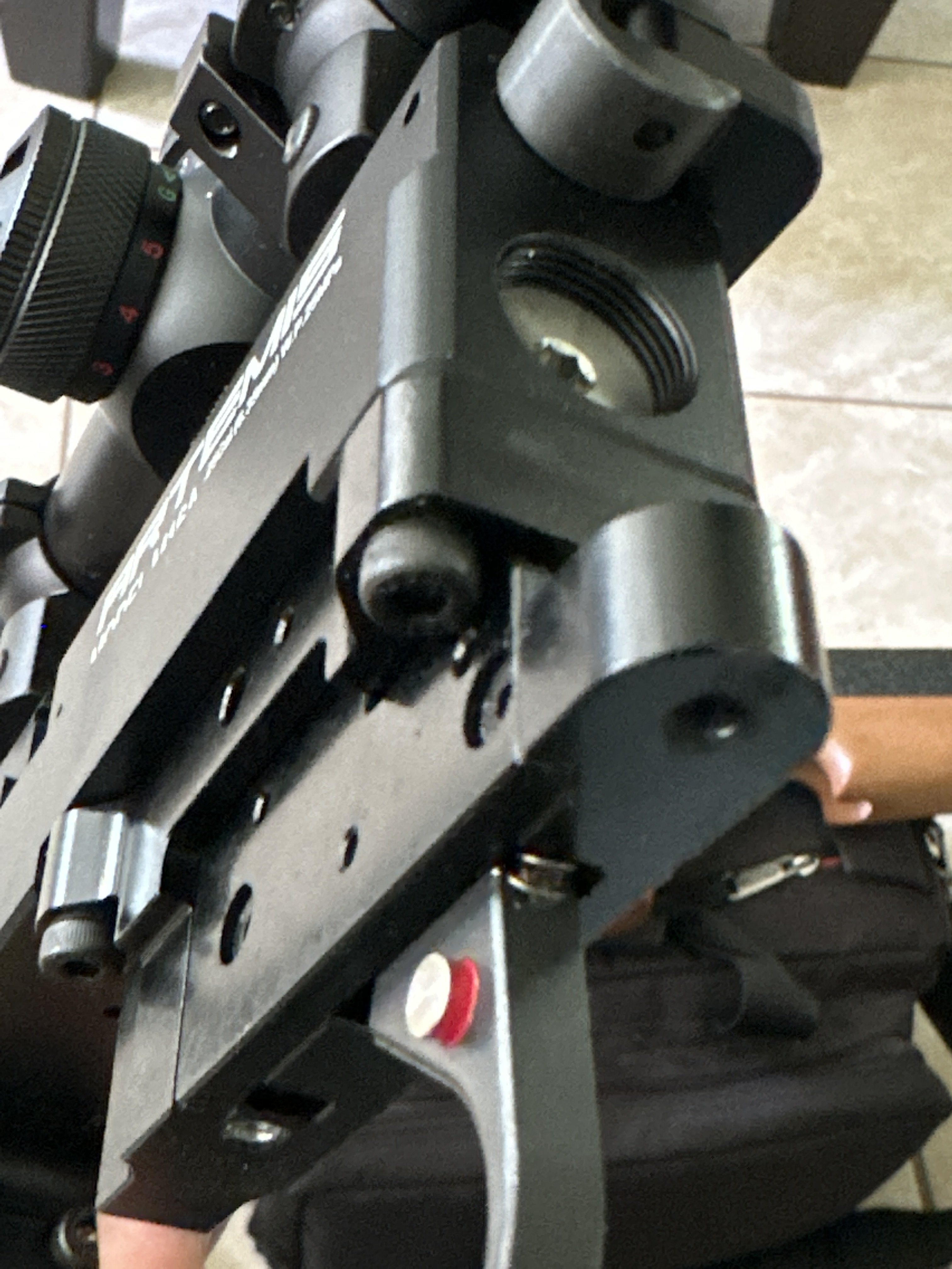

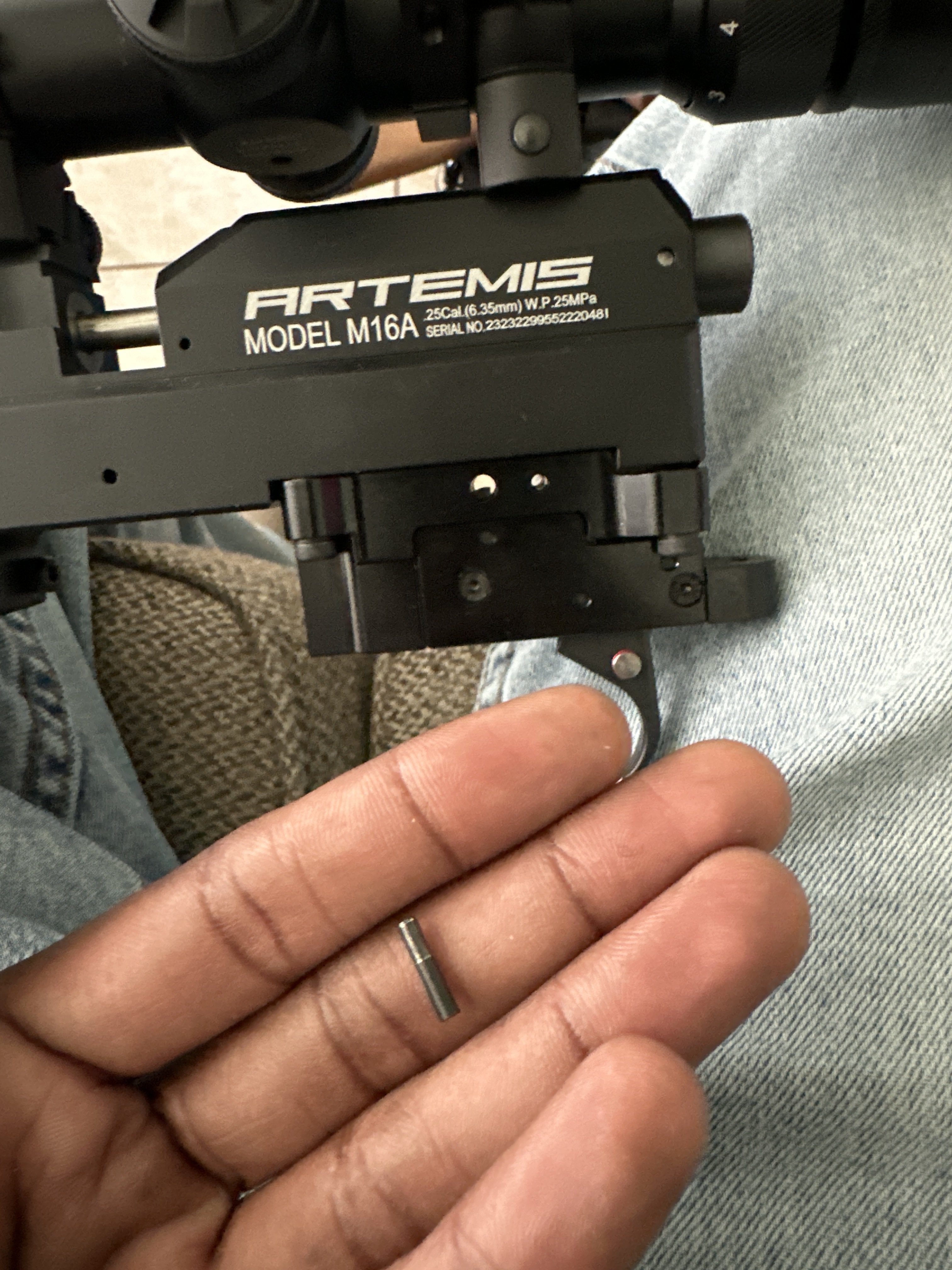

so i notice the silver piece looks all the way in hammer spring adjuster? is that how it should be coming from factory with no tune? also this pin fell out when removing the stock, not sure where it goes just yet

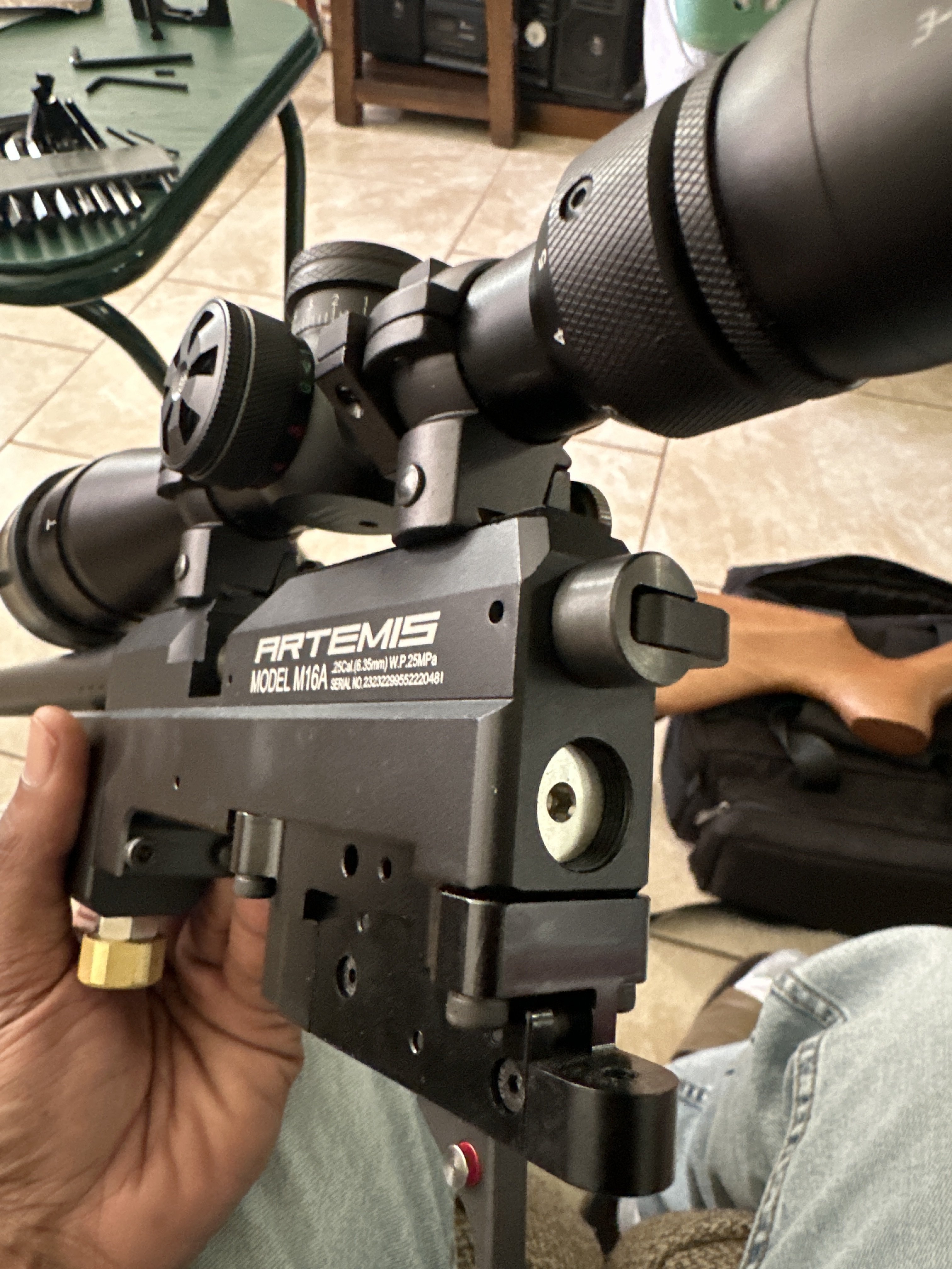

just noticed this too looks like spring is out of place?
The piece we see behind the trigger? She's going to need service if your not comfortable with working on it. Snowpeak is notorious with putting in pins that just are not tight enough to stay in place and just work their way out with every shot cycle. I think Rich at Airgun Revisions fixes them by cutting hardened drill bits and replacing them so they don't wiggle out like the original Snowpeak factory guns. I've got a Stoeger XM1 Ranger 22 made by Snowpeak and though a tack driver the pin by the breach backs out every five clips or so and I have to keep pushing it back in and it requires more than a finger press to move back in place as it's tighter from the factory.

Try loosening the hammer spring. It may have tightened over time. Check to make sure no trigger adjustment screws have moved either and not allowing the sear to reset.
It does look like it's screwed in to it's max. Need to adjust it with a chronograph to get velocity down to 885 or so and leave it there. Then adjust the trigger spring afterwards.

actually just fixed it. i believe the sear spring became dislodged after putting it back she shoots! thank you all for the help! stay blessed and stay shooting!

Simplest way to avoid pins falling out is to put a piece of tape over them on the action. The pin above the trigger is the one that typically falls out on mine. Gaffers tape doesn't leave a residue but packing tape is thinner and you can still see the pin.
