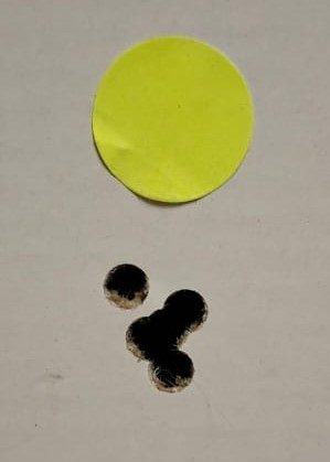

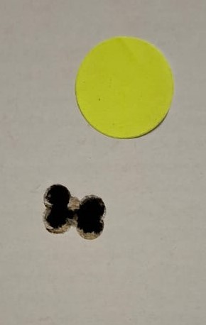

Here is some 5 shot groups I took one evening at about 10 meters. The rifle was zeroed on 25 meters with the Hades.
