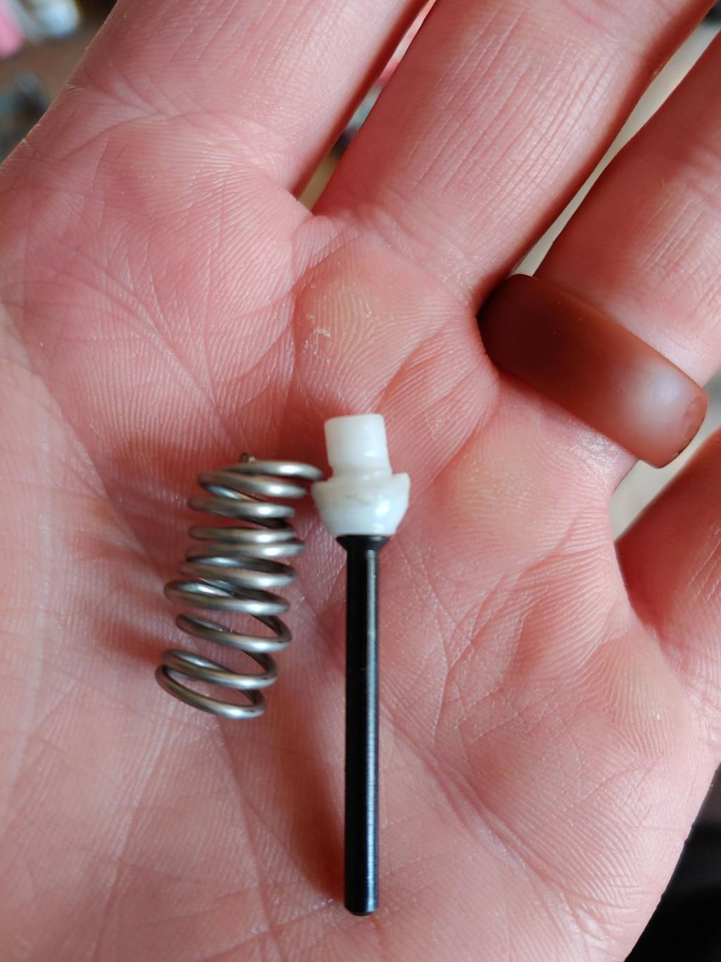

Good morning everyone. I am a stupid gorilla and ruined my .25 poppet and poppet spring yesterday when trying to install the Xtreme XL plenum. I am hoping to find someone in the states that has spare parts or can make a new poppet valve for me. The only place I've found with available parts is in Greece and they want 50 euros to ship for $5 worth of parts. You can see in the pic how dumb I am. Please don't make me feel worse lol. I have searched all over for spares, and asked on FB and other groups with no success. Help me Obi Wan Kenobi; you're my only hope.

I don’t want to give you a hard time about it but I would love to know how that happened.

Well, the plenum was assembled when I received it. There is a piece on the new plenum that looks JUST LIKE the stock plenum (circled in red). Where the spring sits, the new plenum had a smaller I.D. I simply thought that I was battling heavy spring tension and forced it to go together. Like I said, I am dumb lol.
I did email the guys in the UK. They want 20GBP for the poppet and 24GBP for shipping, and they do not have the spring in stock. I did think about trying to make a poppet from PEEK using my dremel and sandpaper. However, I have never done something like that, and seeing my track record here, think it could be a risk lol.

In a regulated system, you can get by with a weaker valve spring. It won’t make a significant difference in how hard it is to knock open the valve (how much hammer spring tension is needed) but it does affect valve dwell....the weaker spring allowing more dwell which could be a good thing for shooting slugs. However most OEM PCPs will easily deliver too much dwell so by no means is it a must-do.
The valve spring plays a much more important role in an unregulated PCP. Using a weak valve spring will give a narrow bell curve.

Yeah I don’t advise tackling a PEEK poppet with caveman tools unless you are very patient and supremely confident in your skills. It can be a humbling material...the slightest imperfection and it will leak. It’s quite possible with hand tools if you can fashion a lapping jig to help shape the sealing face, and then do a final lapping run in the valve to bring the surfaces into a perfect mate. For the first-timer, a simple cylindrical poppet is a better place to cut your teeth. A tapered poppet will prove more challenging.
Dang, thank you for helping me learn here! I wondered about the taper on this poppet being a pain to shape. I like your "caveman tool" remark. That's exactly what it would have to be at this point lol. Would delrin be easier with my hack tools? I am only asking to learn.
Yes Delrin or acetal is much more forgiving of slight imperfections. PET-P (e.g. Ertalyte) is another good material for DIY poppets.
Here’s a thought...you could make a simple cylindrical poppet and let it seal along the outside rim against the tapered wall of the valve. That will concentrate the force on a small ring of poppet material so it will compress and help form a seal despite any minor surface imperfections. Note the important part here will be to ensure the poppet OD is made concentric to the stem. If the stem is off-center, the rim of the poppet will not meet with the valve properly. If off by too much, it won’t seal at all. If off by just a smidge, it may seal but the stem will be in a bind.

Winding a spring from music wire isn’t that difficult but I’ve only done common compression and torsion springs. Never tried making a conical.
