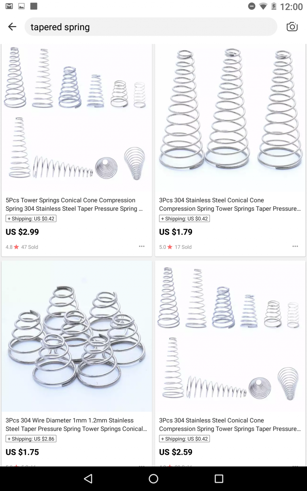

Does this help any ? UP 9 Store on Aliexpress.

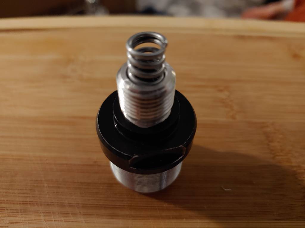

I need to get a picture to add but, I was able to find a spring that I *think* will work. It's still tight in the Xtremes bore; however, I think a little lapping compound would clean that up just enough. I will get a pic after work this afternoon. The spring was $1.29 before WA's cut. Not bad. I plan to see if I can clean up my munged up poppet enough to seal, at least until my new one shows up from the UK. My new LW barrel should also be here today, then, out goes the gun to A.E. Swede for machining. I'm really excited and nervous about that lol.Ā

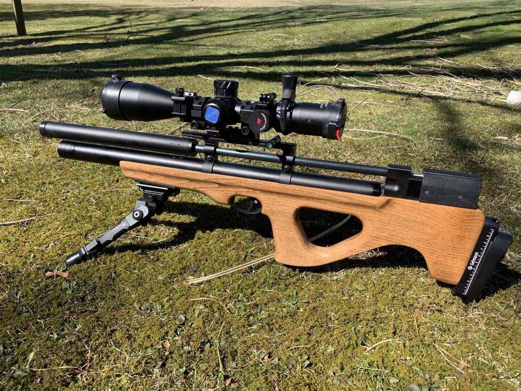

When I built my P15, I experimented with different weight poppet return springs. Because the gun wasnā€™t a FX, I didnā€™t talk about the project much on this forum. Me and several guys over at GTA really went at these guns trying to get them performing with the good bullpups. One guy even experimented with a Cobra valve in his. What Iā€™m getting to is I saw no gains with a lighter or no spring in my P15. It may have been a half step forward in velocity but 3 steps back with my ES. The stock spring felt very heavy to me but it keeps my ES around 5fps over 36 shots. The bottom line with the P15 is this. With whatā€™s done to my gun, if I would have went a couple inches longer with my TJ barrel, it would be able to push slugs easily where they should be. But the gun would look dumb and not be the neat light little gun that originally attracted me to it. Unfortunately it will always be a Chinagun so as you start to lean on it harder, other things break. My gun was good for a year with conservative shooting but I think my poppet finally gave up the ghost last week when I put some maintenance shots through it. The 150b reg setting finally caught up with another substandard China part. I will probably make one out of peek this winter.
How long did you make your barrel? I plan on 20in but have thought about 24in. You're right that it would probably ruin the look and feel of it.Ā

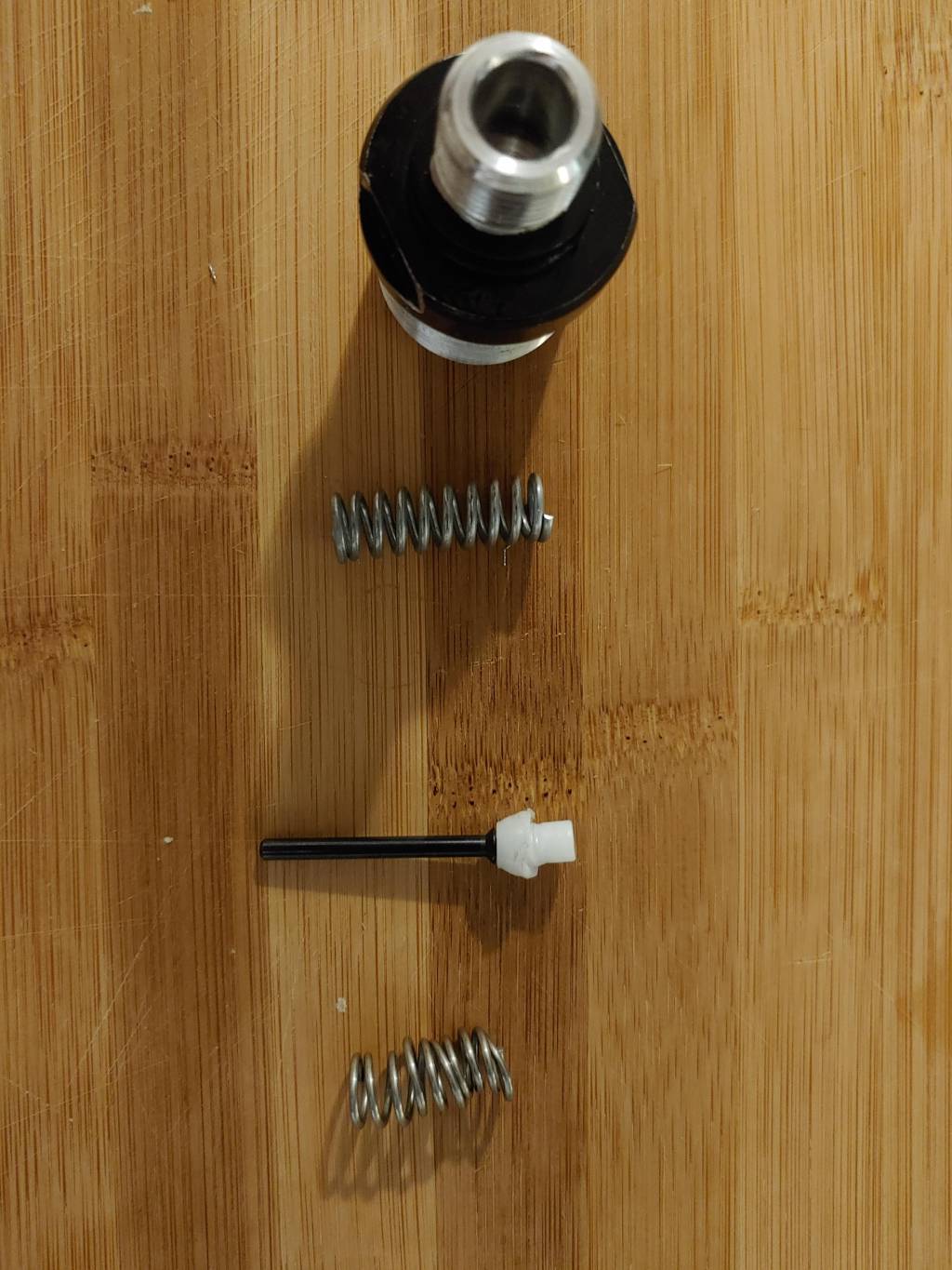

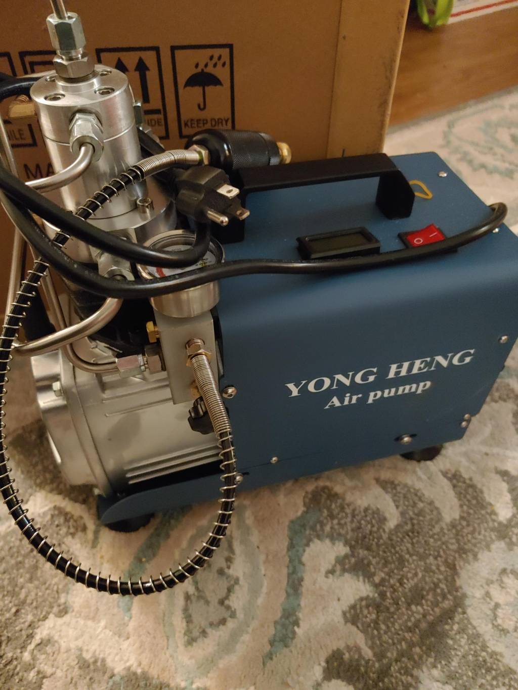

So I promised pics. I was going to tinker with it but am impromptu night with kiddo caused different priorities. I managed to get pics of the springs, poppet, and the Xtreme spring housing. Oh, and I got my Yong Heng! Now I need a weekend that's not filled with work or kids with short attention spans lol.
A member on the Artemis FB group sent me pics of his spring with him measuring with calipers. With that info I was able to find a usable spring. Hopefully it's about the correct weight. I'll have to use lapping compound in the new spring seat as it's just every so tight. No big deal. I'll post more pics when I get a chance!Ā
My TJ barrel is 1 inch longer than stock. I am Pelletjunkie over on GTA so if you ever get bored you can search back to when we were banging our heads on the wall with these guns. Adding one inch didnā€™t change the balance and the gun is still a tight package. I hate silencers so I have a functioning shroud and my .25 shooting 900+fps is silent. Just goes ā€œtinkā€ when I shoot it.
What work did you do to the shroud? I hate the look of silencers on these pups.
