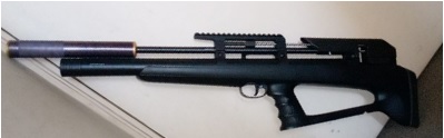

I like the look on my P35 with an after market silencer...besides, its easy to put out, so it can be transported in a backpack...in reality a snowshoes backpack.

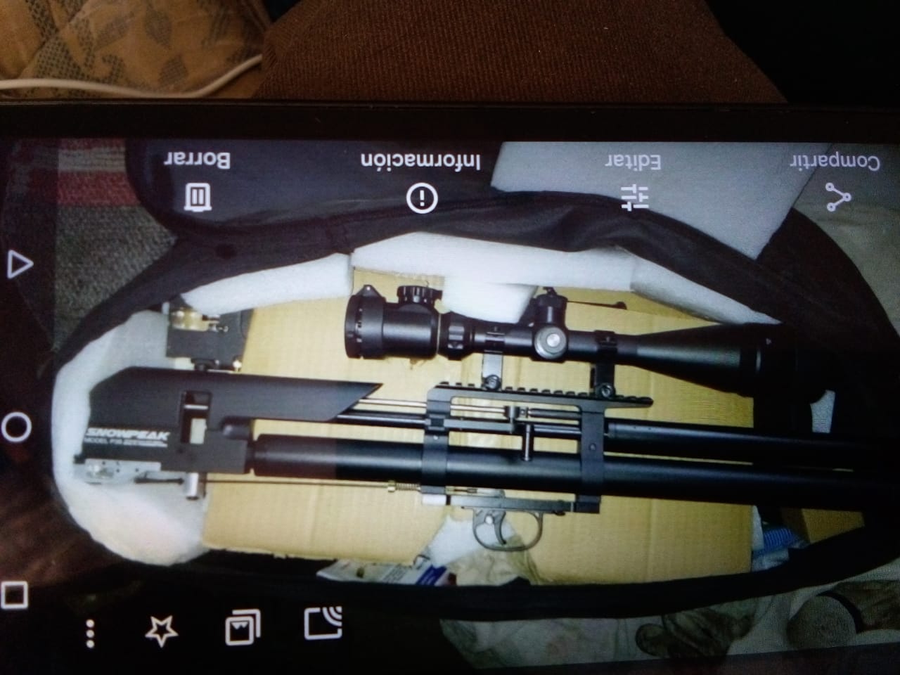

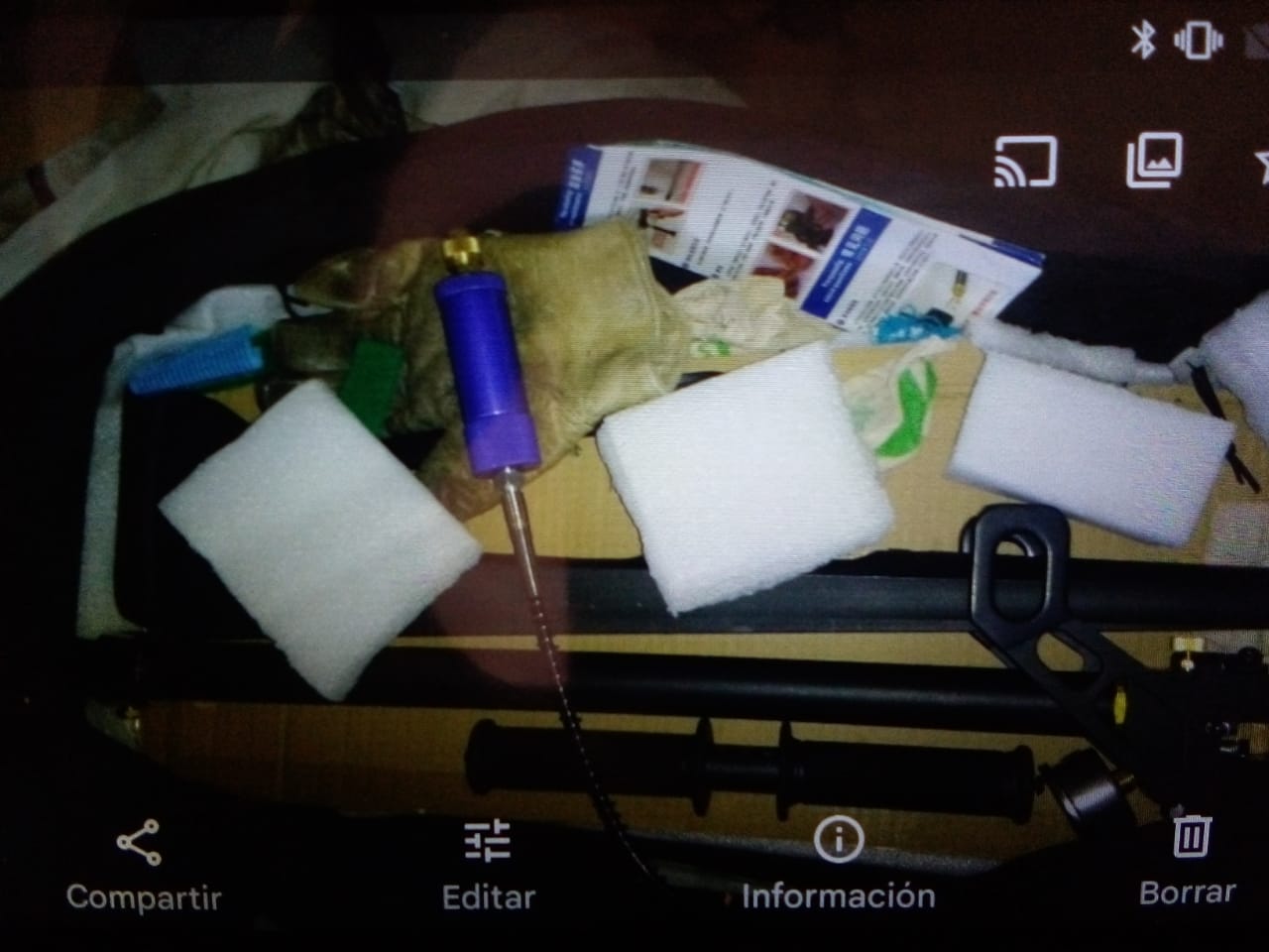

First I dismounted the stock from the rifle, and the handle from the manual pump. These are in the "first level", then a corrugated carton nad over it the barrel and air tank+sight. all of this protected with 1" planks of closed cell foam. With a pair of 250, 5,5mm pellets can weighs a total of 8 kilos/17,6 pounds.

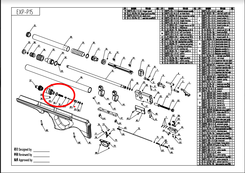

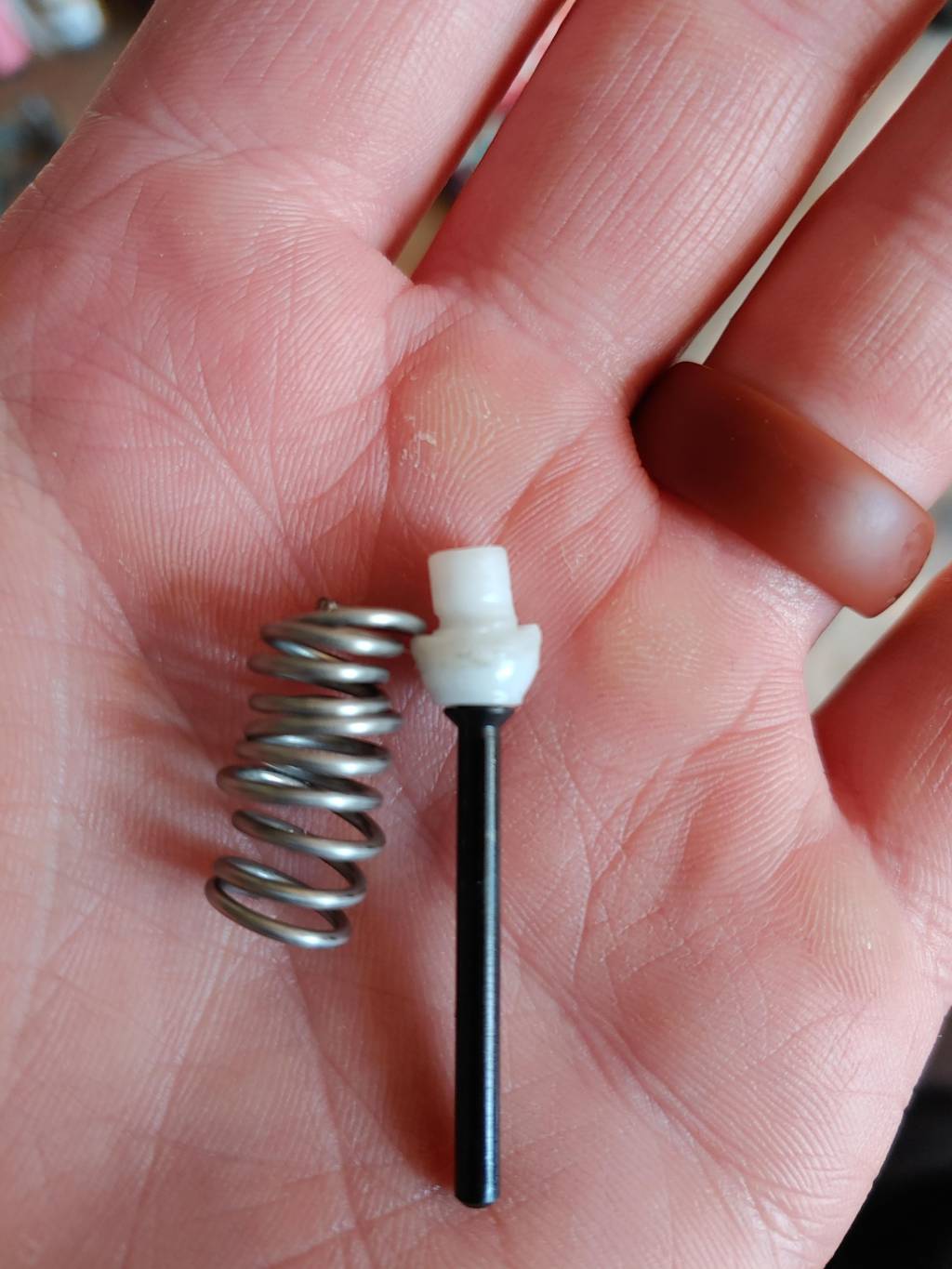

Well, the plenum was assembled when I received it. There is a piece on the new plenum that looks JUST LIKE the stock plenum (circled in red). Where the spring sits, the new plenum had a smaller I.D. I simply thought that I was battling heavy spring tension and forced it to go together. Like I said, I am dumb lol.

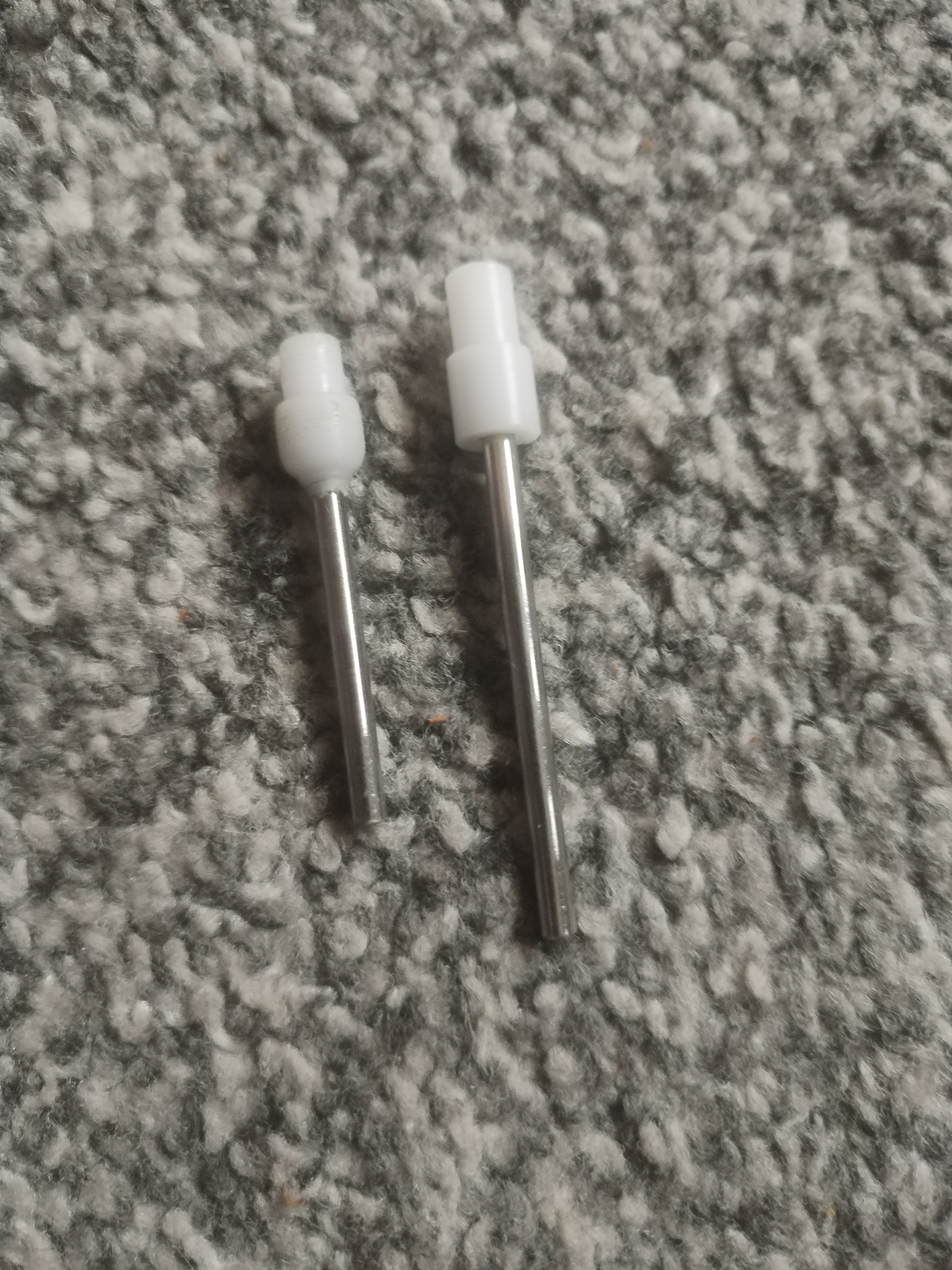

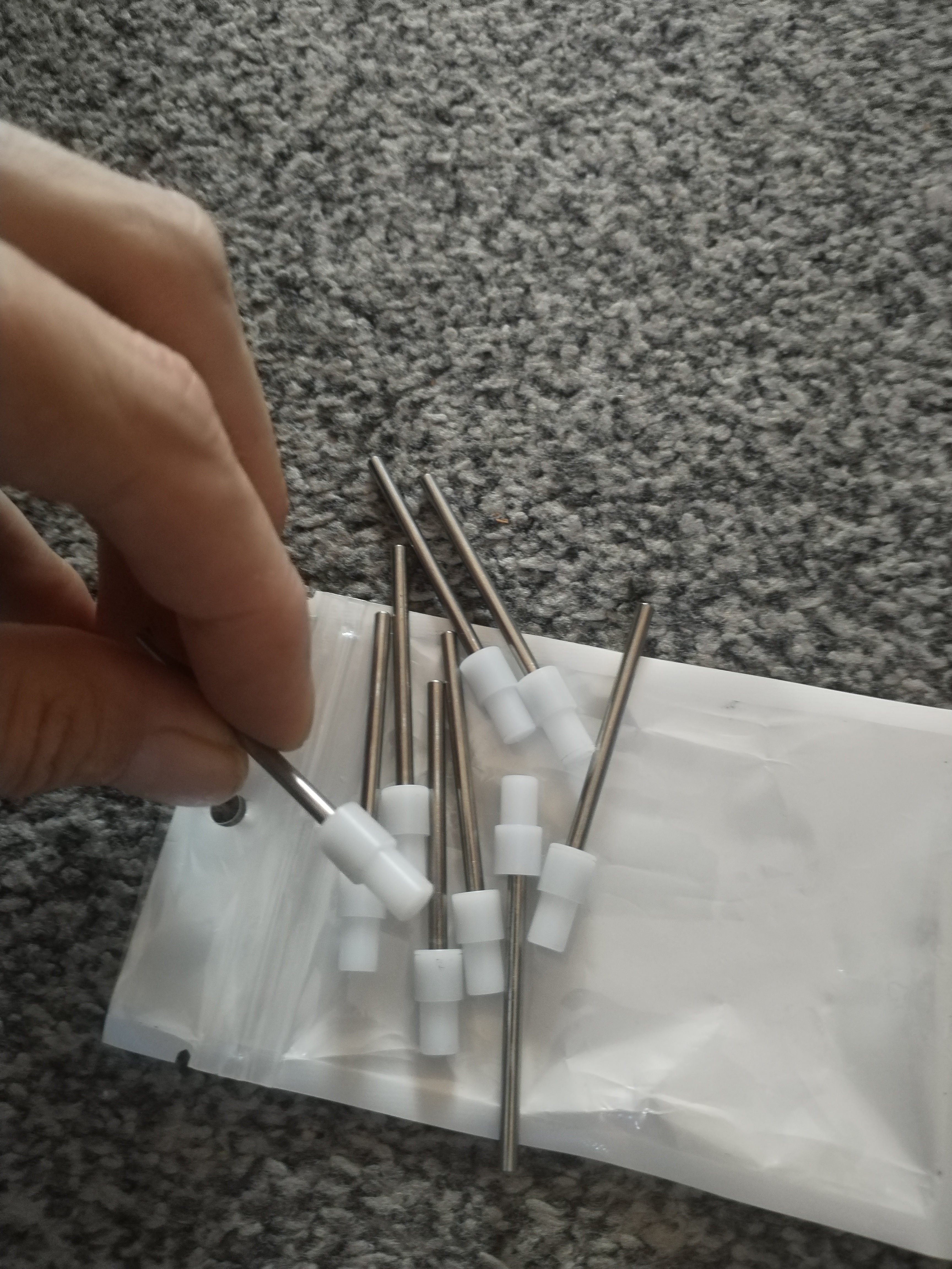

I did email the guys in the UK. They want 20GBP for the poppet and 24GBP for shipping, and they do not have the spring in stock. I did think about trying to make a poppet from PEEK using my dremel and sandpaper. However, I have never done something like that, and seeing my track record here, think it could be a risk lol.
I need this full diagram. How could i get this?
