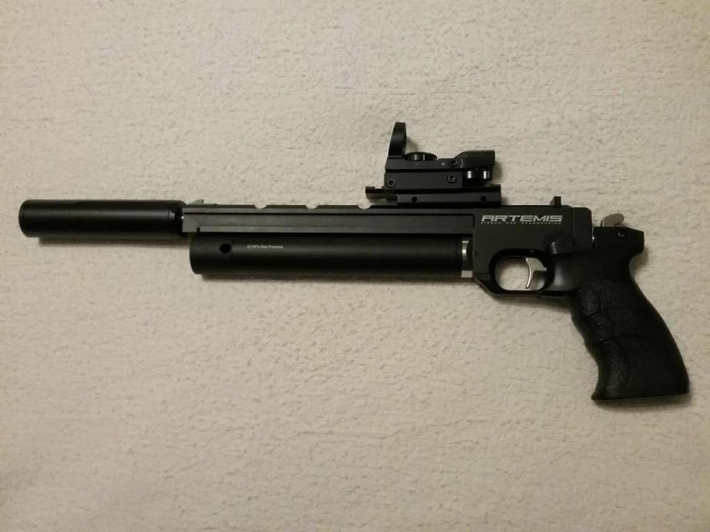

Thank you for the info
I have a Donnyfl Sumo on my Taipan 22 and is very quite.
How ever I would prefer to be able to use the iron sights with the can on. I would rather shoot off hand not rested on anything.

I just installed a DonnyFL KOI because of its smaller diameter and it is very quiet.
can you still use the open sights with it ?
You cannot use the open sights with or without any silencer. The rear sight is not adjustable in elevation and the sight line is exactly parallel to the barrel, so you are always going to be low. I think I told you that the original open sights are useless and any moderator will neither help nor hurt this issue.
Simple fix even if that is the case-remove a bit from the top of the front sight. Instant elevation increase. I long ago fitted an adjustable rear sight and made a replacement taller front sight to work with that taller rear sight for my pp700 and that setup does work with the airgununiverse unit. I believe it would work with the smaller diameter DonnyFL units. With the stock sights, neither unit would probably work well or would be barely able to see over LDC.
I don't have a way to post pictures at this time. Right at this moment I can't even remember exactly where I got it (it's been on for several years now) but I did have to hand fit it with extensive work so it isn't for everyone. I ended up cutting a new larger dovetail in the rail just in front of the stock dovetail to fit the wider sight. I don't think there is one available that "fits" without work. This setup functions very well for me but I am very much a function over form type. I'll see if I can find the sight online again and will post if I find it.
Found it-this is the unit I have on my pp700. As you can probably see, the dovetail base of this sight is quite a lot wider than the stock rear dovetail thus the need to fit it by hand. I'm sure a good gunsmith could cut a very precise dovetail of the proper size for you but I did it by hand. Note that it has 2 screws in the base to secure the sight in the dovetail so it can be solid even if the dovetail is a bit "off"😁.

That is COOL man. I’ll give it a try with the dremel and some files, if I ef it up I still have the scope lol. Thanks for the info
That was my approach as well. I use that sight under a scope with see through mounts-opens for close range and scope for further out. I placed the new dovetail in front of the factory one so that the existing factory one could still be used but the length of the sight places it back over the factory dovetail anyway when placed. Measure carefully, start small, and gradually increase size until it fits in. A slight tap fit is good but the 2 screws will hold the sight in place even if it isn't a snug fit. Hope it works well for you.
