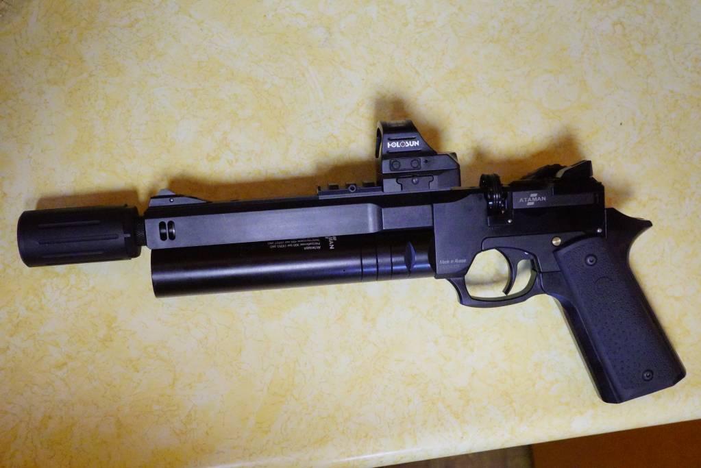

Use the same Huma Mod 30 suppressor, as shown below.

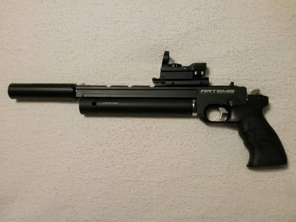

The pp700sa has a pretty loud bark without one. I had a DonnyFl Tanto on mine. Which made it very quiet.
I have his pp700sa 22cal.. he was kind enough to sell it to me when pistol was all i had room/ use for... with the tanto it is perfect... very neighbor friendly if you are in semi urban/ urban area. Excellent shot count too. Started running slugs in mine...
