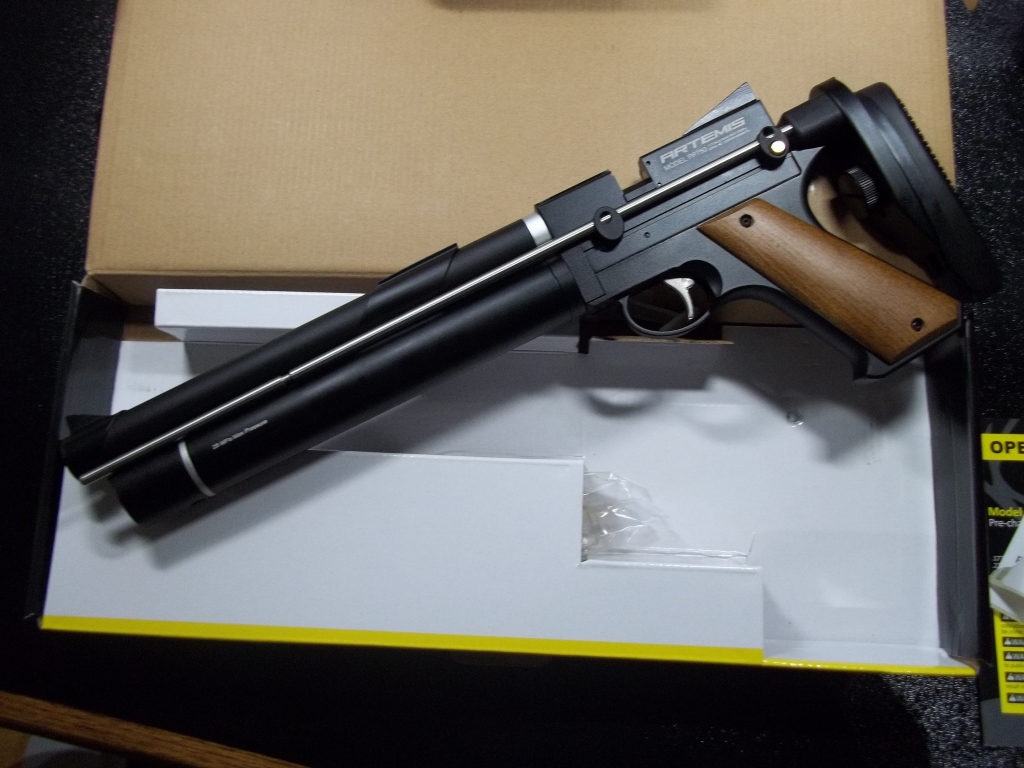

Artemis PP 750 It's Here
Big brown truck just showed up.....Just unboxed it....I'm Impressed
I haven't even filled it yet.....It's a .177.....will try to spend some time on it tonight

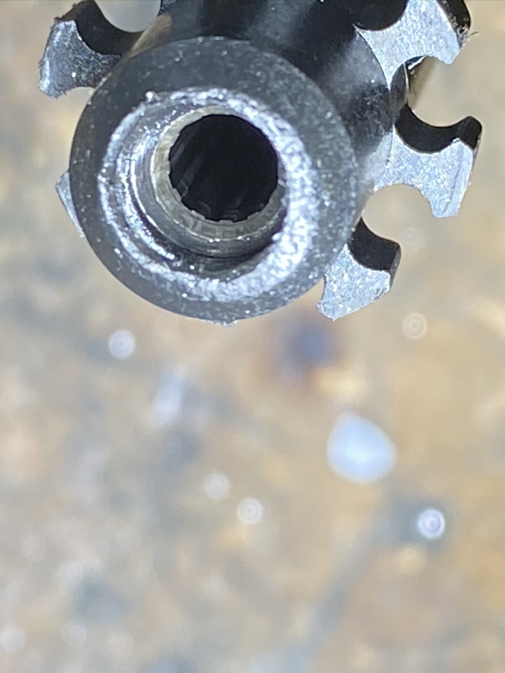

I have put a few hundred pellets through my PP750. Barrel crown was a bit rough and scoring on the last 3mm of lands, with a light choke. Turned off the scoring and re-crowned, polished with some borebright and its now making sub 3/8" five shot groups at 25 yards with many pellets JSB 8.4 , JSB RS, JSB Heavy, HN Sniper Magnum, HN FTT, HN Terminator... so not pellet picky at all now.

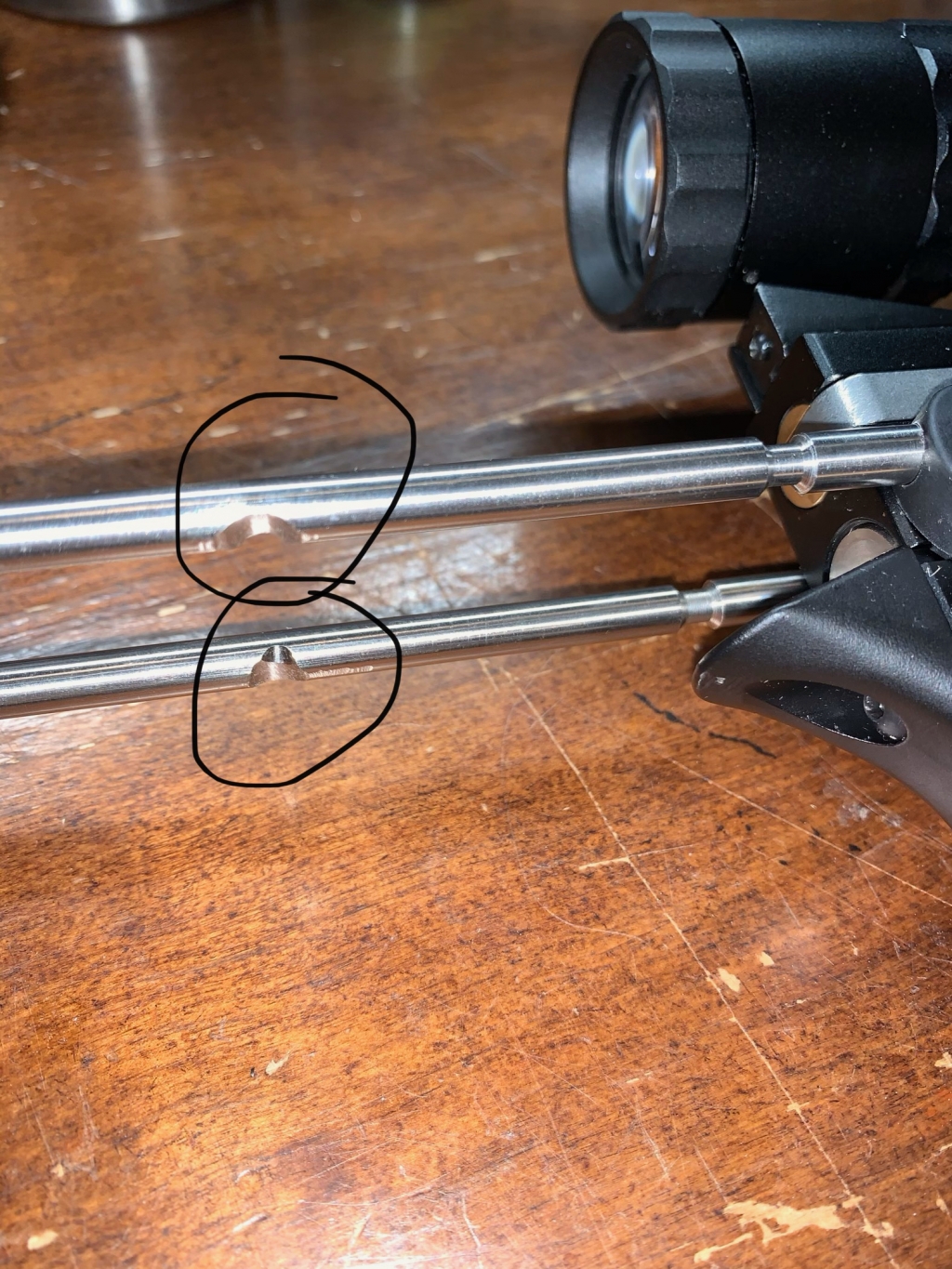

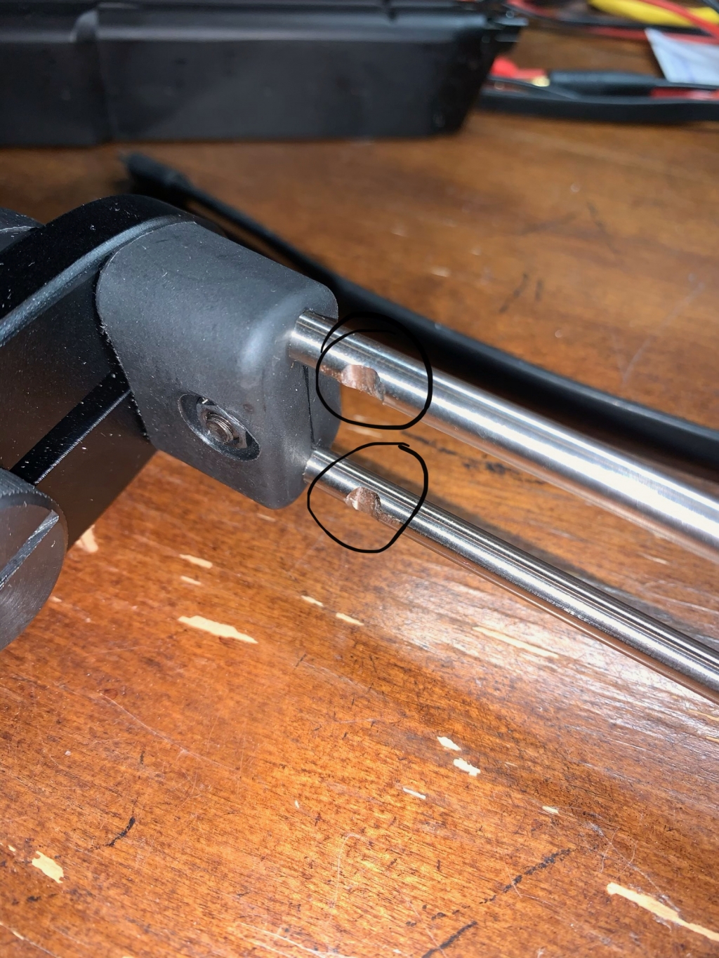

It bothers me that the stock doesn't lock into position when closed and I wanted to reduce the LOP by about 2 - 2.5". I few minutes with a Dremel:

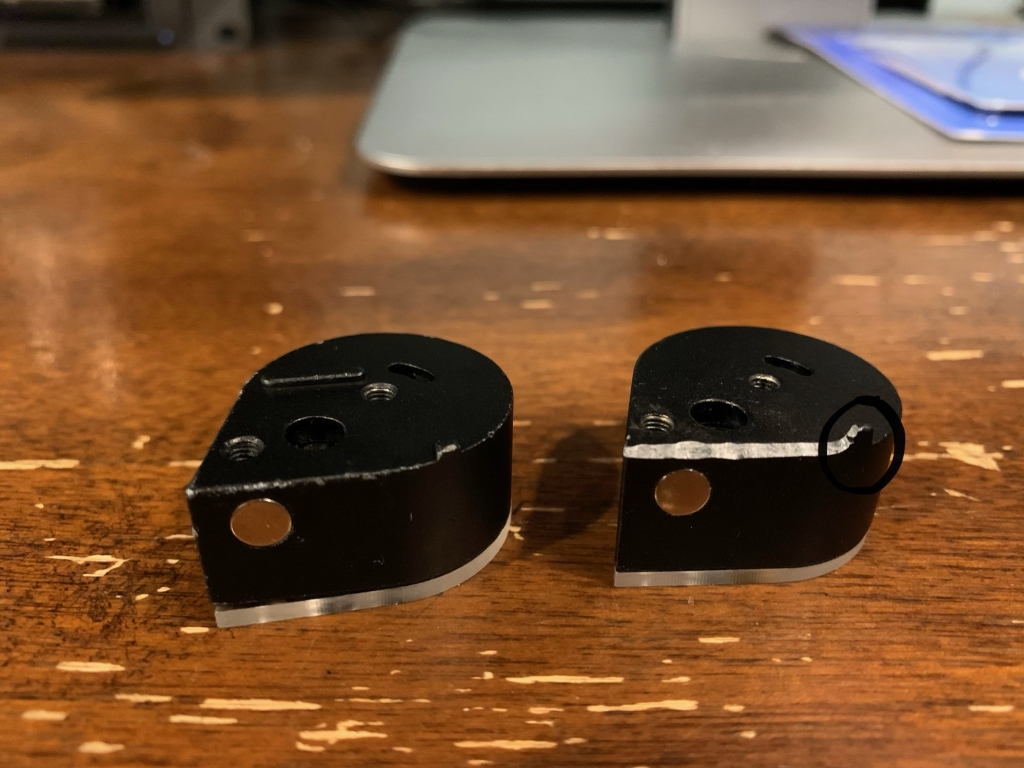

I also had a bunch of .177 mags from my Diana Chaser that I was thinking "Hey, these will work with Artemis too!". Yeah, that's a big nope there. Same freakin magazine but different cuts on the back. Again, enter the Dremel. If you do this just remember to keep a small nub to stop the mag from going in further - the magnet hold it's in place plenty fine.
