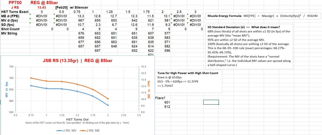

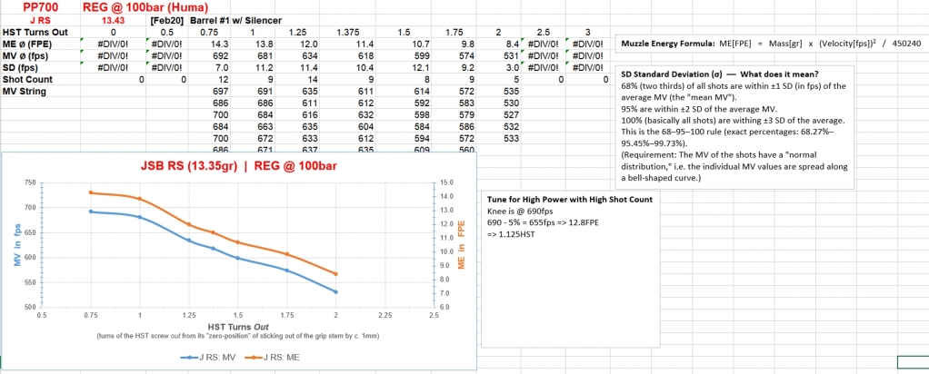

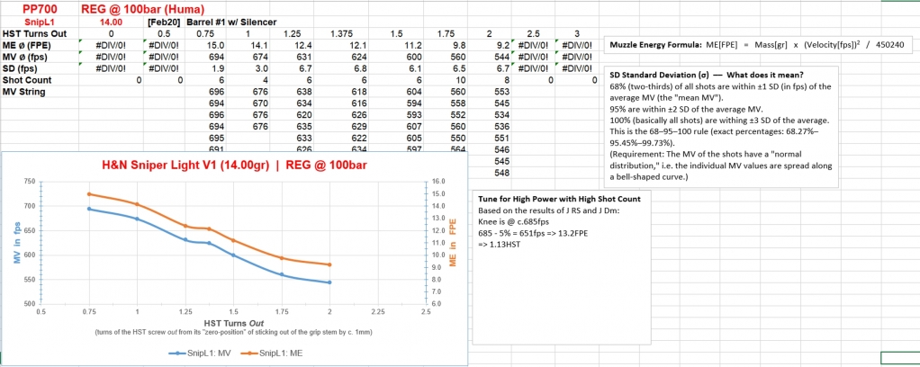

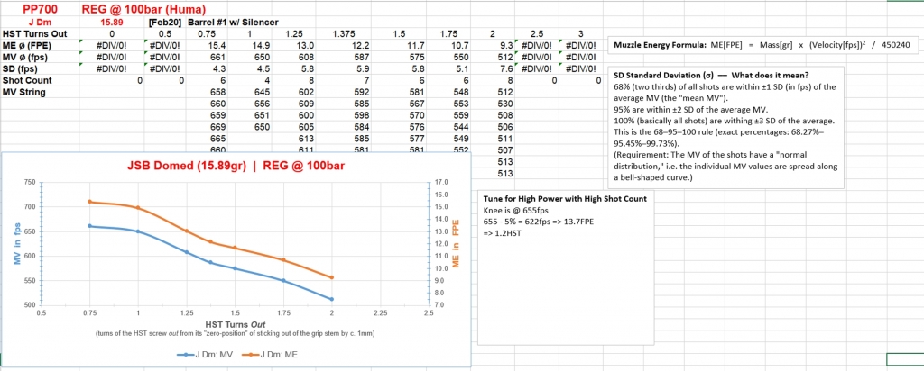

🔶Power Tuning with the Huma Regulator at 100 bar – Shot Strings with Different HST Settings – 4 Different Pellets
Huma regulator set to 100bar
Hammer spring tensioner (HST) adjusted from its "zero" position which I defined as sticking out of the pistol grip stem by c. 1mm
Pellets (in this order): JSB RS | H&N Sniper Light V.1 | JSB Express | JSB Domed (16gr)
Wayne52 gets 16FPE – out of the box – just adjusting the OEM regulator and the HST (16 and 18gr JSBs). It does get quite a bit louder when going higher in power.
https://www.gatewaytoairguns.org/GTA/index.php?topic=121844.msg1240715#msg1240715
With the Huma regulator set to 150 bar, and the HST still about 2-3mm out, I got almost 18FPE with the light JSB Express. What a beast of a pistol!! 😄

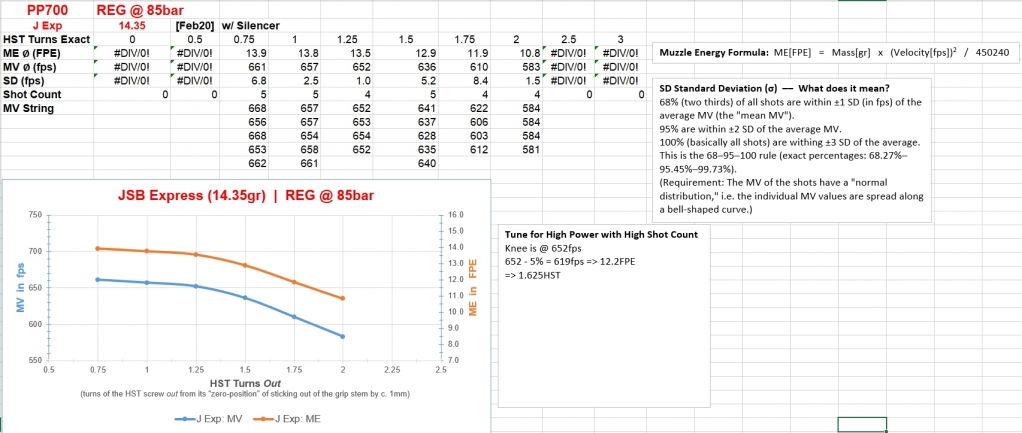

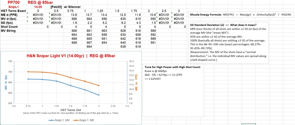

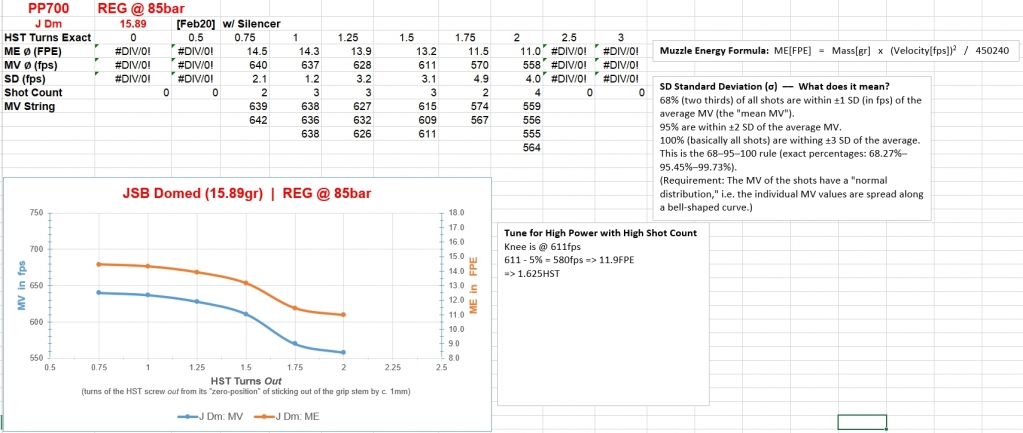

🔶Power Tuning with the Huma Regulator at 85 bar – Shot Strings with Different HST Settings – 4 Different Pellets
Huma regulator set to 85bar. This is the lowest setting on the Huma. I was surprised to still get so much power!
