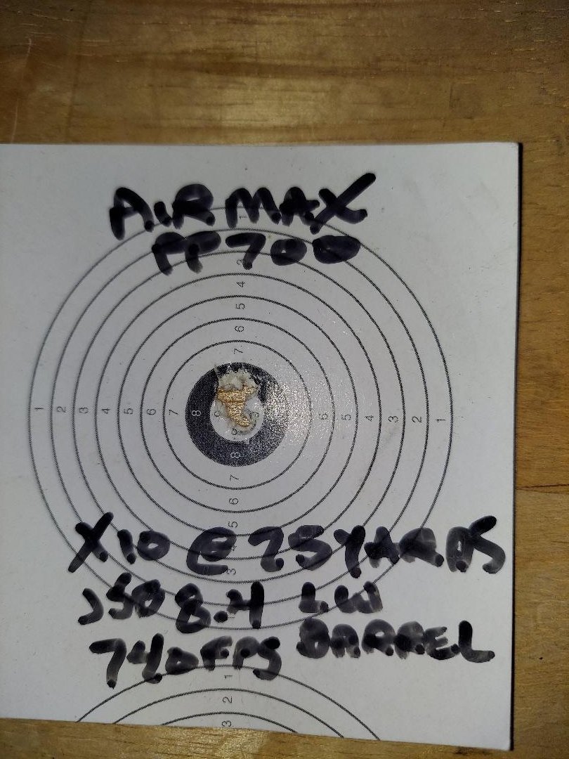

10-shot group at 30y:

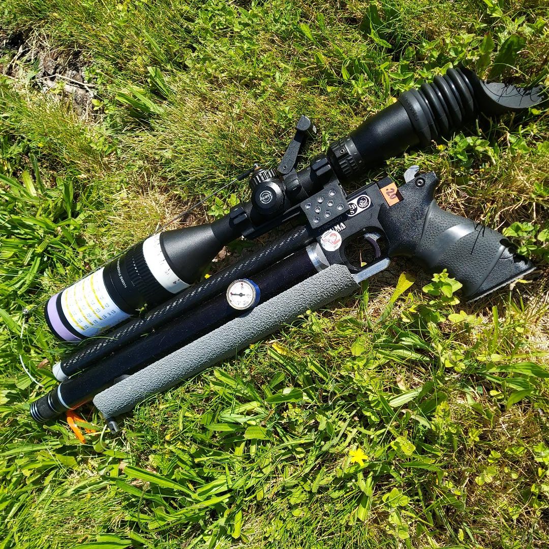

Where did you get the extra long air tube?
Cobbled it together myself using a shorty piece of Aluminum Marauder air tube & fill end, Machined the breech end to screw onto the male OEM spigot of Reg ( OEM Reg gutted and bypassed )
A definite one off modification :oops:
As built in .20 cal at 15" it shoots a JSB 13.73 @ 800 fps for > 20 fpe getting @ 45 shots
Brilliant! Indeed it is one off.

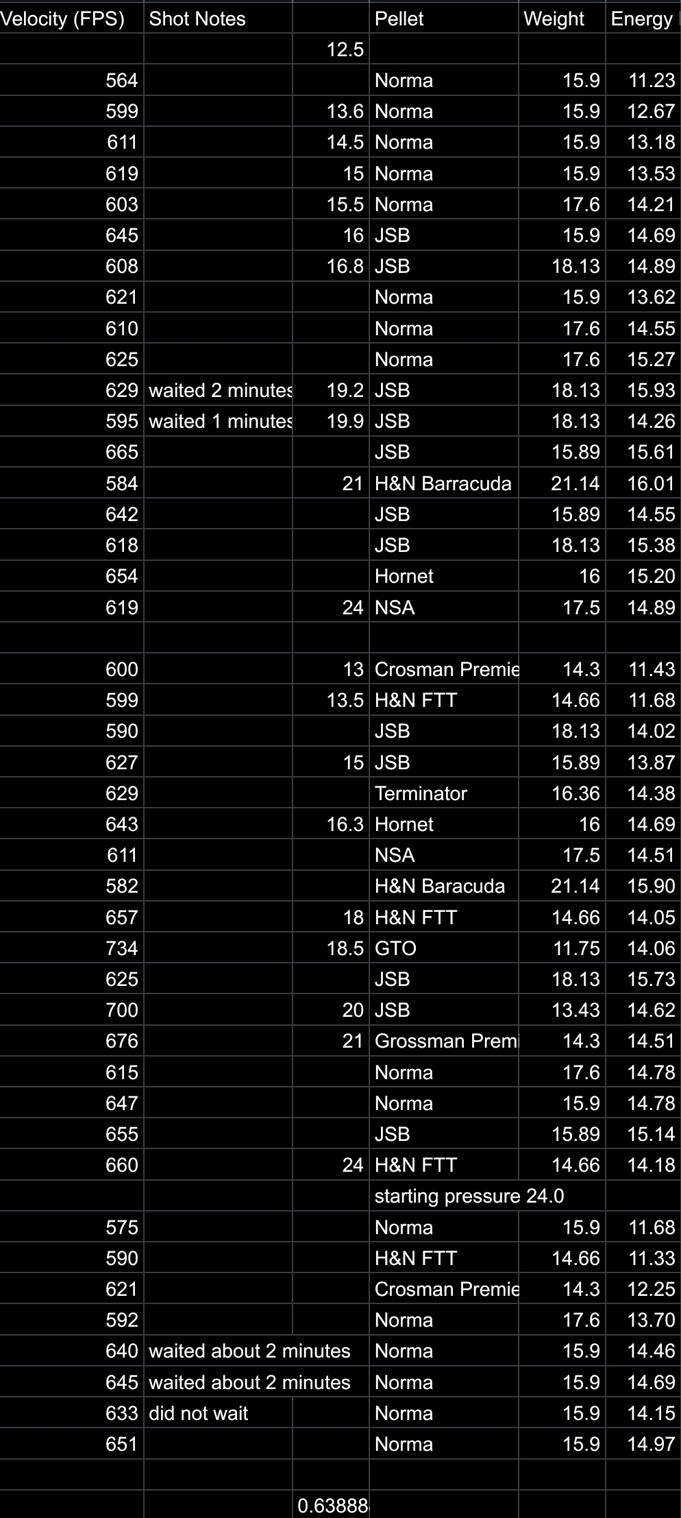

Continuing about my PP700 with Huma Regulator.
Regulator is set at 125 bar. However, the speed starts to dropoff at 160bar. Also it is necessary to wait for 2 minutes between the shots, otherwise the speed will be lower.
The heavier weight pellet tend to have more energy, JSB is more energy than other brands.
I am debating which pellet should I stick with for the current setting. Seems JSB 18.13gr to be a good compromise between speed vs energy. Any thoughts?
