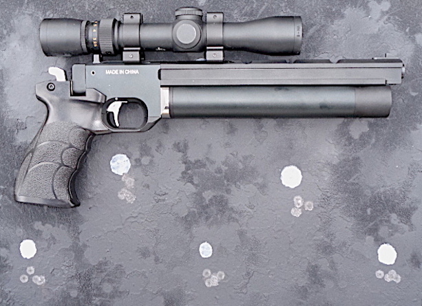

The book pictured below has a chapter on a .22 (MRodAir branded) PP 700, and another chapter titled Air Pistol Sights, Insights and Incites. As excerpted from the PP 700 chapter, "Five consecutive five-shot groups at 35 yards with 16 grain AA averaged .70” c-t-c." BTW 16 grain AA pellets are JSBs.
Those aiming dots shot at 35 yards are the size of dimes and quarters-

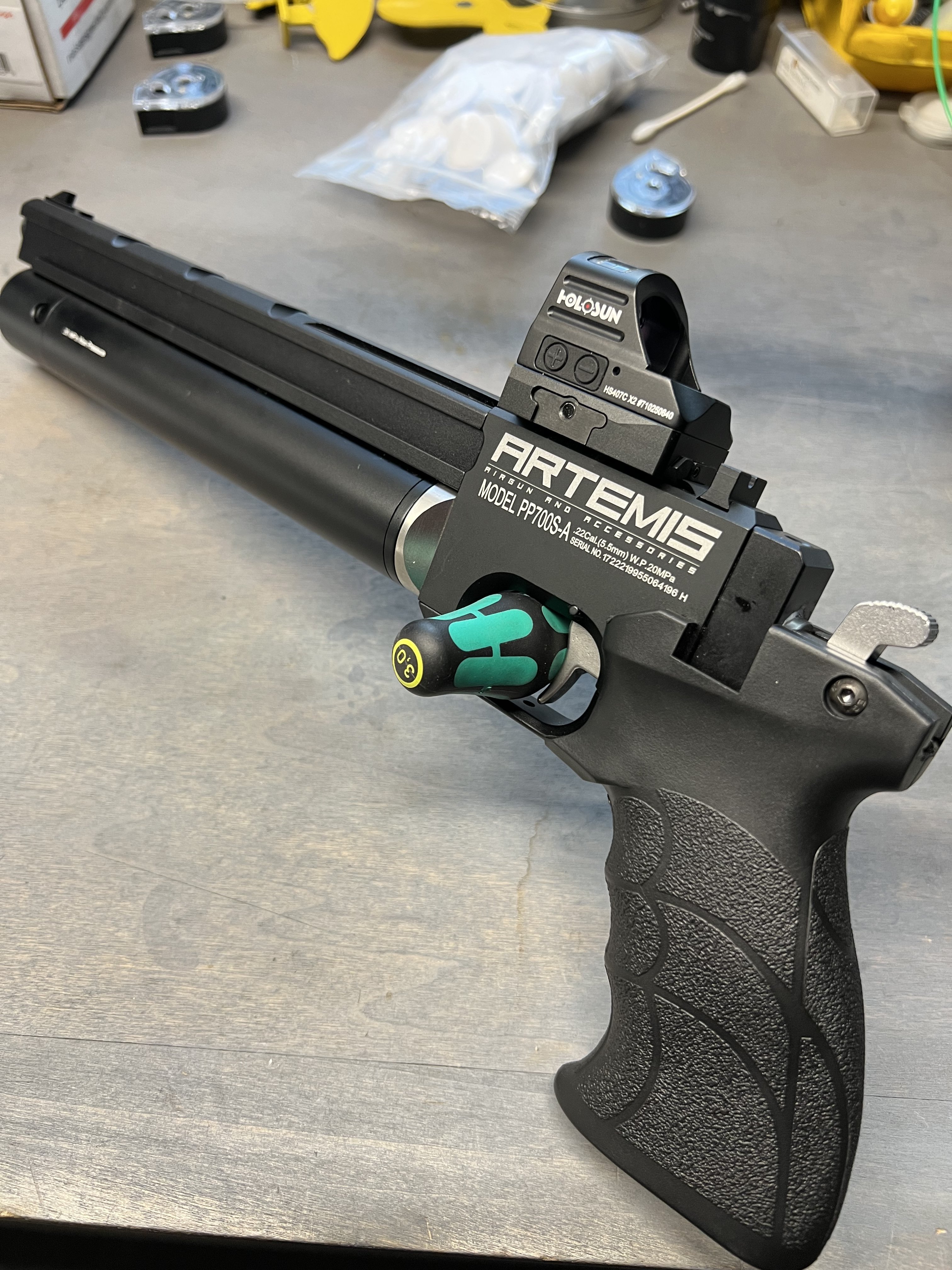

Take a look at Holosun, Swampfox (new brand), Vortex.
Unfortunately, most of the time, you get what you pay for here. After buying MANY...different reflex sights, I've become partial to the Holosun brand. You get a lot for a fair price. Although, they do have more expensive sights, their more inexpensive sights work well also.
The Holosun, was the first to offer solar cells to the top of their sights. This allows the sight to continue to be used if the battery fails, (as long as there is ambient light). 50,000 hr's. of use is what, about 5 years I think. Plus they are also the first to design the "shake-awake" system. Where you just leave the sight turned on, it shuts off after a period of time, then turns on as soon as you pick up the gun again.

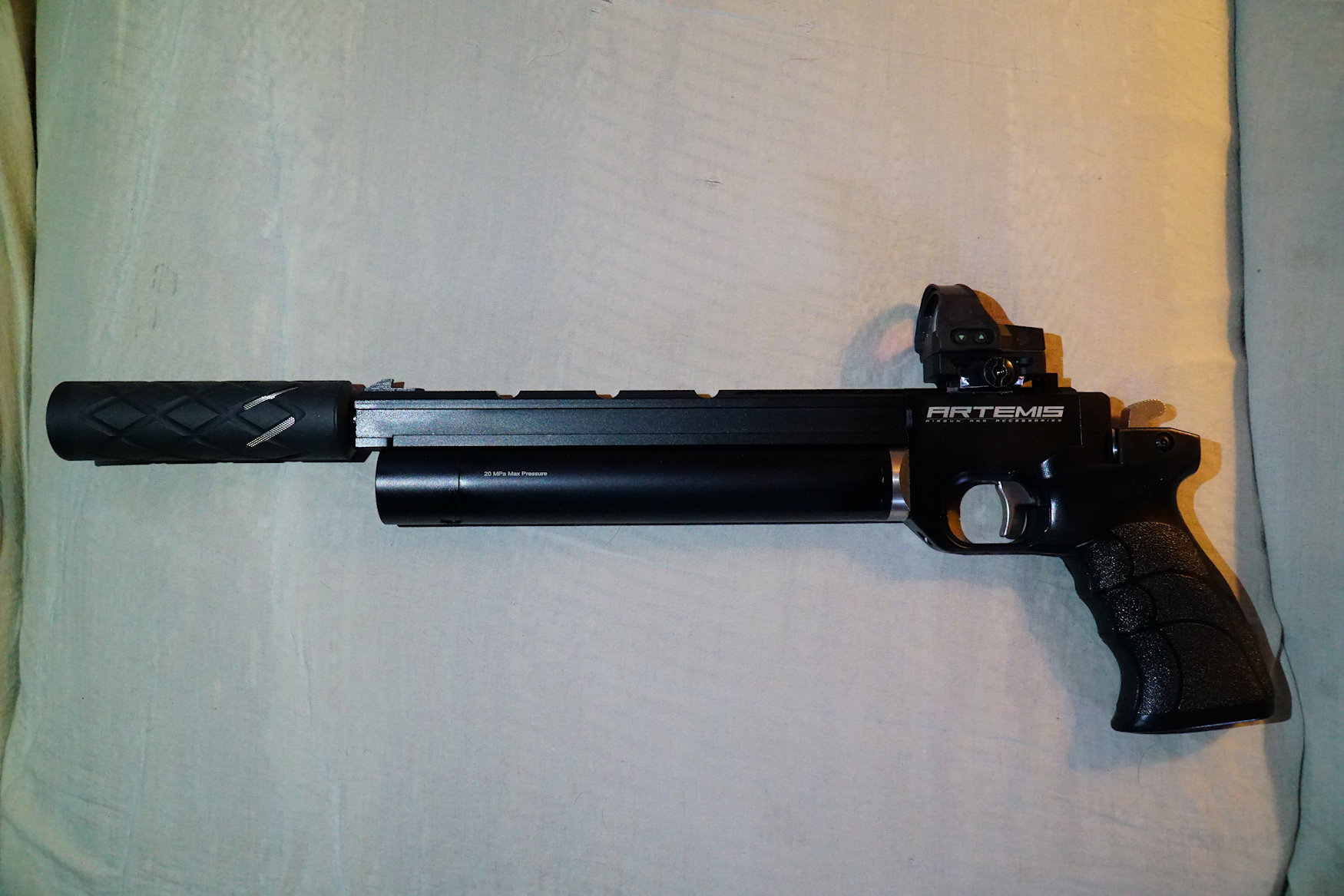

Adding a picatinny rail adapter to a 11 mm rail raises an already too high sight. It is not necessary. Buy a sight that uses an 11 mm rail to keep the sight line as close as possible to the barrel line. I also use the JSB 15.89 gr pellet. I also mounted a laser to the left side of the shroud for targets less than 15 ft because of the high sight line. I tried many different sights and nothing is better than a good reflex sight.
On edit, I also fitted a DannyFL Koi Mod. It works well and because of the small diameter, it does not interfere with the laser.
There are hundreds of different reflex sights that are available. I bought mine from AliExpress and it was really cheap. it is compatible to both 11 mm and 20 mm rails. It has both red and green dots in 5 levels of intensity. Also from AliExpress are the lasers. You may note there is milled dovetail on the left side of the PP700SA's shroud. I bought AliExpress's cheap laser and milled off the rail mount modifying that aluminum block to match that dovetail. This allows the beam to exist about 1/2" left of the barrel centerline. The beam was then adjusted dead parallel to the barrel. This is very useful for fast and close shots without using holdunder caused by the high sightline of the reflex sight.There is a thread where I explained this in the archives. Since you are new to the PP700SA, I also use a 22 cal pellet tube that holds 19 pellets to load pellets in the breech. It works well and is quick.
