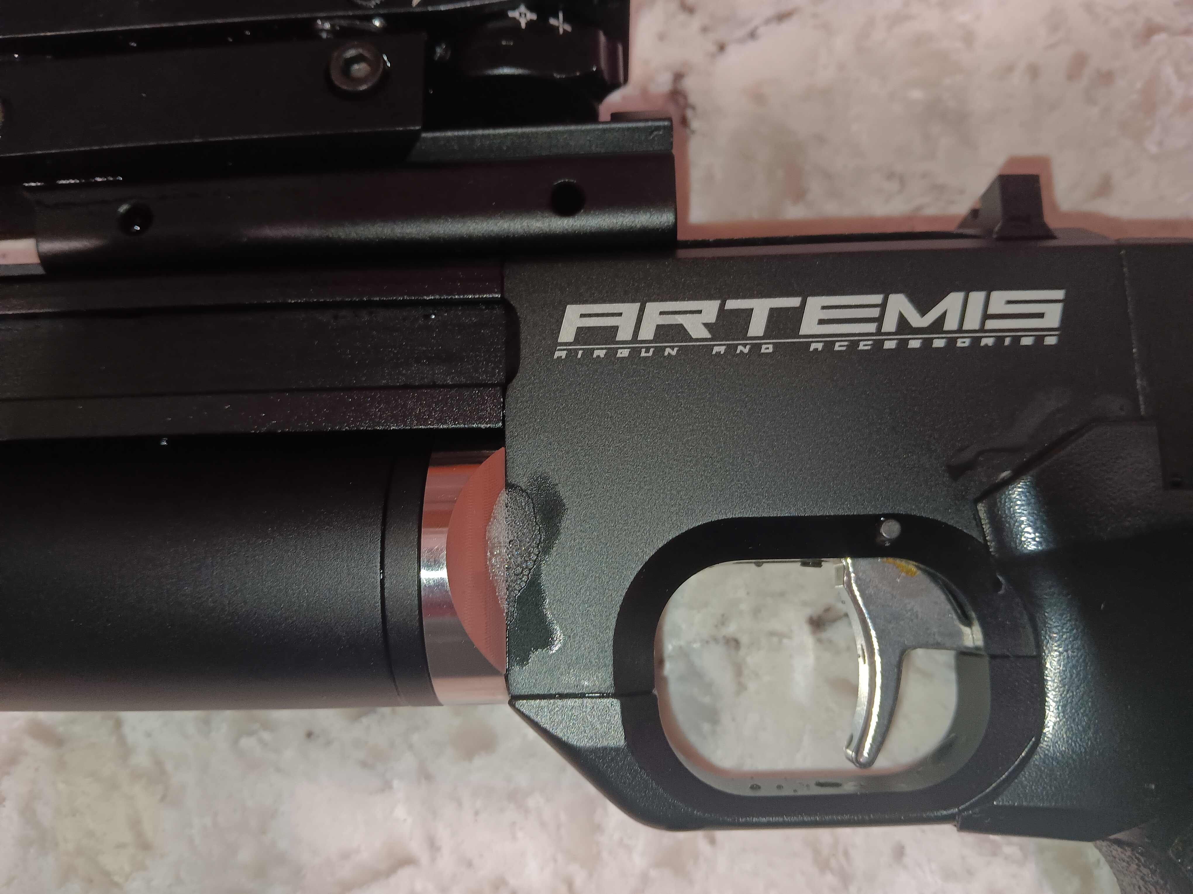

Finally got to look for leak. Looks like between the gun and air tube. See bubbles?

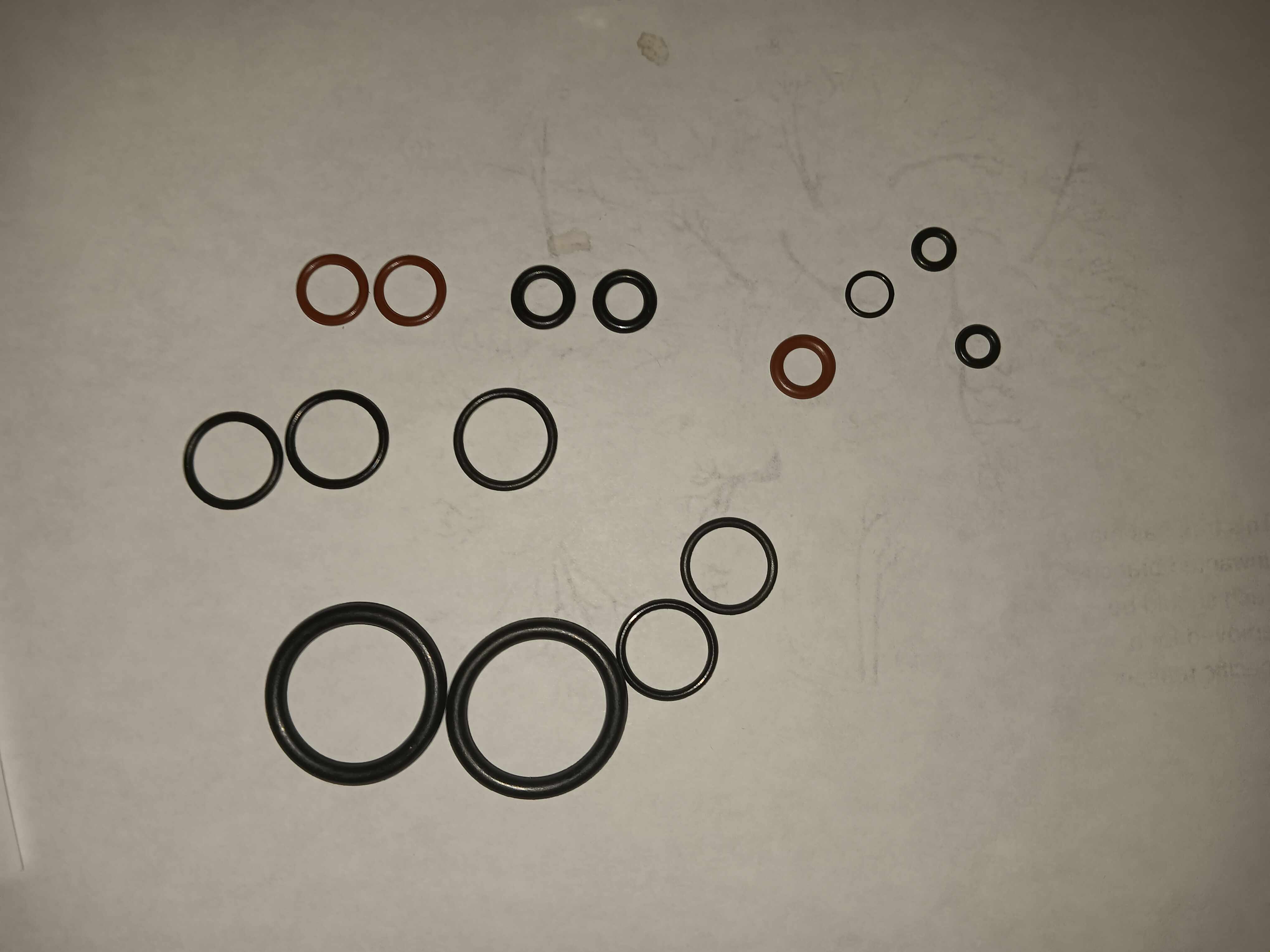

These are the seals I have that came with the pistol.
Thank you for making the water test. This is a factory problem. The cause is an under size "O" ring. I created a thread on this issue a couple of years ago. The Band-Aid is a gasket like MrP said, but the fault is ITEM number 34 part number M10-054. The parts diagram says it should be an "O" ring 5mm ID x 1.5mm thick. It does not seal well because it is slightly too small. I tried a 5mm x 2mm and it shears on installing it, but a 4.5mm x 2.0 NPR70 works perfectly. Be sure to use a little silicone grease on the ring before assembling it. DO NOT disassemble the regulator. Just degas the tank and unscrew the tube. Always use silicone grease on all your "O" rings.

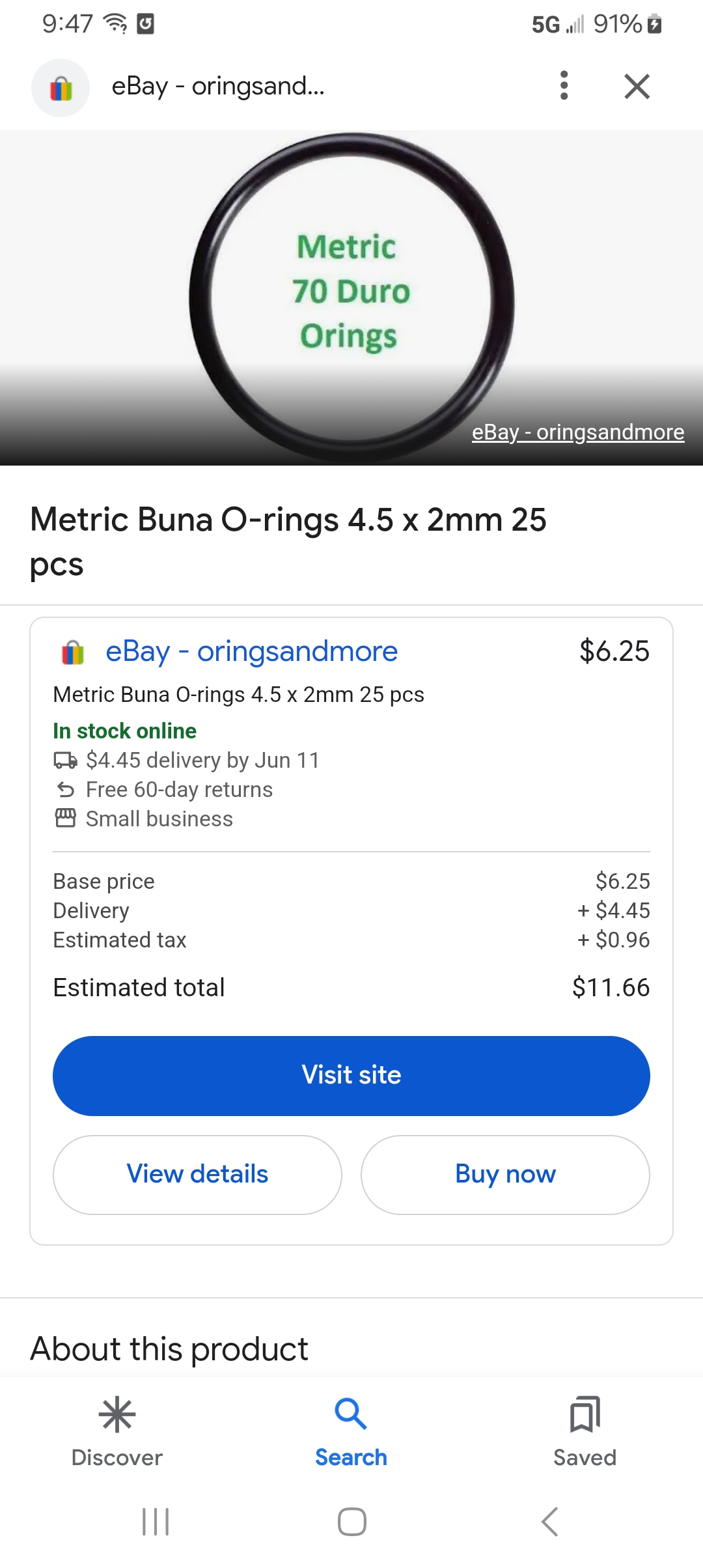

You'll get 2x that quantity at the same price, and better quality from here
Yes that is the size you need, but it is always advisable whenever you acquire a new air gun to order at least 10 of every size of "O" ring or seal that the gun uses and just put them on the shelf labeled by both size and part number because they are cheap and they are a consumable. If you shoot air guns you will be consuming "O" rings. That way, you should never have wait for a replacement when you need one.
