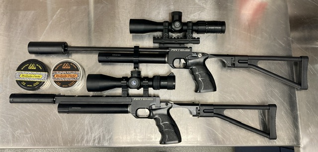

Mine is not pellet fussy at all. It was so good I never even thought of polishing it. Mine has a Altros regulator in it currently.
I have the most time using the 22 barrel.

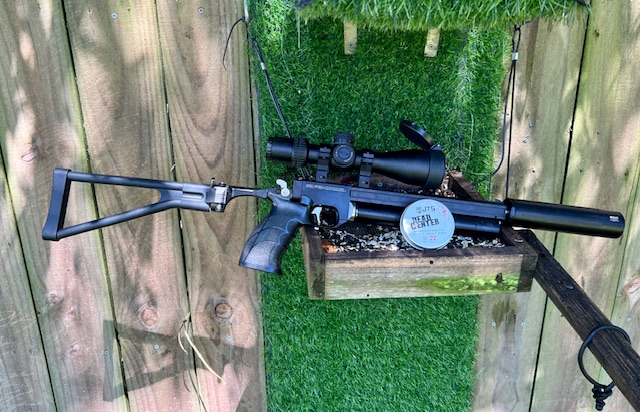

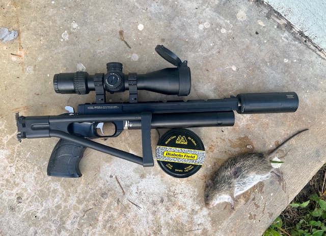

22 is the Air Arms 16 gr with the Hades a close second. It also likes the JTS 16 gr. All of them usually around 15 fpe
My 177 barrel likes the 8.4 and 10.3 JSB variety, it doesn’t care the brand on the label. It’s currently shooting the 8.4gr stellar at 10.5 fpe.

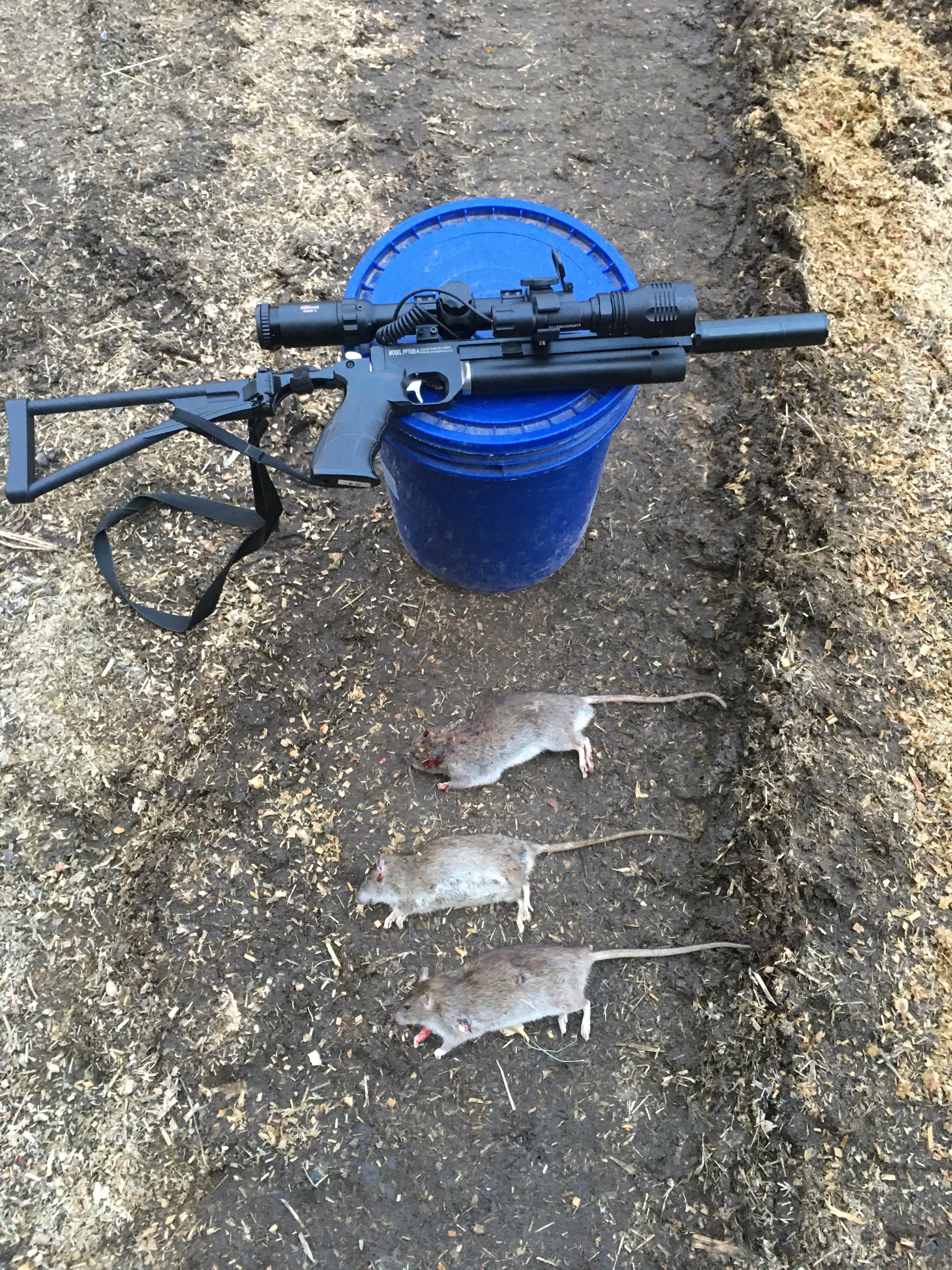

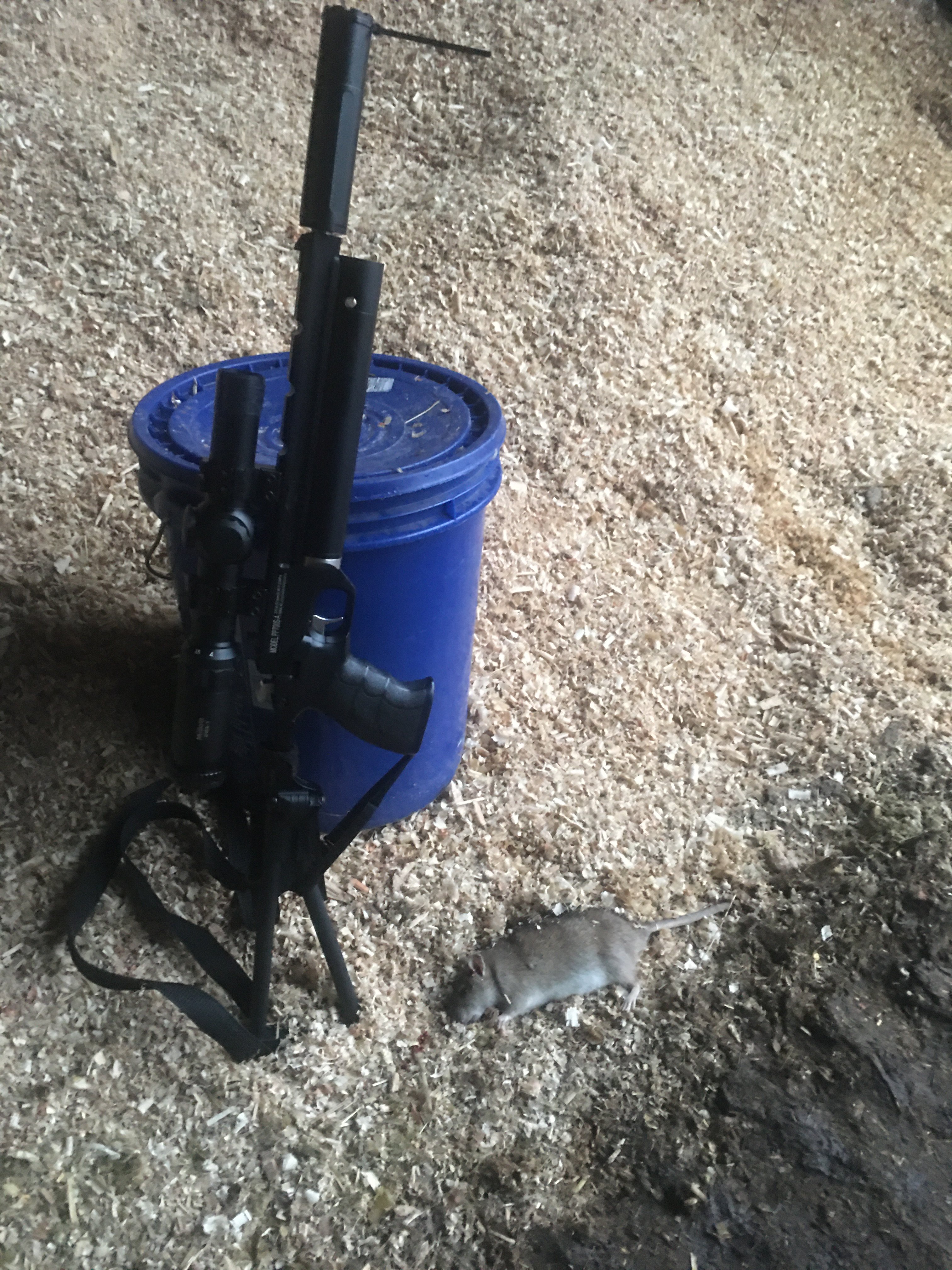

Mine has been a workhorse as a carbine. It is no safe queen. My 25 cal PP700 is currently out of commission.
