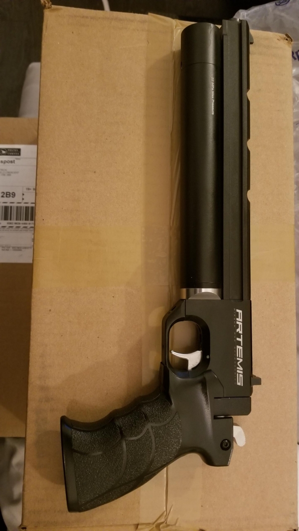

Aesthetics: 4 / 5 The Artemis is one of the better looking pistols out there.
GKlKa6zreZ-nkzBykUlk97bSmi_mqvv_wue6KbeV2Ny43oS_B7LsVj4bRNW3VxBpCg2y4OV6-3WXj65L5HwW4BNyxGVT9B_XP2qdSu9w_QS00riD7qu2x_AibchsWBqTh5gJ_abf
Fit and Finish: 2 / 5 The pistol has several blemishes. The blemishes had been touched up before I received the pistol. This doesn’t bother me in the slightest as I’ve added a few scuffs myself that I’ve needed to touch up as the gun has gained experience in the field. Aside from a cheap feeling plastic grip, the materials of the gun feel quality.

Trigger: 3 / 5 The trigger is adjustable and came to me very stiff and with a lot of creep. I was able to adjust the first stage to my personal preference (short) and remove the second stage creep by tweaking the adjustment screws. The trigger was still way too stiff for my liking. I was able to easily take the trigger mechanism apart using this YouTube video:
https://www.youtube.com/watch?v=Y2C_dSnCHZQ
and replace the two seer springs with lighter ones I had left over from a project on another gun. The result is a trigger I am proud of.
Efficiency: 4 / 5 This is a great pistol to pair up with a cheap $40 hand pump from ebay. The cylinder can be filled from totally empty to 200 BAR with only 85 pumps! If tuned to 10 FPE, the pistol uses a hair more than 2 BAR of air per shot. It takes roughly one pump for each shot to fill. It becomes less efficient as the power is increased, but maintains good efficiency for the power output it gives with it’s short barrel.
Reliability/Maintenance: 5 / 5 I’ve had my pistol for nearly 6 months and have had no problems with reliability. I’m confident that I’ll be able to fix any leak that does eventually appear on my own with the extra o-rings provided with gun. The gun is very easy to take apart and work on. My compliments to the engineers at SPA for designing a simple yet highly adjustable gun.

Unique Features: +1 Adjustability. I still find it hard to believe that SPA has been able to make a $230 pistol with an externally adjustable regulator, hammer spring adjustment, transfer port adjustment and adjustable 2 stage trigger. These features are often not found on rifles costing $1,000+. In fact, I prefer the Artemis pp700sa to the Edgun Leshiy.
Overall impression:
Of all the PCP guns I’ve owned, the Artemis pp700sa pistol is the best value. It is a simple pistol to work on and get experience with PCPs with. It allows for the owner to tune it for a variety of power settings. There are many modifications that can be done to the pistol. I honestly believe it has been the wisest PCP purchase I’ve made to date.
