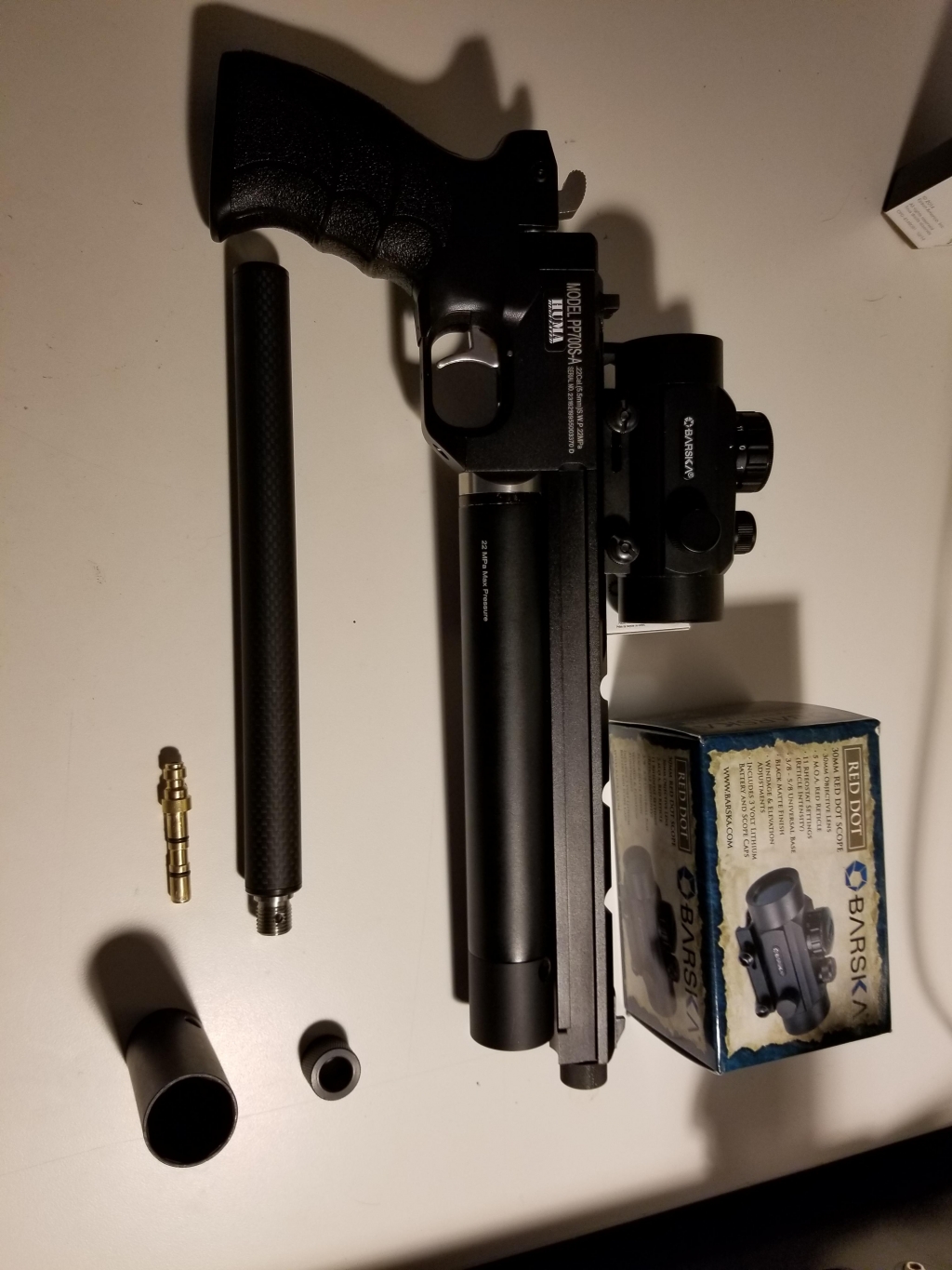

Evening, I picked up a PP700SA used a week ago, A bit about PP700SA. Came with Huma regulator, JSAR breach block, extra carbon fiber barrel with DonnyFL adapter.
Filled it up and while it shot good there was a leak that would drain the tank in an hour and it did not sound right. So did a break down, first off you can see tool marks on tank back were they screwed off before apparently to install regulator. Went thru changed all orings set huma, then I removed the constant valve as they call it. I was well surprised all of the Belleville washers were rusted along with rust on the valve stem and nut. The gun was directly imported in March from manufacture.
Short of it is replaced the Belleville washers, cleaned valve assembly, set reg, changed o-rings, set up hammer spring. Now she shoots ok have not had a chance to chrony but it sounds much better than before. But I am still plagued with a slow leak, albeit it is taking about 2 hours now to leak down. All mating surfaces are good, the pistol fires fine just cant stop that slow leak.

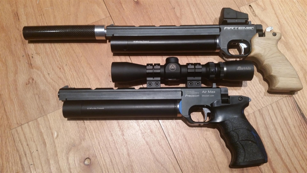

I have two of these, one from Krale, one from Mrodair.
Break it down again and check the o-ring surface inside the breech. My breech was all buggered up. Got a hone from amazon and honed it, now it'll hold air for many months. Still not perfect, but a lot better than the gusher that arrived from mrodair.
Got Huma regs for mine too. And the Unlimited Engineering guided breech block.
LDC & adaptor from David.
They work pretty good.
I did it according to Huma's instructions. No probs really. They do leak a little, by that I mean that if many months go by between fills they will be low on air. Nothing to really worry about, but both do leak a little. Not sure if this is huma related or just the nature of the beast.
My disappointment in them is just their nature, single shot, long and heavy, low quality. A friend has the Ataman AP16 and I really like it, but that's a $1k gun too. Sigh, get what you pay for I guess. My PP700sa pistols all have many times what the gun costs invested and that doesn't account for tunes or my own time. The Ataman shoots well right out of the box.

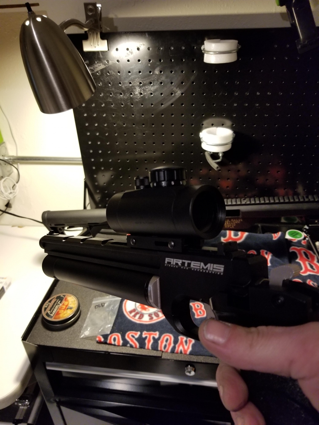

I agree I bought mine used but unfortunately the mod they got into and did not complete and things were way out of wack. Getting them to a state were I can start getting numbers and making adjustments. Thank you for verify mmahoney on the air tank setup I will give it a try. I replaced all the friggin o-rings checked and rechecked surfaces, hoping this final setup will resolve my slow leak, Initially would drop in a an hour then got it down to 2 hours, then I managed to keep 100bar in it over night it has gone down but it seems to be holding at just above zero, So I am thinking with back oring in causing valve or seal to stay open and piss out air because regulator not venting?.
Mond boggling, spending more than I have into the pistol, but to far to turn back now. Thanks you folks for the insight
